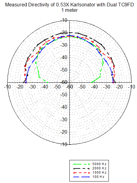

Directivity Measurements of 0.53x K-nator: http://www.diyaudio.com/forums/full-range/239386-karlsonator-3.html#post3569779
It is very even in angular response up to 2 kHz+.

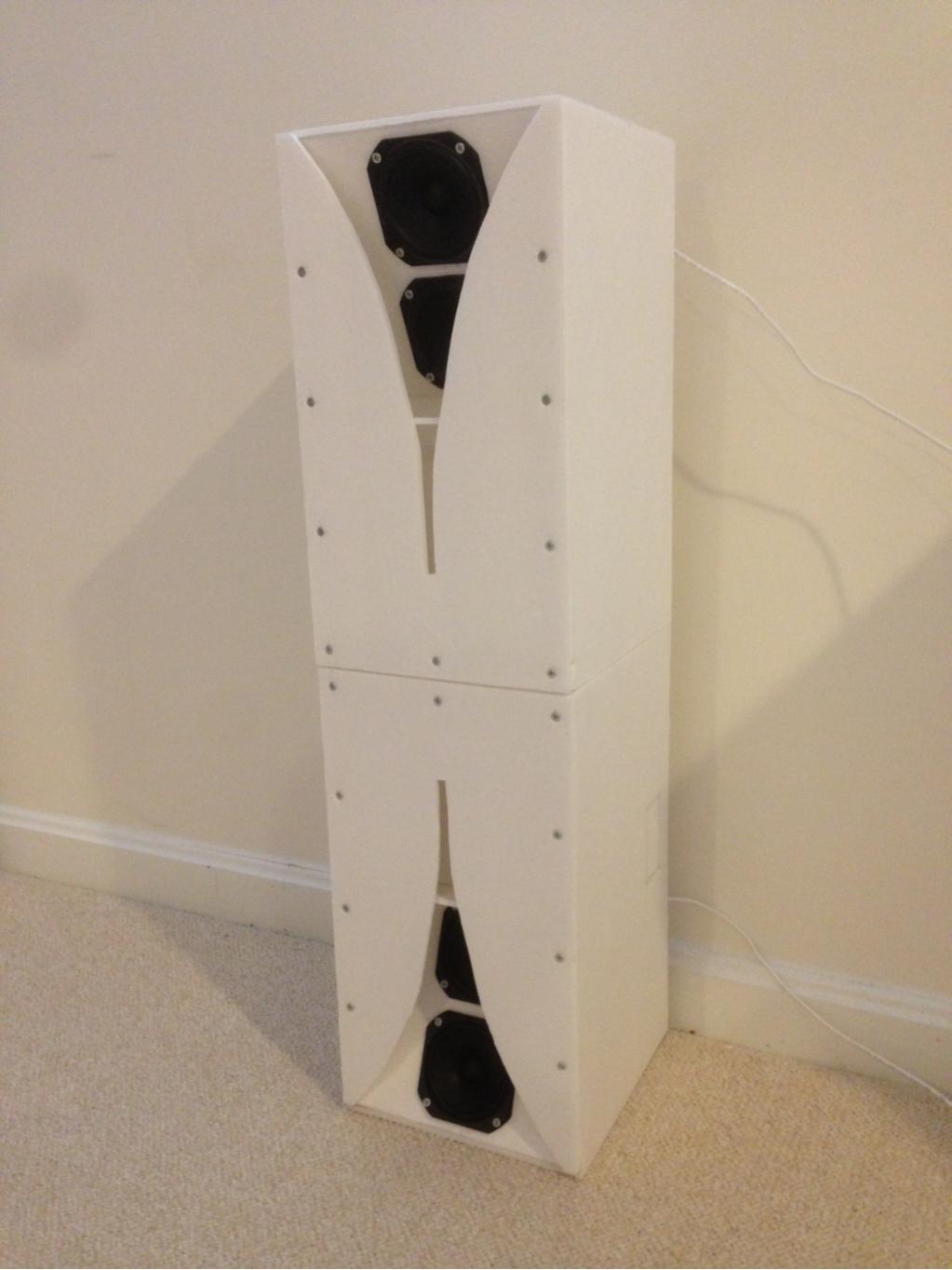

stacked on top one another, makes a great mono tower.
I once arranged both K12's I had like this, with approx. 93dB woofers, but more like 96-97dB with the midbass gain. Turned out I needed even more boundary loading, so got both on the ground side-by-side, in order to keep up with the Fostex FF125K I had in a large midrange front-horn at the time.

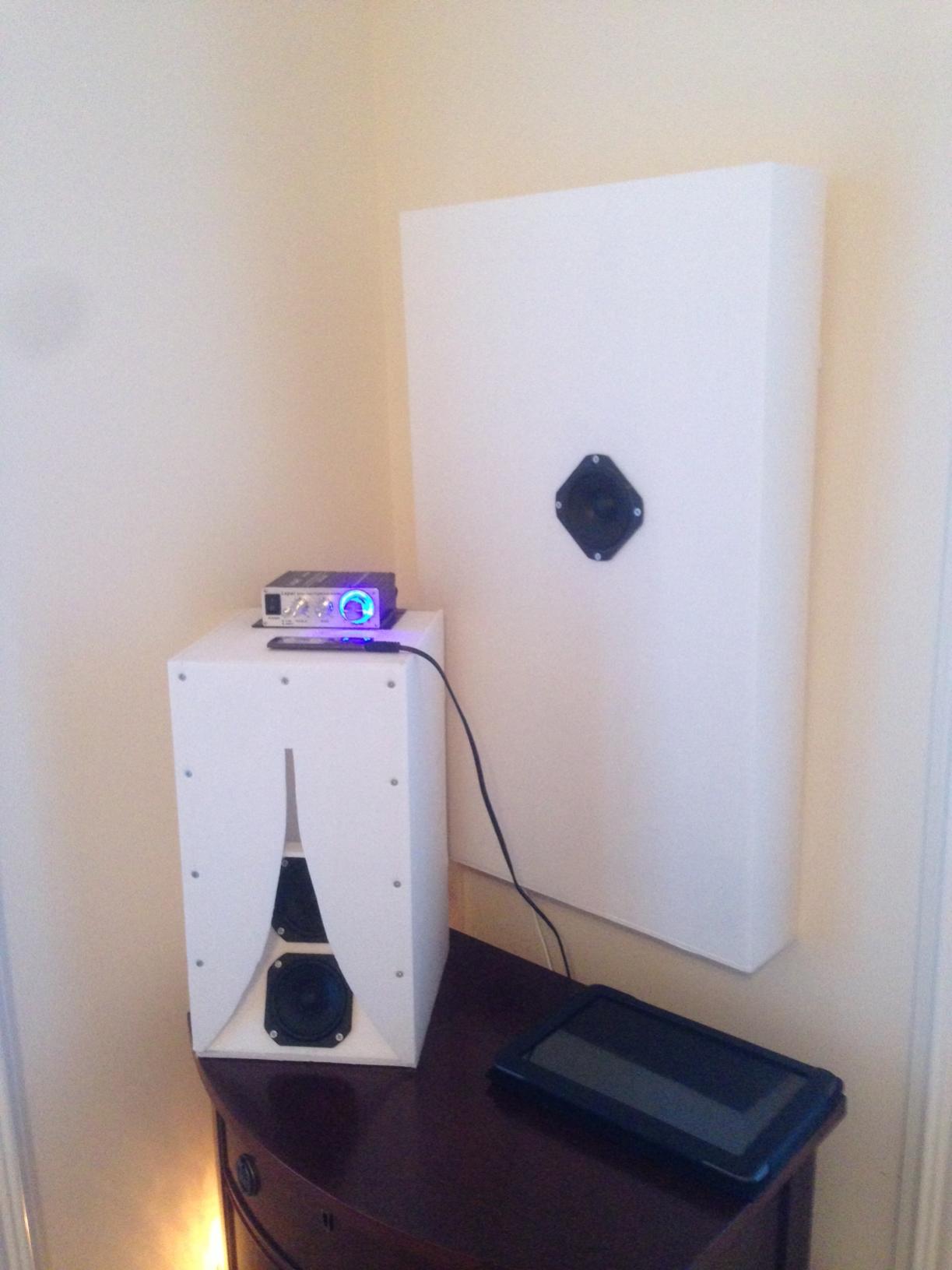

Mini K'nator as Mono Radio/MP3 Speaker
I tried this in various rooms in the house today. Works great in kitchen, kids room, or during home improvement projects. When you need good clean background music, stereo is not always desired. Here it is with a Lepai and iPod nano next to one of my FIB's for size comparison.

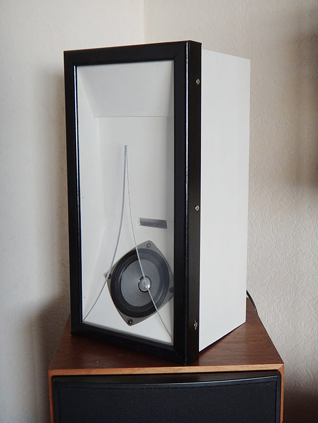

Hello XRK971
Have you plaid them with big orchestra?
I am asking because I made a pair of scaled XK4, they paly beautifully about anything but struggle on big bands.
I thought it could have been due to their small size but my Rogers LS3/5A, which are smaller are better on this regard.
![XK4-copie1.jpg](/community/proxy.php?image=http%3A%2F%2Fsinwen.free.fr%2FHIFI%2FXK4-copie1.jpg&hash=f7e132f62f851a95bf3c380b93d9988a)
hi Toopy - did you see the Basher's K12s? - he's happy as the transient response exceeds what a BR can do. Your LS3 5A with tight sealed cabinet probably handles the low end better than the rather large vented K
