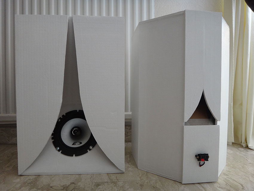

For the Karlsonator I have a pair of car speakers..... I know....I know ..... but I placed them into one of my "production" :) a mix of Fulmer and Karlson, sized over approximation..... and just to add insult to injury.....made of cardboard.
Here they are :
and they sound lovely for the amount of R&D I put in.
So I am proposing to send you the drawings of these so you could do a few sim and determine back & front volume etc.... let me know.
But they aren't easy to built.

Interesting. What is a Fulmer? For car audio drivers do you have TS params otherwise cannot model unless you propose using with other drivers. They look great even made of cardboard. :)

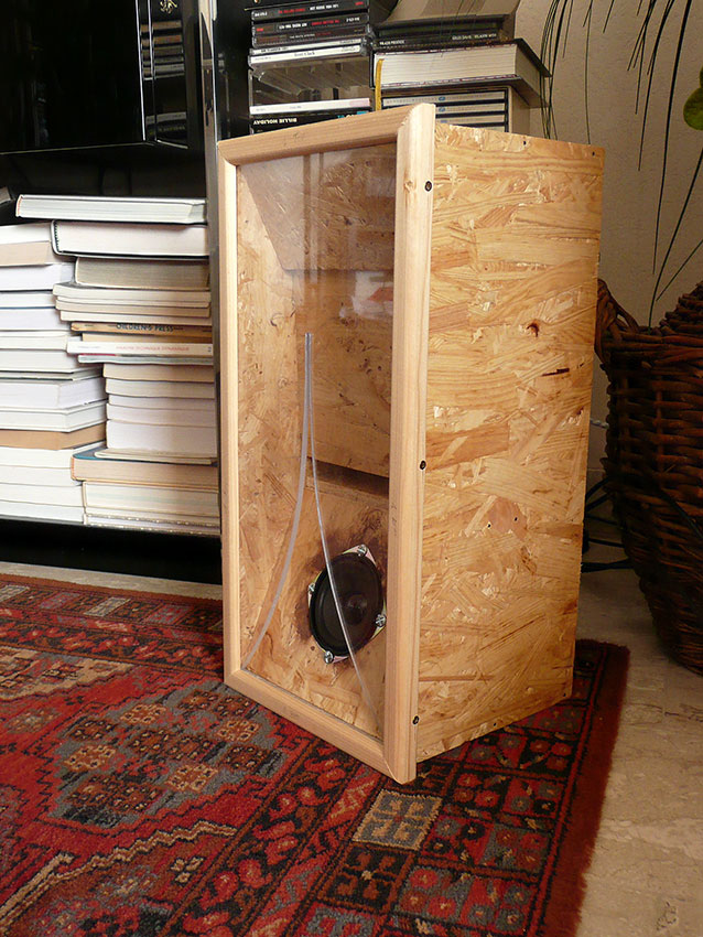

I never knew that OSB could ever look that good :D

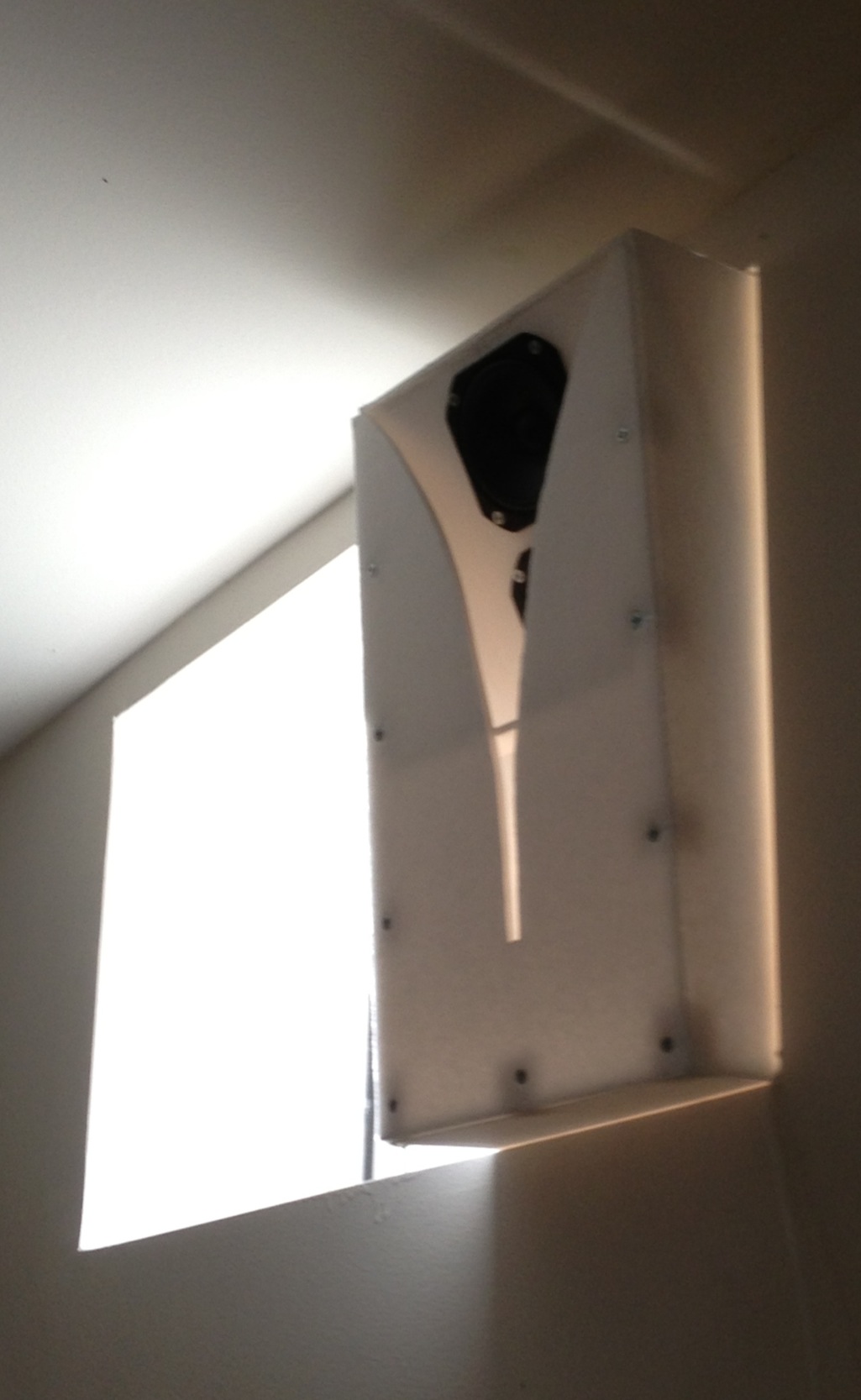

Mini K'nator as Ceiling Mount
It turns out that the cavity formed by the basement windows is exactly tall enough for me to fit the mini K'nator inside. I needed to get the speakers off the floor to keep young fingers from poking holes in the driver cones. Flipped upside down, they can still ceiling load for excellent bass and they carry farther now. Sounds very good and perfect for a rec room party. The translucent nature of foam core makes them very neat looking when backlit. Not too many other speakers look like this when illuminated. I should put color changing LED's inside one of these days...
Is your basement becoming a night-club? :D Good idea to fully use the properties of the translucent material.

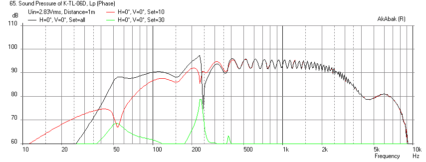

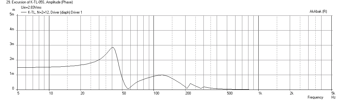

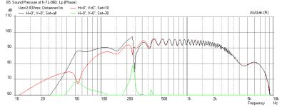

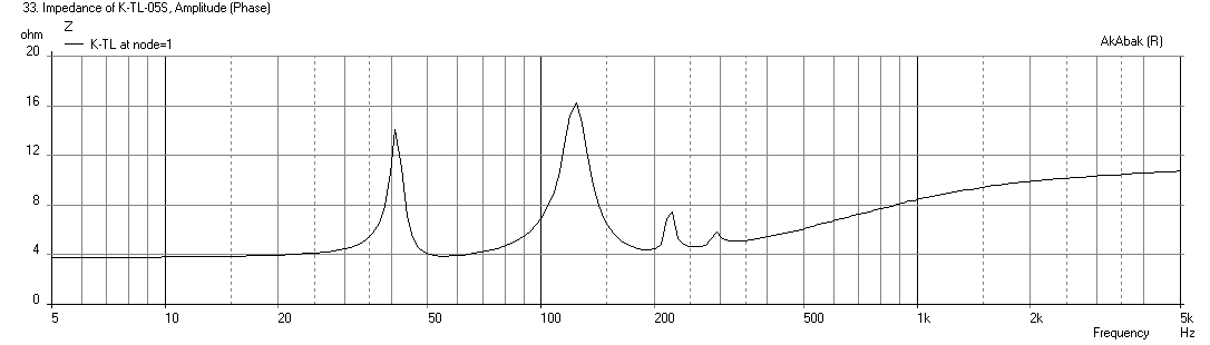

Karsonator with SXE-1725S
Toppy,
Your driver works quite nicely in a Karsonator scaled to 9/15 in height and depth and scaled by 10/15 in width to get some more Vb. The vent is then scaled by an additional 2.2X after the other scalings are done. What results is a speaker that reach 40 Hz and has a nice response once BSC is added as it is kind of hot in upper bass/lower mid range. I used a 1.2 mH coil (assume 0.2 ohm inherent resistance) and 5 ohm resistor in parallel leading to positive terminal. First plot is freq response, second is impedance, third is cone displacement. Btw, I figured out how to add damping (stuffing) to AkAbak and this sim has it so a lot of fine hash and peaks is smoothed out.
Good luck on it, I hope you try it.

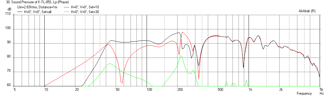

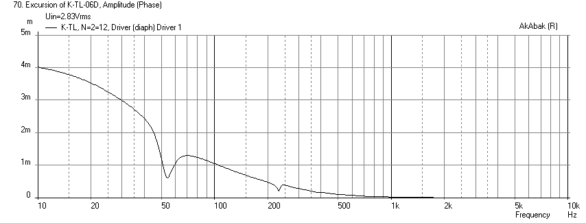

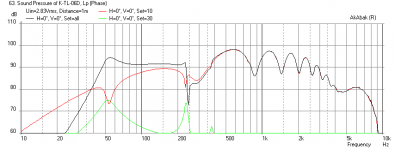

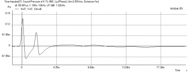

Mini Karlsonator with FE126EN
Nelson,
Here is the simulation of the mini Karlsonator with the FE126EN. The scaling dimensions that I arrived at are a little different due to the low Qts nature of this driver. It probably is not the ideal cabinet for this driver in any event but here is what I came up with. Length scaling is 0.5X, width and depth scaling is 0.43X, and then scale the vent width by 2X (after the length scaling). The FE126EN has such a hot rising response and there is not enough bass gain with this box (compared to a BLH) that I had to tame the upper freq with a 1.2mH//8 ohm resistor for a BSC.

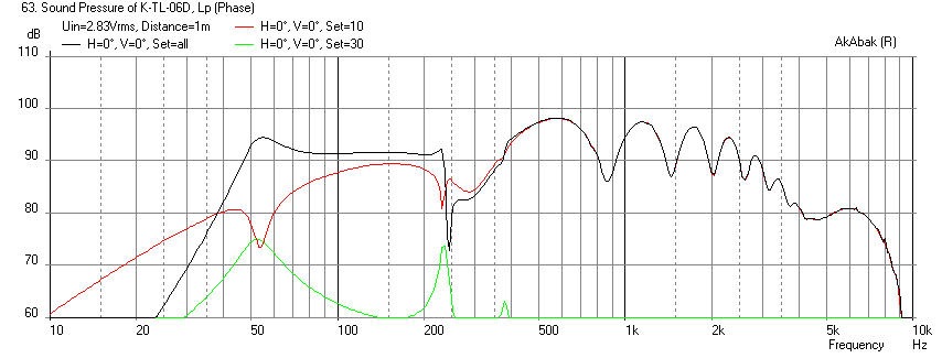

Simulation plots are as follows:
- Freq response with speaker 6 in from back wall mic at 1 m
- Freq response with speaker 60 in from back wall mic at 1 m

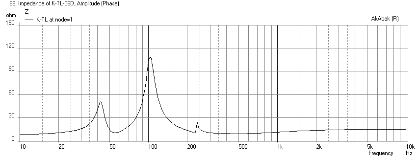

- Impedance
- Driver cone displacement

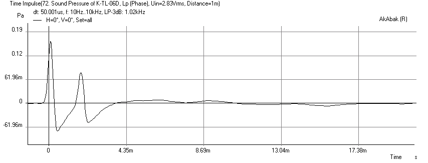

- Impulse response
Observations: fairly deep bass extension to 50 Hz with quite a small cabinet of about 15 in high x 6.6 in wide (barely big enough to fit the driver flange); if you move it away from walls you will get rid of the room suck-out at 250 Hz but at the expense of bass enhancement from wall; the cone movement is a bit too high for the low xmax of this driver (0.3 mm) - but I have heard folks say movement of 1 mm is not bad sounding or damaging; the impulse response is fairly clean since the secondary peak is < 8 ms for minimal group delay.
It might be worth it to try it out in foam core first and see how you like it.
