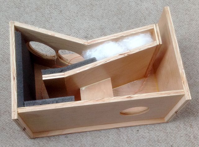

Final scheme for damping was:
Rear chamber: ~10g polyfill in the 'stub', ~3/8" felt blanket on the bottom and one side wall behind the driver, 3/4" foam on the other side. Polyfill behind the driver itself sucked the life out. Lining the sides and bottom was much better.
Front chamber: thin craft felt on the wings right in front of the driver only, and on one side of the front chamber - also in front of the driver only. Adding too much damping to the front makes the sound go subjectively 'dead' fast.

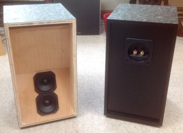

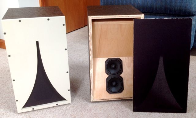

Finally! Finished the dual TC9FD mini-Karlsonators using 0.5” plywood!
The Tolex vinyl from Parts Express is attached with contact cement—the kind that is used for bonding Formica to counter tops in kitchens. Needed 5 coats (applied w/ disposable sponges) to get the film thick enough to grab onto the rough surface of the vinyl.
Note grill cloth attached (again with contact cement) to the inside K-slot; run out to the edges so that the cloth acts as the gasket. Screw heads will get dabs of paint to make them less painfully obvious.
I also added a thin fiber batting material to the inside of the K-slot. Without this, there was a slight hollow sound, which I assume was due to internal reflections of mid- to high freqs from the front of the drivers bouncing around in the cavity behind the K-slot.
When I built a single mini-K in foam core (to try out the design), I wired the drivers in parallel for 4 ohms. One of the amps I intend to pair these with isn’t rated for 4 ohm loads. So I tried wiring these in series for 16 ohms. The result was a dark sound— rolled off in the highs. I assume this results from the voice coil inductances adding. I re-wired them in parallel, then put a 2 ohm mills resistor in series with them to yield 6 ohms. Much better!
So, how do they compare with other speakers I have built? The TC9FDs (at least in this enclosure) are not as articulate as the Fostex drivers I have used. Compared with the FE108eSigma Metronomes: the mini-Ks don’t have quite as much bass extension and they become congested on complex music (like large scale orchestral) at lower volumes. But they are better at filling their intended space at STC’s rehearsal studio than the 108 Mets. And I paid about $40 for the four TC9FDs, while a pair of 108’s will cost you about $225.
Summary: the mini-Ks are inexpensive, fun, & suited to my purpose!
Cheers, Jim
