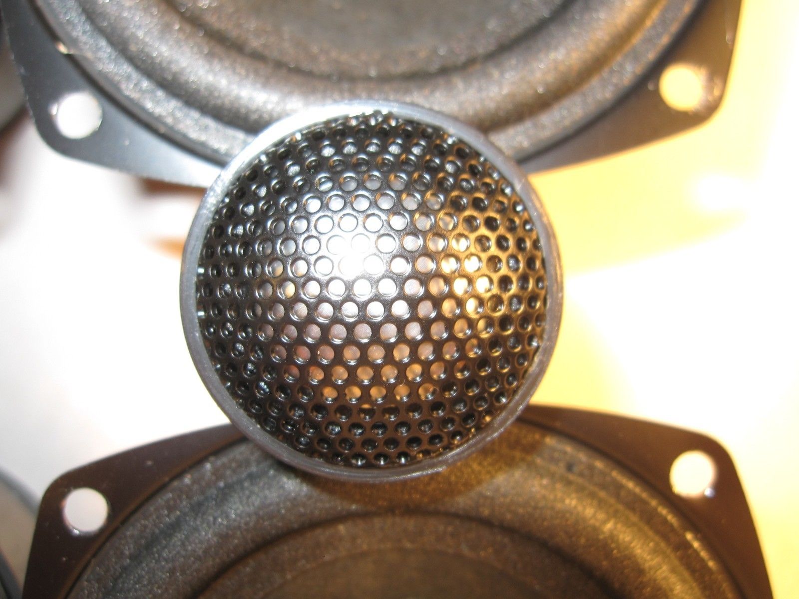

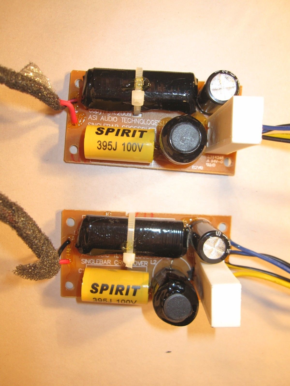

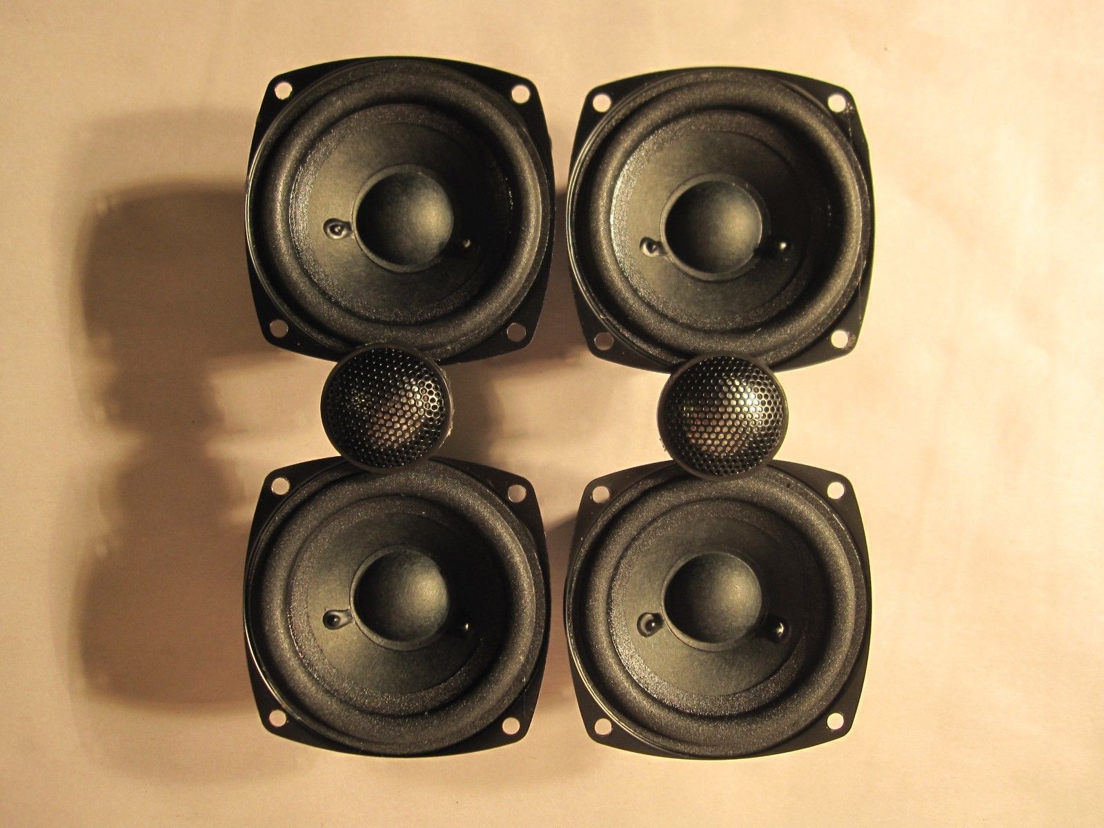

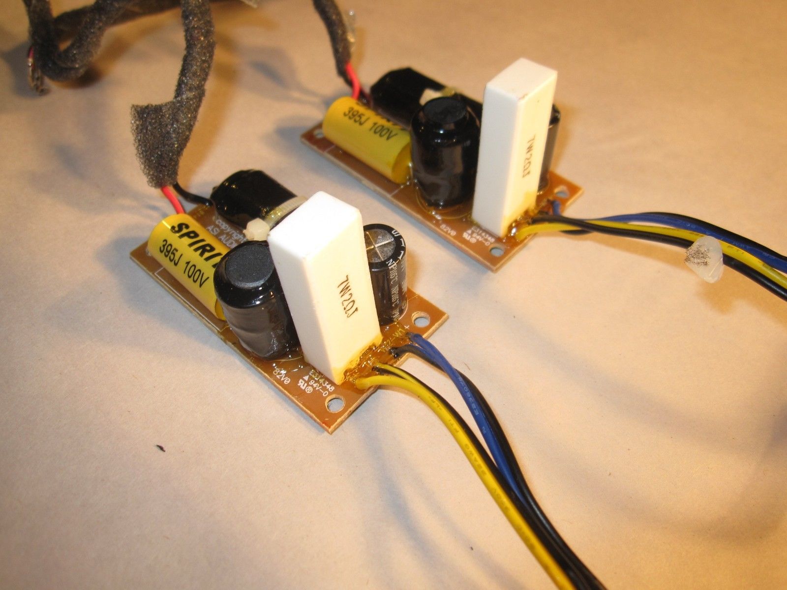

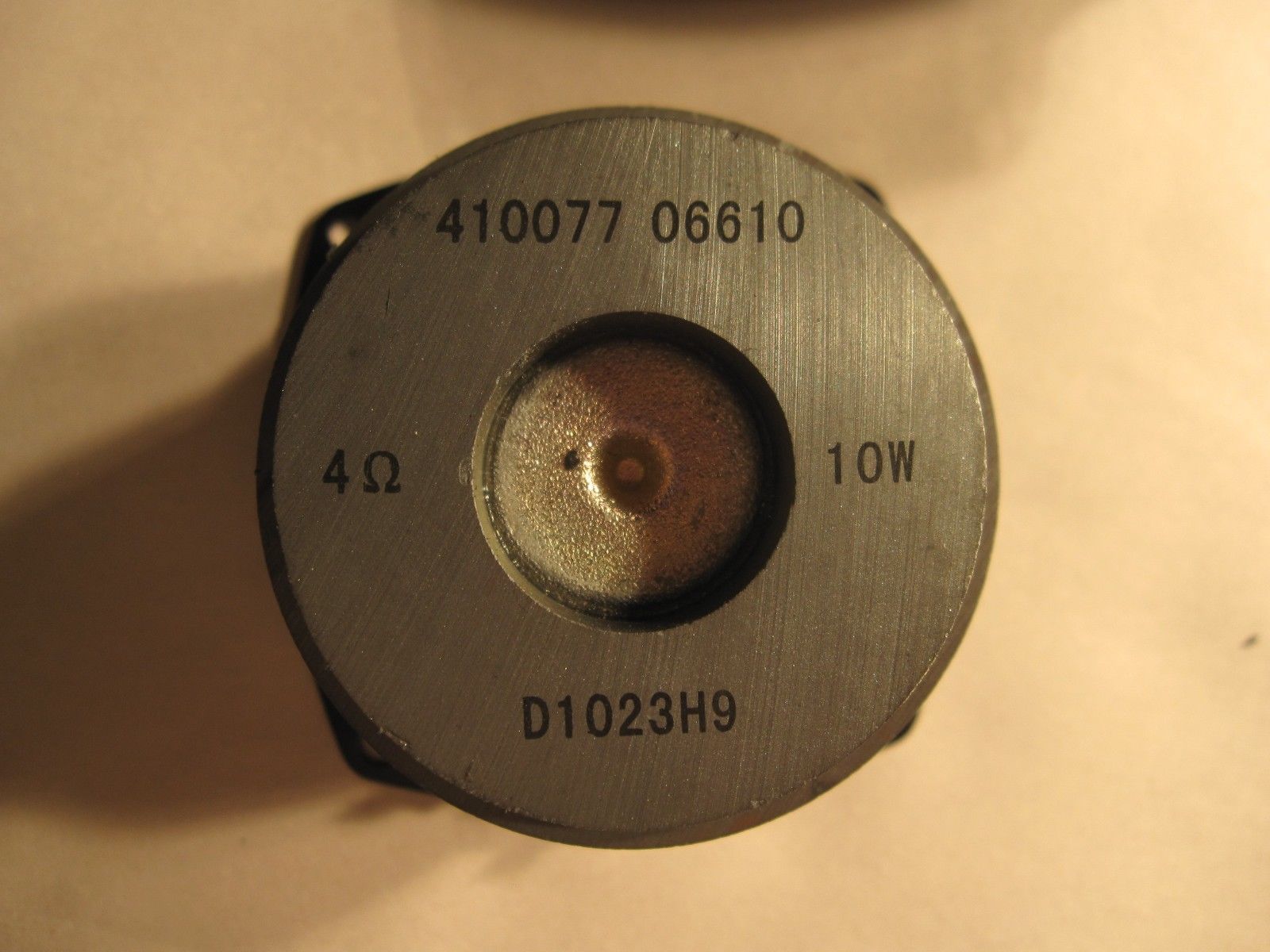

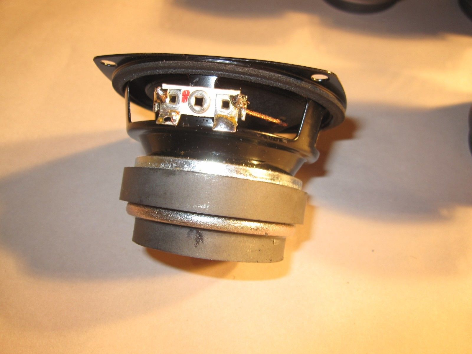

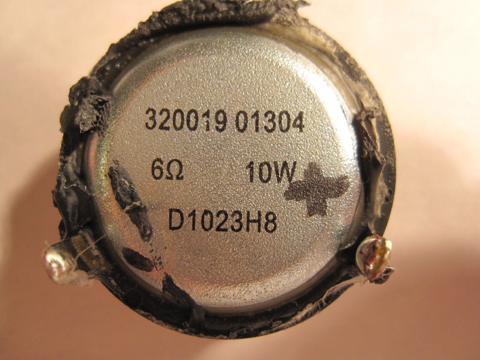

Hi Guys. I've been laying low for a while now but ready to start experimenting again. I got these four mid/woofs and two tweekers plus their crossovers the other day and looking to put them in something. The mid/woofs are 3" and the tweets are 1". I was thinking about a scaled down Karlson but don't know how to size it. I assumed the tweet would go right above the slot. Any thoughts?

Nice find! Those look like powerful motors, probably Qts in 0.4 range. Can you measure the T/S params? I will design a mini Karlsonator for you based on the measured T/S. Did you ever build that 0.4x desktop mini K'nator?
No X, right around that time, personal matters popped up that are just now settled. I haven't sat and listened to my big system since then either. THis project will mark my return!!! These drivers and xovers are from a Visio Sound Bar. I was supprised at the quality actually. I'll get them measured up Sunday and post the results. Do I need to find the Vas as well???
Yes, the Vas is needed - use the added weight (modeling clay or coins of known weight) trick.

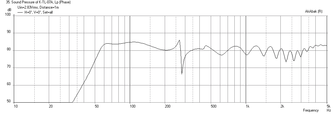

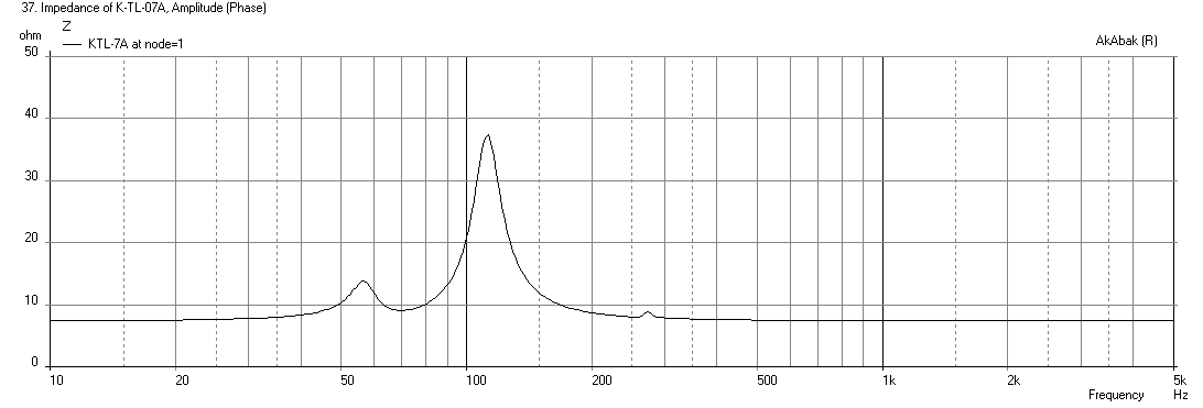

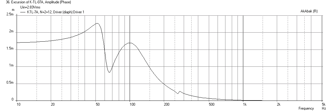

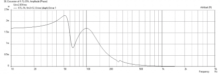

I think that using these as dual drivers (series for 8 ohms) can work well. Just add the stock tweeter at the top above the narrow slot area. Use the supplied XO and you should be golden. There is quite a bit of bass gain so BSC should not be an issue. The sim assumes they are 12 in away from a back wall and sitting on floor. The scaled size is 0.47x tall & deep, 0.35x wide. Make the K-aperture come to a slot as usual (not a cusp). I hope you will build them, they look like they should sound good.
Freq Response (flat to 60 Hz), note ripples from 300Hz on up are floor/wall bounce cancellation effects:
attachment.php
Cone Displacement:
attachment.php
Impedance:
attachment.php
