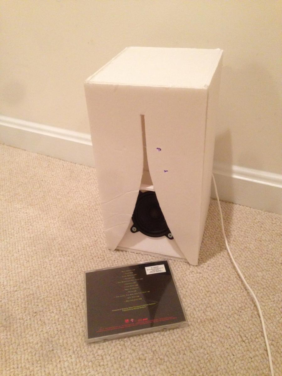

Faital Pro 3FE25 works great in 0.40x
I installed the 3FE25 (ferrite 4-ohm version) into my existing 0.40x Karlsonator. The drivers are almost a perfect match for the cutout left by the Vifa TC9FD. They are actually kind of a tight fit as the magnets are huge - about same dia as cutout.

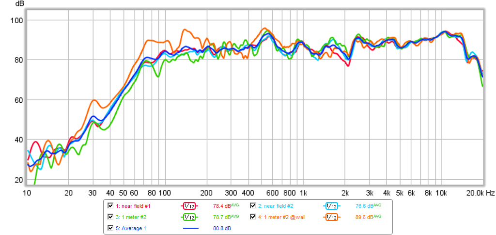

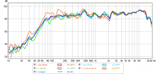

I took some measurements of the frequency response and distortion - they look very good for how small and simple this speaker is.
Here is the frequency response in nearfield and at 1m sitting on a stool 33in above the floor and 4 ft from a back wall, and also included is the 1m response from same position, and 1m response with speaker sitting on floor against the wall:

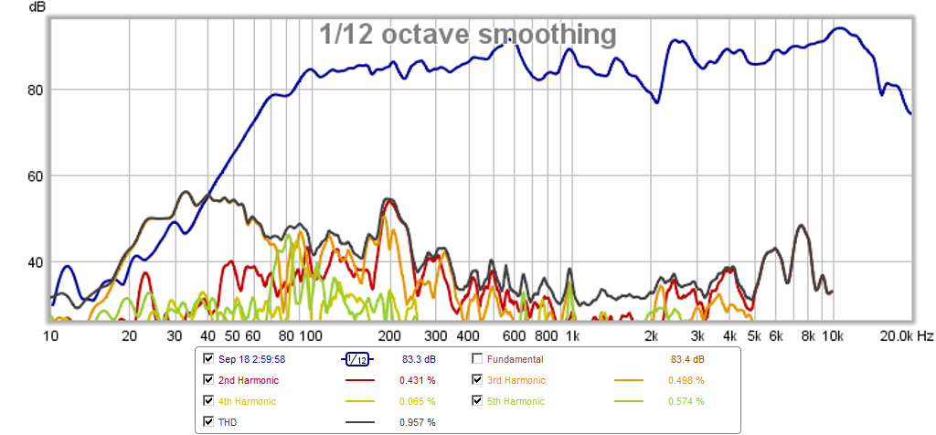

Here is the harmonic distortion, there is a peak at 200Hz caused be foam core cabinet resonance (could use more bracing inside):
How does it sound? I expected it to sound pretty good based on measurement, and it does. Has a little bit of a HF rise compared to Vifa, so may sound a bit bright - but easy to compensate with a little EQ negative HF shelf. They actually sounded amazing for how small and cheap they are. Here is a sound clip... http://www.diyaudio.com/forums/attachments/full-range/439063d1411026705-mini-karlsonator-0-53x-dual-tc9fds-3fe25-karlsonator-0.40x.zip
So in conclusion, for $19 ($7 more than TC9FD) you get +6dB more sensitivity, and a little more "air" on top. Well worth it and I am thinking that this unit could be a drop in replacement for TC9FD on many projects where you want a little more sensitivity.
![439060d1411026705-mini-karlsonator-0-53x-dual-tc9fds-karlsonator-0.40x-3fe25-photo.jpg](https://www.diyaudio.com/forums/attachments/full-range/439060d1411026705-mini-karlsonator-0-53x-dual-tc9fds-karlsonator-0.40x-3fe25-photo.jpg)
