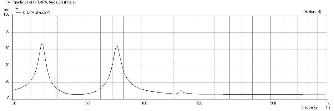

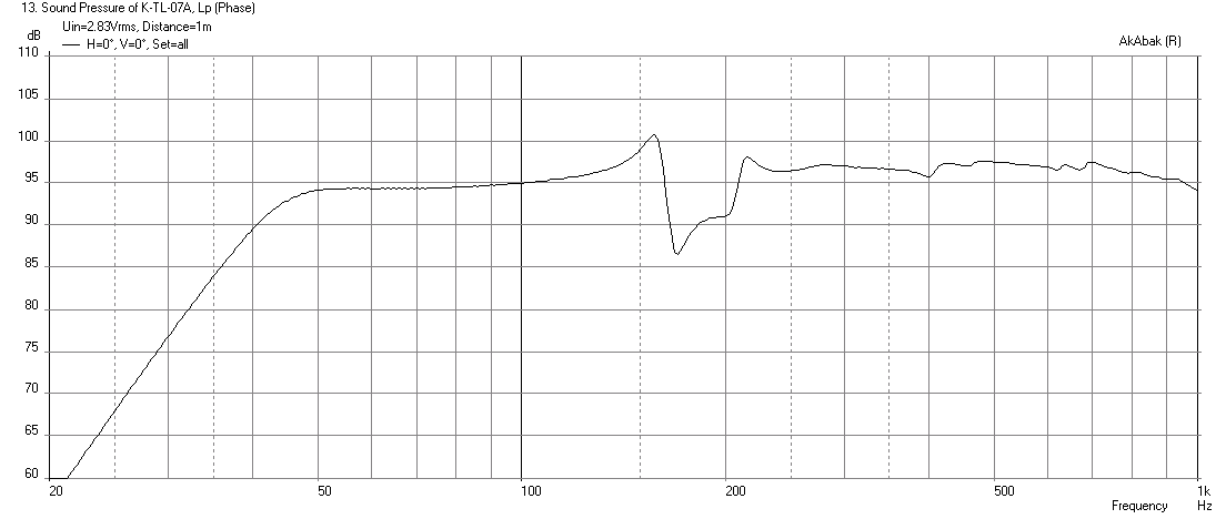

The tuning is not very sensitive to the vent dimensions at the top as it is to the Karlson aperture cusp being open slotted or a converging point. The other major items are overall rear chamber volume (width and depth), and then overall TL length. So removing that bottom panel would really reduce the TL length probably too much. If you want to raise tuning, replace that panel with one half as tall and make the K aperture a slotted one.
But your question of is it worth it to try? I would try it because the sims says it is a perfect match with no alterations needed.
Here is predicted frequency response:
Here is impedance (seems that fb is 45Hz):
