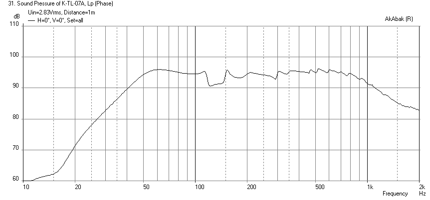

Please help me with the best Karlsonator enclosure size for this speaker:
Def_Driver 'Snake69Fast" |Notes: 12 inch fullrange SPL: 94,587db 30 watt 1mm xmax Qts 0.495
Sd=572.56cm2
fs=31.24
Mms=36.331g
Qms=6.907
Qes=0.534
Re=7.2
BL: 9.810TM
Le=0.6mH
Vas: 259.741
Thank you!

This driver has a very large Vas (soft suspension) that it requires a very large cabinet to get bass. Even though it is a 12in driver, it needs a Karlsonator scaled to 1.33x tall and deep and 1.0x wide in order to perform optimally. If you do that though, you get 94dB sensitivity for the bass down to 50Hz and F3 of 44Hz.
Here is predicted SPL at 2.83v and 1m:
Hmm, let's call that a Mega Karlsonator, not a mini Karlsonator.
I guess we are all assuming that this is for the Gui Sound / HiEnd 12" full range?
While it would be large, I've certainly built larger. By Ultra Fi standards it's not that bad. On the plus side, bigger speakers often have a subjective bigness to the sound quality that is easy to hear but hard to measure. I suspect this would be a speaker that is fun to listen to.

I bet this one is worth building. Any speaker that can generate close to 95dB (after baffle step losses) at 2.83v for 50Hz will sound quite astonishingly impressive.
