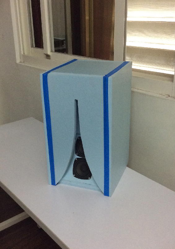

I built a one dual K with two AHE drivers I had laying around.
Build was fine, took a few hours only, as I was using rigid blue foam and hot glue.
But...
My TABAQs are not ready for retirement yet.
The frequency response of the dual AHE K is far from perfect. There's a lot of phase wraps (comb filtering?) around 5kHz, causing the big drop there.
I may revisit this with other drivers later, but as it stands now, this is not enjoyable listening.

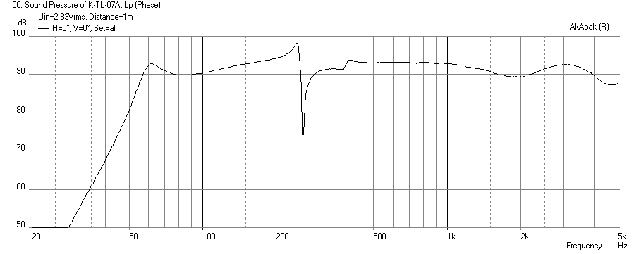

I should have run sims for you before telling you it would work at 0.53x scale. This driver is peculiar and has a real mid-bass hump and 60Hz peaky bass overshoot if used as dual drivers in a 0.53x W x 0.53x H&D. No wonder it doesn't sound right.
Try making the cabinet 0.42x wide (you can take current cabinet and slice off one side then re-center the baffle board. You should get something better behaved like this, but still mod-bass heavy at 300Hz - best if used near a back wall or corner to boost the bass:

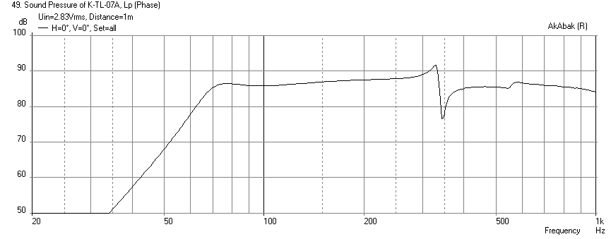

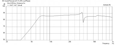

But best performance is actually single driver in a very compact 0.37x (all dimensions) and you get something fairly balanced with 65Hz F3 - you will be surprised by how balanced it sounds - very easy to make:
![581239d1479743838-mini-karlsonator-0-53x-dual-tc9fds-ahe-0.37x.png](https://www.diyaudio.com/forums/attachments/full-range/581239d1479743838-mini-karlsonator-0-53x-dual-tc9fds-ahe-0.37x.png)
One more thing - important to make the Karlson aperture go to a sharp cusp - not a slot. That changes the bass roll-off slope quite a bit.
