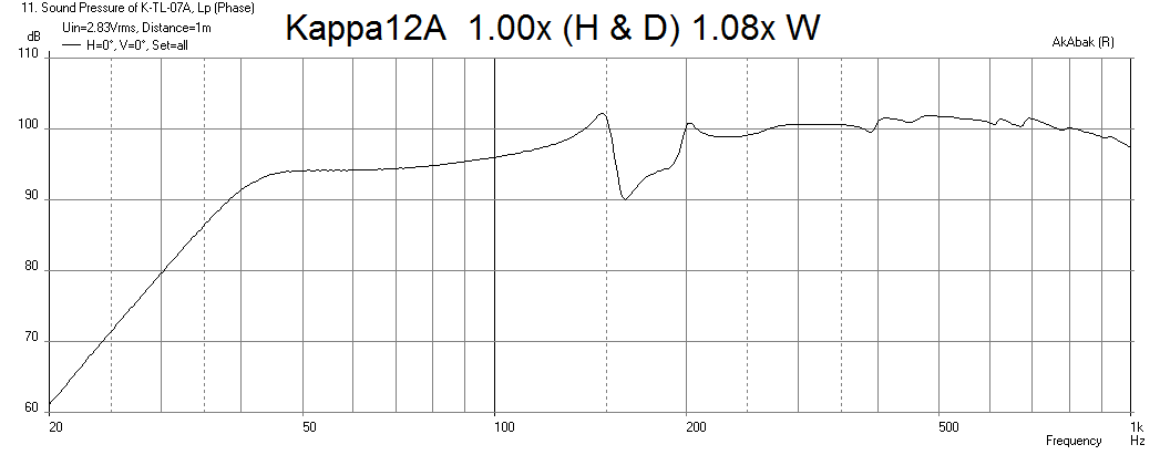

Hi ErikNils:
The Kappa 12A looks pretty nice with simple increase of width scaling by 13/12 or 1.08x in width, with depth and height staying at 1.00x:

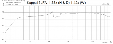

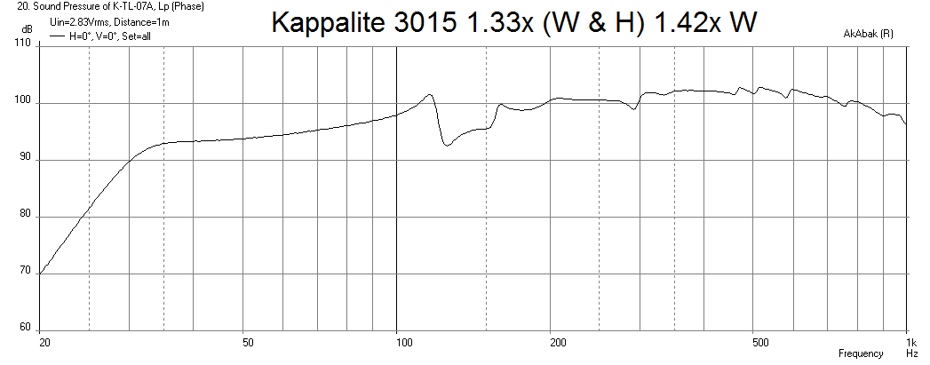

Both the 3015 and 15LFA cab work well with a 1.33x (Height and Depth) and 1.42x (Width) scaled cabinet with a cabinet with a 34Hz tuning.
Here is Kappalite 3015:
![616606d1494961005-mini-karlsonator-0-53x-dual-tc9fds-k7a-kappalite3015-fr-2.83v.png](https://www.diyaudio.com/forums/attachments/full-range/616606d1494961005-mini-karlsonator-0-53x-dual-tc9fds-k7a-kappalite3015-fr-2.83v.png)
Here is Kappa 15LFA:
![616607d1494961005-mini-karlsonator-0-53x-dual-tc9fds-k7a-kappa12lfa-fr-2.83v.png](https://www.diyaudio.com/forums/attachments/full-range/616607d1494961005-mini-karlsonator-0-53x-dual-tc9fds-k7a-kappa12lfa-fr-2.83v.png)
Let me know which one you like and I can run cone excursion and max SPL estimates with a particular high pass filter for you. All these drivers are producing mid 95dB SPL sensitivity (with baffle step losses included with sitting on floor positioning - which is pretty nice sensitivity). The 15in ones are rather large cabinets, but if you have room, that would be some impressive bass.
Thanks for the sims xrk971!
I am a little disappointed by the bass response of the 12 inch. It is on par with the fostex fe206en that I built. I would have expected it to go at least 5Hz lower than the fostex. The 15" sims look very nice but indeed those cabs get pretty big.
