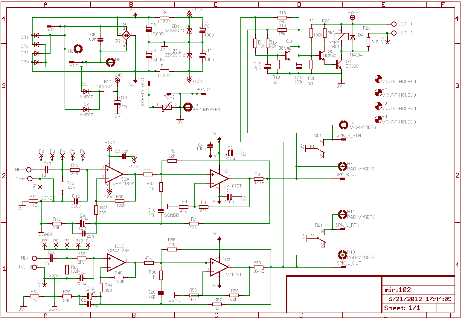

hi siva,
remember me,i tought of just check out your miniref design. siva when you have designed the current pump you have changed the gain of the pump to 2 but mauro designed the current pump to have unity gain so that higher bridge outpu impedance of 500ohm was attainable right?have you checked on that?
then why have you used those 22nf cap in parrel with 220uf ....i know 220uf is for unity DC gain
should that cap come in parrel to 12k res
Hi Vishnu: note that the Miniref is not the same topology as the MyRef, although many ideas have been borrowed from it. The Miniref is actually a nested Jung-topology amp, with both the inner opamp and the GNFB loops being non-inverting voltage-series feedback loops. The Howland current-pump (LM1875) is also non-inverting. The transconductance (I/V gain) of the Howland pump (as shown) is the same as that of the MyRef - this has been done to allow the use of existing MyRef parts without change.
I'm not sure about what you mean by bridge output impedance, but if you mean the output impedance of the Howland current pump, it's pretty high (comparable to the MyRef) and depends largely on the matching of the Howland resistor network (which can be matched to the same accuracy as that of the MyRef).
The 22nF cap is just a HF bypass for the 220uF DC blocking cap. Depending on the quality of the DC blocking cap, its use is optional. If the DC blocking cap is a Black Gate, Elna Cerafine, Panasonic Pureism or Nichicon KZ, you can probably omit the 22nF bypass. For a Panasonic FM, Elna Silmic/RJH/RJJ or similar, you may want to use the 22nF bypass - it's a matter of personal taste.
The 12k gain-setting resistance doesn't need a cap in parallel with it - the compensation schema for a Jung-topology amp is very different from the MyRef, and is provided by a single modified-Deboo integrator, which is the 22pF + 1k network in this schematic. In simulation, it has a fairly comfortable phase-margin of 80 degrees or so, which can be increased further if needed.

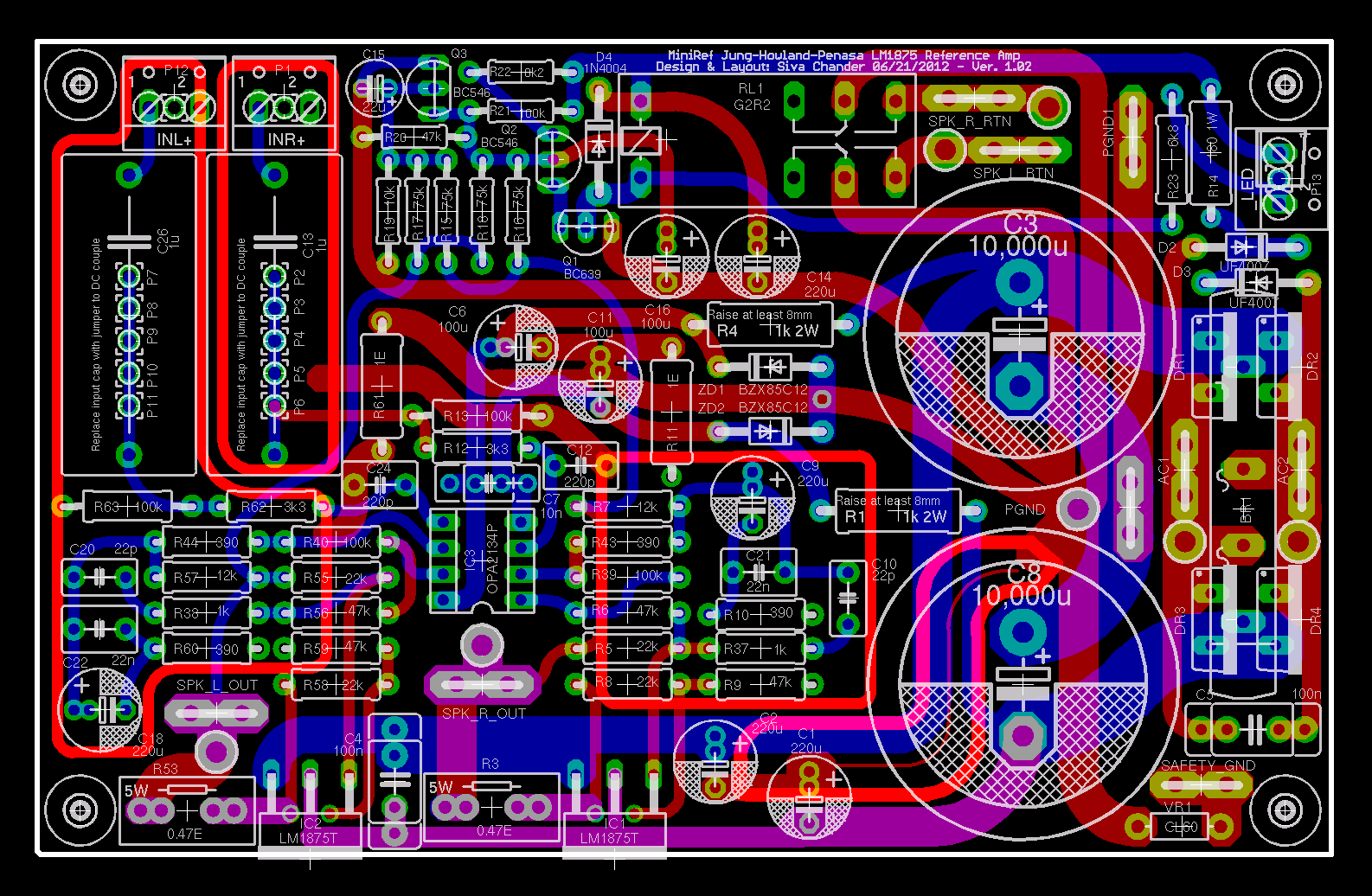

Note that a double-sided PCB with careful layout is mandatory if you want decent sonics. The topology is fairly forgiving with respect to stability, but the parasitics from a point-to-point build can lead to unpredictable sonics.
siva in national datasheet it is specified that the bride output current is given by
(Rf/Ri)*Vin/Rsense,substituting the values of design we get unity gain....soory there i was first refering your first schematic version,
in the datasheet they have also told of the bridge output impedance to be some R/deltaR
i couldnt get it really...please explain if you got it correctly.
Then the 1k+22pf combination ,is it for preventing oscillation at high frequencis?is it possible to raise the cap value to .001uF range and compencate in resistor value because its difficult to get good quality pf values for me

OK, there seems to be some interest, but I don't have the time to order the PCBs and offer a Group Buy. Therefore, I'm posting the Eagle schematics and layout of MiniRef 1.02 here, under the terms of the GNU GPL. They're free to use and modify as long as the original credits are retained on all derivative works. No warranty, express or implied, is offered.
