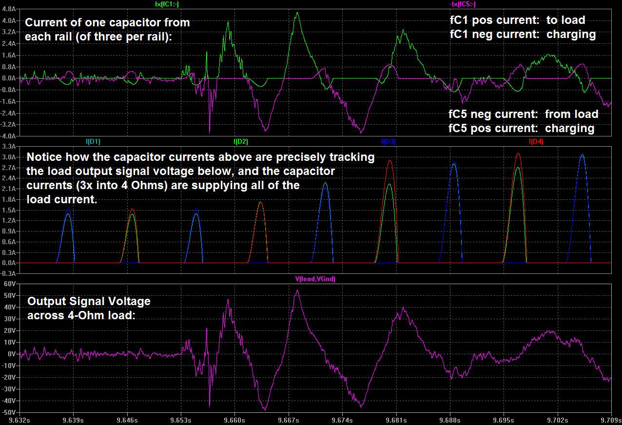

Decoupling is another matter. The decoupling caps can be thought of as a small local power supply, to provide fast-changing transient currents on demand. So they should be as close as possible to the chipamp power pins, to minimize the impedance presented to the pins.
Maybe I should first say that the sound from the speakers is made by current that is almost all coming directly from the power supply and decoupling capacitors, which is modulated by the amplifier. Quite-convincing proof of that is shown in this plot: http://www.diyaudio.com/forums/atta...3-power-supply-resevoir-size-zoom3a_33kuf.jpg , which is part of a post at http://www.diyaudio.com/forums/power-supplies/216409-power-supply-resevoir-size-38.html#post3117390 .
"The rails currents ARE the signal and they come from the capacitors!"
With so many inches of trace between the smaller electros and the chipamp power pins, there is significant inductance (and resistance). There are several unwanted effects from that, all inter-related:
Any demand for a fast transient current change will have to pull the current through that inductance. That can create a significant voltage glitch on the rail, proportional to the rate of change of the current (V = L x di/dt). At the same time, the current's rise time is slowed, and the current is basically delayed, i.e. there is distortion of the commanded transient's amplitude vs time. That will smear the edges of output signal waveforms, and their Fourier components, in the time domain, degrading the soundstage image. Also, the feedback loop needs a very fast response, since it is trying to cancel things like high-frequency harmonic distortions. So that is affected, too. (Most chipamps need to have very low impedance, as seen by the power pins, out to somewhere between 80 kHz and 400 kHz.) Also, the transient currents will now have to travel in a much larger loop. So you also have a much larger antenna, there, than necessary.
Does any of that matter, in this case? I can't say, offhand, of course. But there are simple calculations that can be done, to find out. You can easily calculate the minimum required decoupling capacitance, and, the maximum acceptable inductance and resistance, which will give you the maximum acceptable round-trip distance through the decoupling capacitor connections to the chipamp power and ground decoupling points. Check out the links to my posts with example decoupling capacitor calculations, collected at http://www.diyaudio.com/forums/power-supplies/216409-power-supply-resevoir-size-3.html#post3097232 .

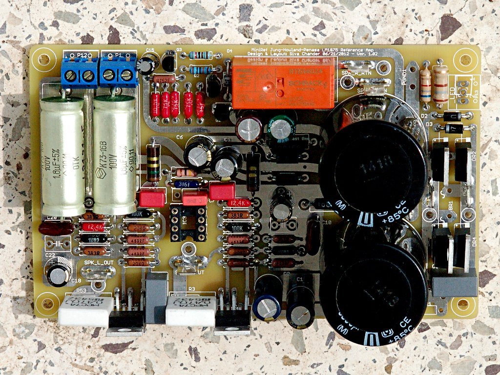

Update: Presapian on this forum prototyped the MiniRef LM1875 and has succeeded in performing several important upgrades/changes/tweaks:
1) Salas shunt regulator(s) for the opamp +/- 12V rails.
2) Changes to the inner voltage-feedback loop of the Jung to allow the use of an AD797BRZ as the controlling (GNFB) opamp.
The latter is a very exciting development, since it presents the possibility of a chipamp board with audible sonics that exceed almost any discrete power amp. He's offering his bare boards here and elsewhere, so I'll leave it to him to provide further information as necessary. However, these are tantalizing extracts from personal communications from him:
"797 doesn't display any hf artifacts in your circuit (as far as i can hear) by it's bare self so i'm considering this match made in heaven..."
"all in all this must be the greatest breakthrough in chipamp development since the original myref. "
I'm awaiting some bare MiniRef 1875 boards and will try to replicate his results ASAP, but with a discrete opamp like the LF03d instead of 2x AD797B - let's see how it goes.
I've received some bare MiniRef boards from Eric and populated it over the weekend - the first tests with a monolithic opamp (NE5532) this morning went fine and the audible sonics are excellent, and the output DC offsets are a nominal 8.9/10 mV. I'll test it a bit further before hooking up the Salas shunt regulators and swapping out opamps for the discretes. Here's a pic of the prototype build, with moderately premium components across the board in the audio signal path, but nothing outrageously expensive.
