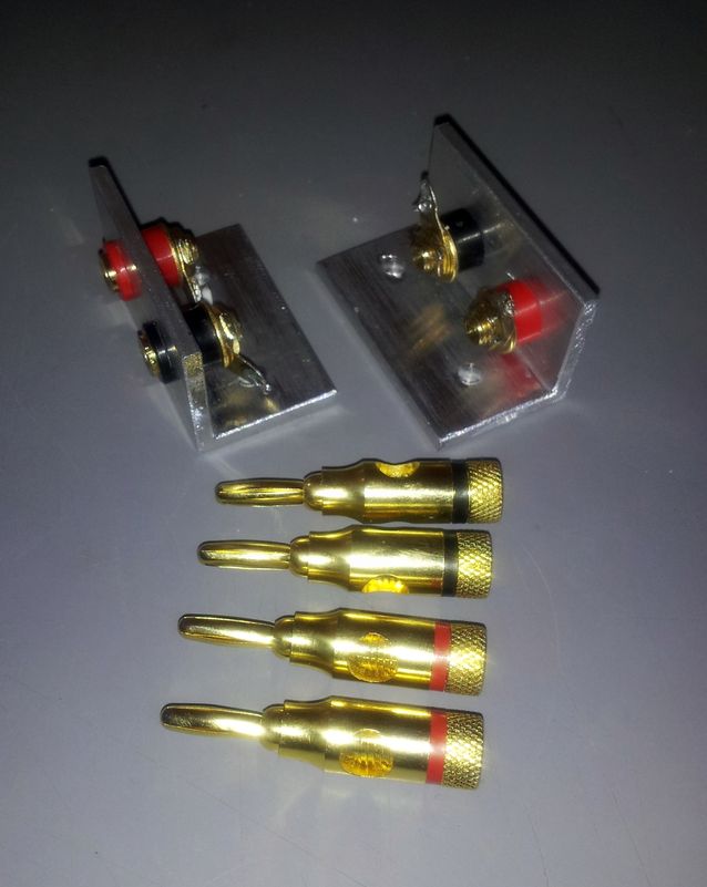

Here's the completed and fully wired MiniRef 1875 build, in a compact 1105 cabinet with 2x 19.5V/2A netbook AC adapters as the PSU:
As can be seen, everything fits within the approx. 208 x 115 x 48 mm cabinet.
The gold-plated stackable banana/binding-posts are my solution to the limited space available for fitting regular-sized binding posts to the cabinet. They're optional, of course.
Those bananas work well with two-way cable insertion.![]()
Yup - I notice that you're using similar low-profile banana sockets, but with gold-plated conductors and eyelet tags. I'll upgrade to those in a future build - this was a proof of concept, so I used whatever was available locally.
