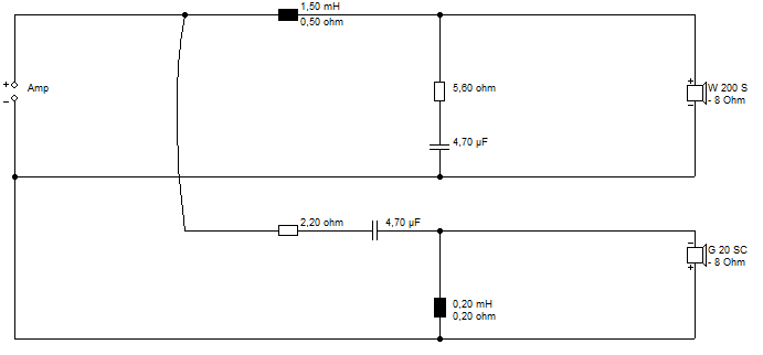

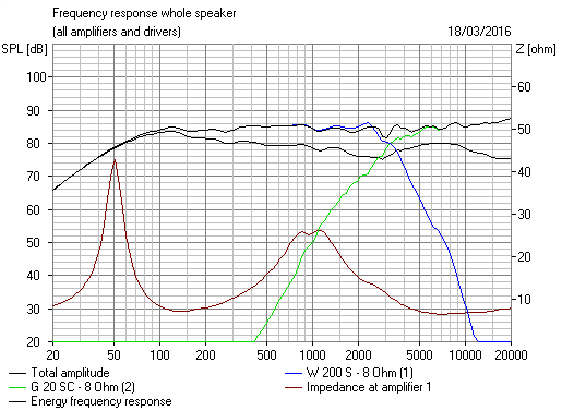

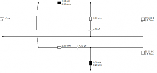

That Vifa driver is rather a good replacement for the original polycone IMO.
What you'd hope is it now works a bit like this. Sort of speaker I like doing.
