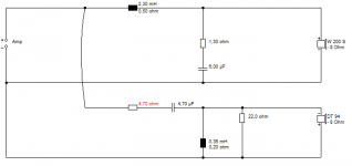

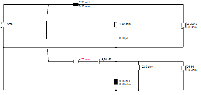

A tweeter section sees about 10W maximum, usually less. So the 4.7R should be a 10W. The shunt 22R and 1.3R below sees less current, so a 3-7W will do.Hi Steve,
Thanks for this and I dont find these speakers to bassy and from what I recall of original 770s they are a tad more tighter controlled imho. What wattage resistors do you recommend and are polyprop capacitors ok (e.g. wima's)??
Regards
Rob
Any polypropylene capacitor will do. 250V types are smaller, so useful here.

Steve - with regards to the schematic are you indicating that I need to add a 22R shunt resistor, a 4.7R and a 4.7uF cap too. I can replace the 2.30mH coil - what would you recommend?

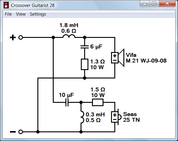

The M21 isn't wildly different from the P21 anyway. I did find a design not a million miles away from yours:
P21WO20+ R2604-8330 2way Passive Crossover Design - Madisound Speaker PDF Library
10uF/0.3mH and 3.3R and 47R attenuator on the 2kHz R2604 crossover.
Bass is a bit different, using impedance correction. 0.8mH series, 12uF and 3.3R shunt, 5.6R and 40uF (39uF surely...) impedance correction.
Seems a bit low crossover to me, but who knows?

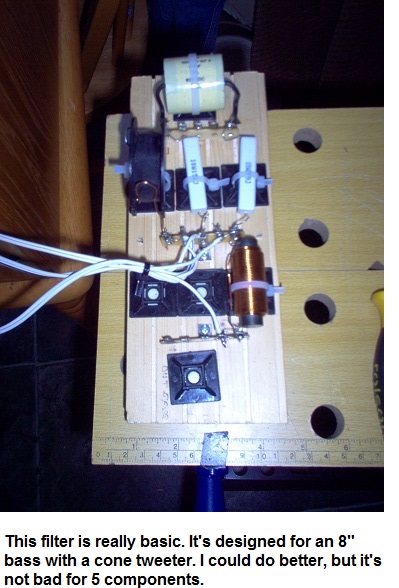

My old 8" speakers were very simple:
Restoring Monitor Audio R300 bookshelf speakers.

This is nice too, and simpler:
P21WO20+ D2606-9220 2way Passive Crossover Design - Madisound Speaker PDF Library
1mH and shunt 8.2R plus 22uF on bass. 6uF and 0.6mH on the tweeter, 2.2R plus 15R attenuator.
The Scan D2606-9220 is an old vifa or peerless design, IIRC. 91dB tweeter much like your SEAS. Can't remember how different the P21 is from the M21, But the filter might work very well. Sort of thing I like doing. Sounds OK.

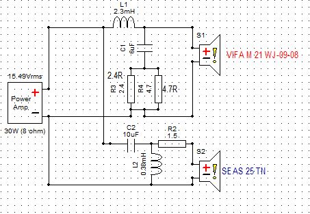

Thanks Steve and very good to hear from you.
Let me 'try' to draw up the schematic of the current system and then we will work from there.

Did we decide it's a 2.3mH bass coil in Dissi's guess?
Does look bright at the top if I haven't lost my touch. But you can tone down bass with a smaller bass coil.

If it's 2.3mH and 0.36mH, we have enought to go on.
Tweeter definitely too loud. Crossing way to low too, IMO. Would have to look at the spec sheet for the woofer to know if it will work in reflex. This is not difficult. Might spend £20 on components.

I will double check but the first coil readings were 0.36mH for the tweeter and 2.3mH for the bass. I have no issues in spending a bit of money to get these up and running.

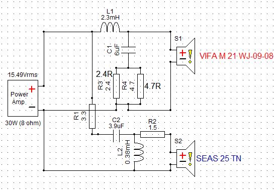

But I think we can do something with your existing bits. Just need to lower the crossover and attenuate a bit more. I think a 4.7uF or even a 3.3uF capacitor would work better than the 10uF. And add about 3.3R 3W or 7W wirewound aka ceramic in front for about 3dB attenuation.

Here's the plan. We replace 10uF with 3.3R (3W) in series with 3.9uF.
PM me your address, And I have already wrapped up the components along with a bit of 15A fusewire and some unleaded solder. You just need a modern 40W soldering iron, available from screwfix or such for about £15.

Yup, that's what I was thinking. Just lash it up.If it goes open circuit, it'll do no harm.
Ages since I have done this, but I suspect the tweeter goes negative polarity in this one.

I do apologise that its taken this long to reply on this forum but now being at the point of earlyish retirement (I'm 62 now) I have a chance to get back to work on my hifi system. I am pleased to say that I've modified the crossovers and that the speakers are working extremely well; very well balanced and neutral with the A&R A60 (no treble or bass alterations amp wise). The only issue now is the size of them - they are in our new house extension which is about 3m x 3m so they look huge! I will stick with them but I would like to seek something a little smaller over time that can deliver the same overall sound if this is at all possible?
