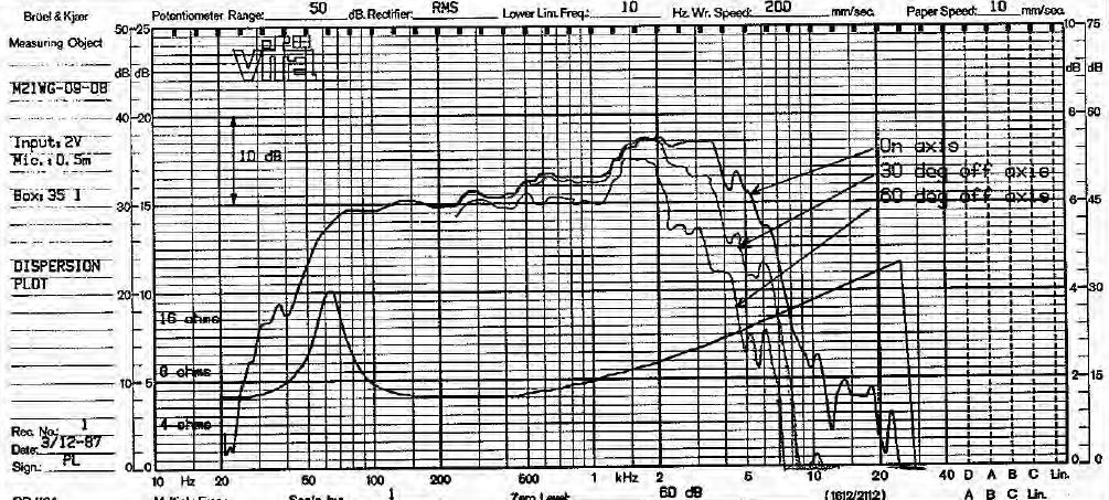

Well, the voice coil diameter of the Vifa M21WJ-09-08 actually is 32 mm and has nothing to do with bass output. The Thiele-Small parameters of the Vifa P21WO-20-08 are almost identical and so is the bass output. I know you are disappointed because of the replacement drivers, but they are fine and there's absolutely no need to buy something new unless they do not work properly anymore.
Wilmslow audio have confused the WJ with the WG (which they sell). They are in fact very different drivers.
WJ Qts .24 v c diam 32mm
WG Qts .7 v c diam 25mm

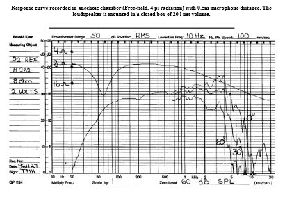

Let's look at the original issue. The original Mission 770S woofers were SEAS P21 REX polycones AFAIK.
http://www.seas.no/images/stories/vintage/pdfdataheet/h0282_p21rex.pdf

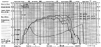

Wilmslow Audio are on the money when they say the Vifa P21WO-20-08 polycone is a decent replacement.
Vifa P21WO-20-08 Diameter 215mm

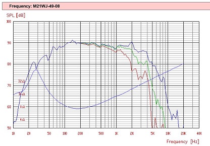

But the seller has fitted a paper cone Vifa M21WJ-09-08, which must be similar to the Le 1.7mH M21WJ-49-08 below and last. It's not quite so compatible IMO, but results depend on the crossover. Which is currently unknown.

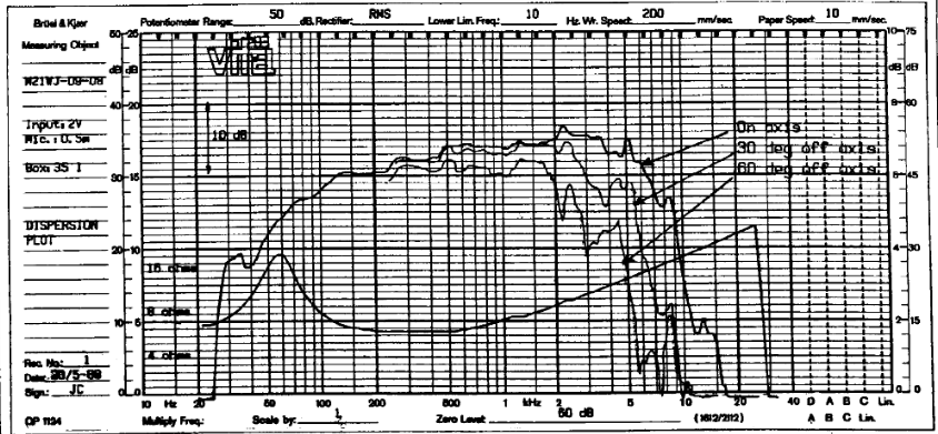

Vifa M21WJ-09-08 woofer: http://www.sea.vg/vifa/M21WJ-09-08.pdf

The replacement Vifa M21WJ-09-08 paper woofer, below, which you have creditably tracked down, looks easy and well-behaved enough. I have done this sort of thing myself, also below. We all worry that our friends will laugh at our loudspeakers, but TBH, what's hard here? 3 kHz crossover possibly. I'd be quite pleased to have picked these up off flea-bay for £33.

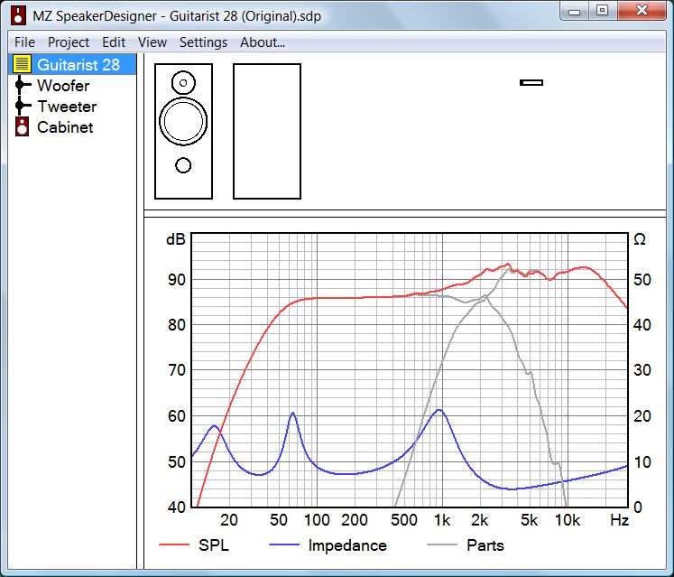

Can you review what you have done here? I'm not sure what the crossover is.
Seas 25TN (H377) tweeter: http://www.seas.no/images/stories/vintage/pdfdataheet/h0337_25tn.pdf
The tweeter is non-ferrofluid, so should be OK after all the years. The paper woofer might need more crossover work since it replaces a smoother polycone, IIRC. Plus some level adjustment.
But I'm sure we can tune this one up. This is what we do. 🙂

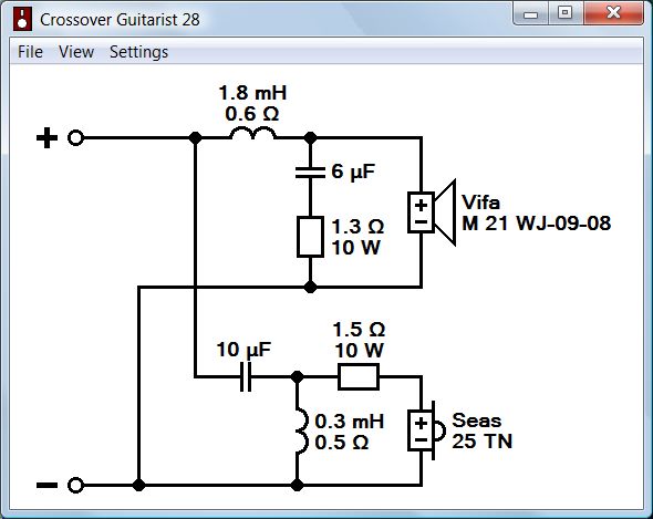

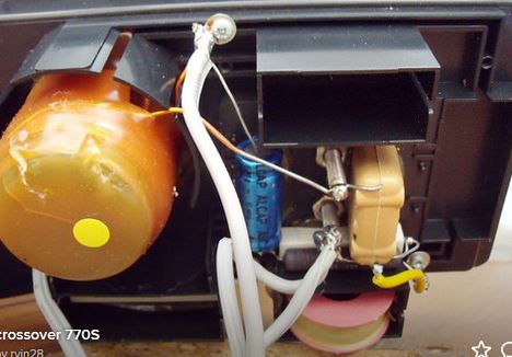

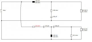

I apologies for the schematic attached as I really struggle to draw these in a logical format. I unsoldered connections to endeavour to get a true value of the components rather than in circuit. Given that these have been glued to the plastic chassis in some cases I've had to go by the value from my multimeter than could be found on the component e.g. the 10uF polyprop capacitor.
However, I hope this helps?

Well done. The previous owner obviously replaced the drivers but wasn't able to adjust the crossover properly. The tweeter apparently is too loud and the impedance is unnecessarily low.
Of course you can try to modify the existing crossover now, but without knowing the actual coil values that's quite speculative. A new crossover probably would be more straightforward.

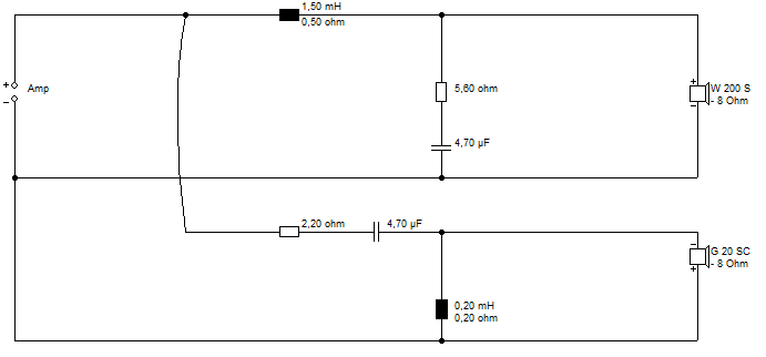

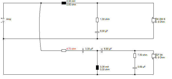

I did forget that I had tester for inductors - assuming it is correct then the coil nearest the SEAS tweeter reads as 1.1R and 0.36mH, the other coil reads as 0.6R and 2.3mH. I do have another means of testing this as I've a signal generator and several oscilloscopes but I cant get to these at the moment as I'm in the middle of decorating!!

Geesus Rob!
Get XSim to draw your schematics it's free, and will save your schematics in a picture format you can upload directly here. 🙂

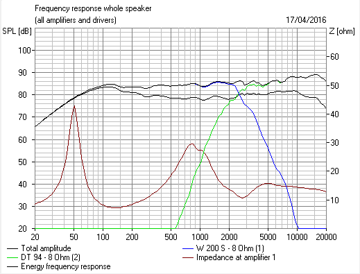

Dissi is a pretty safe pair of hands with crossovers. 🙂
If this is what we have here, I'd look at that 2.3mH bass coil and say this is a bassy speaker best placed away from the wall.
Working with what we have, if you don't find the bass intrusive, I see problems with the 10uF tweeter capacitor and 0.36mH coil. Capacitor is way too big IMO, and likely to produce a 3kHz midrange peak. 4.7uF might be nearer.
Like I say, I wouldn't use such a big bass coil, but you can fix that later. For now, this tweeter filter might work better at the mid and top end. All you really have to do is adjust the 4.7R resistor for tweeter level. Also amp-friendly impedance.

Hi Steve,
Thanks for this and I dont find these speakers to bassy and from what I recall of original 770s they are a tad more tighter controlled imho. What wattage resistors do you recommend and are polyprop capacitors ok (e.g. wima's)??
