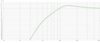

What about the bump at 50Hz?

What bump at 50Hz? ;)
You get peaking at Fb if it's designed in (accident or intent) or the effective driver Q is > Butterworth.

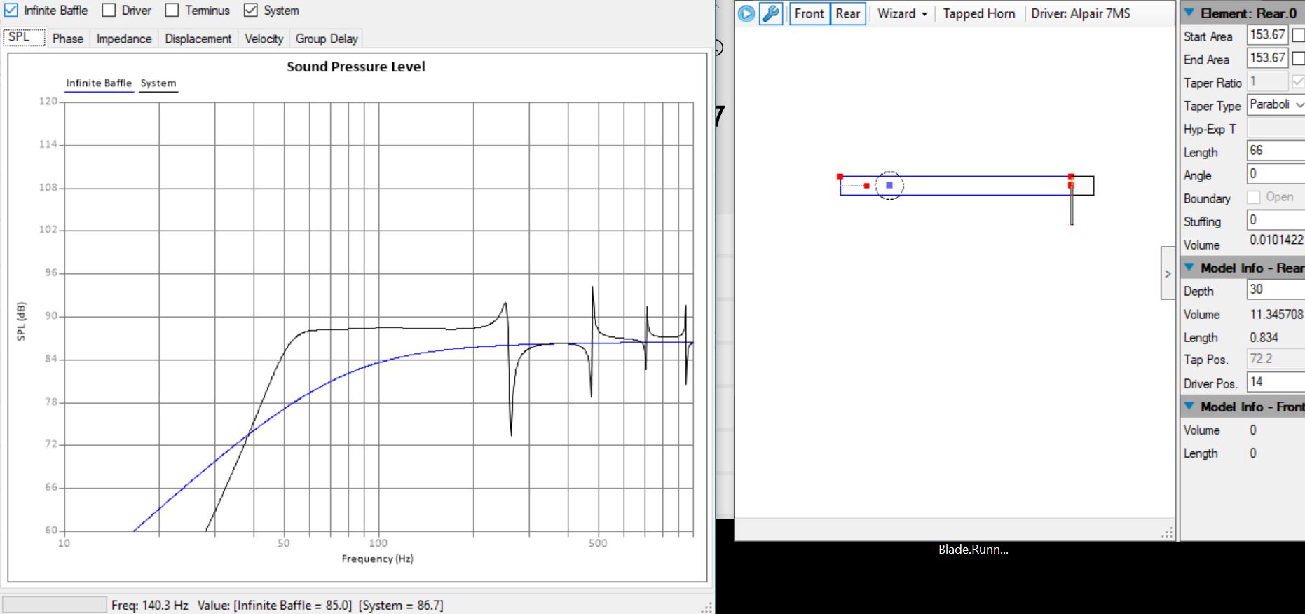

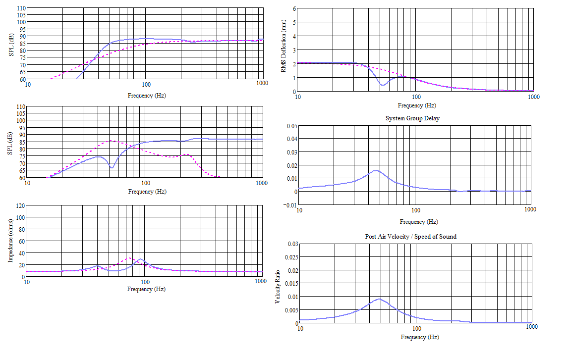

Thanks, Scott, looks very interesting and I always like your designs.
Is this what I should be looking at?
7MS is fine for a compact MLTL (an oxymoron in GM & my parlance, but the term will suffice)
~51Hz Fb compact MLTL. V. quick, lightly damped alignment. Internal dimensions:
L = 28.5in
W = 5in
D = 4.75in
St = 5.75in
Sv = 24.125in
Av = 3.14in^2
Lv = 4.5in
Vb (nominal) 11.1 litres [nearly].
Lag all internal walls 3/4in - 1in acoustic fiberglass, SAE-F10 felt, Ultratouch or similar & adjust to preference.
It doesn't look like a good match for the MLTL design.

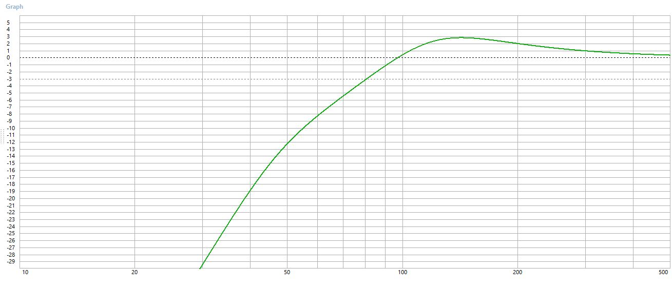

Just did a quick WinISD sim of this recommendation. 3.45l and port tuning of 74.7hz. Is this what I should be looking at?
Vb = [measured] Vas/1.44
Fb = [measured] Fs
Using the published specs and accounting for some damping combined with the XO's attenuation around Fb, the vent can be quite small: 2.54 cm dia x 6.2 cm long.
