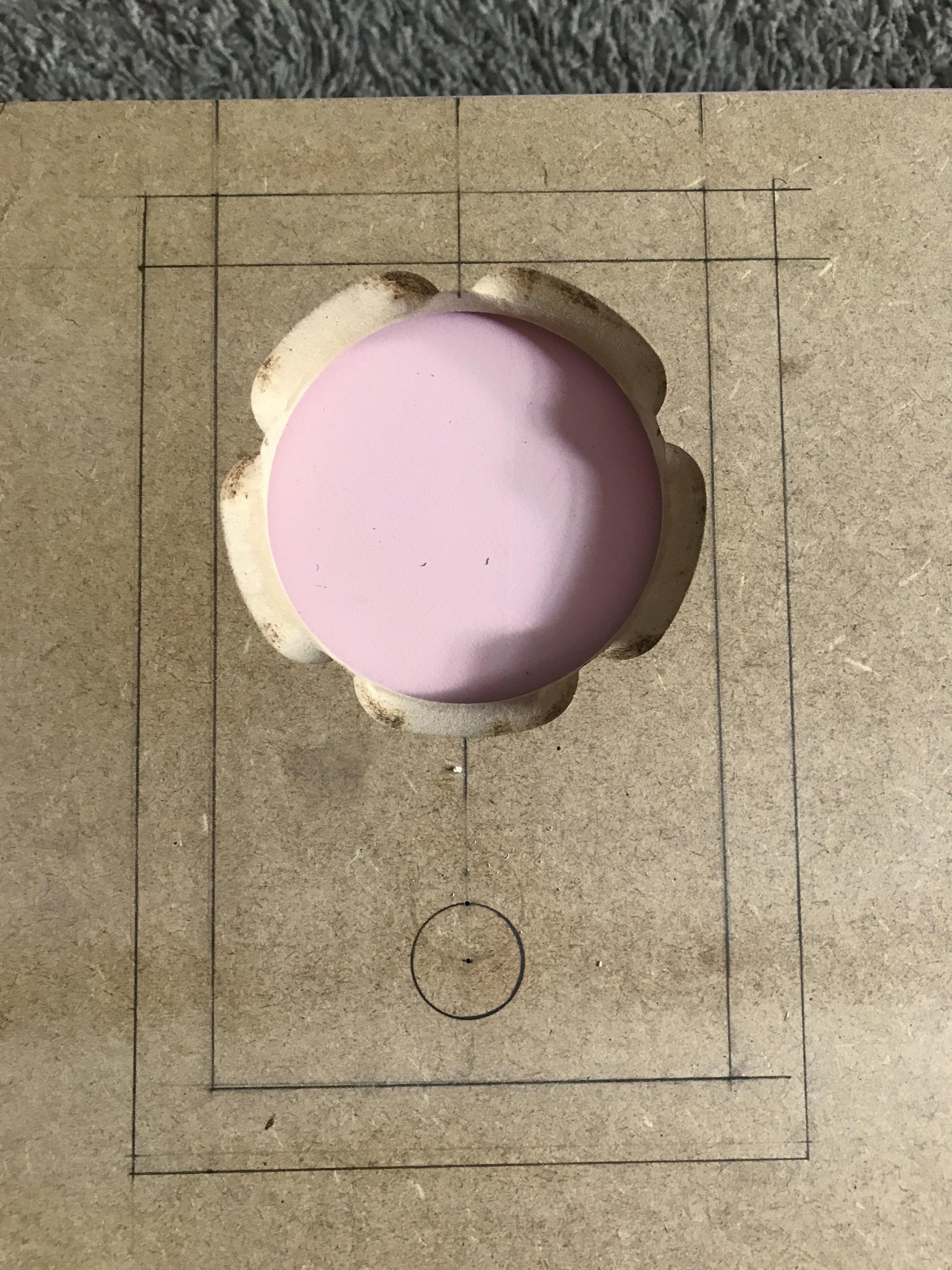

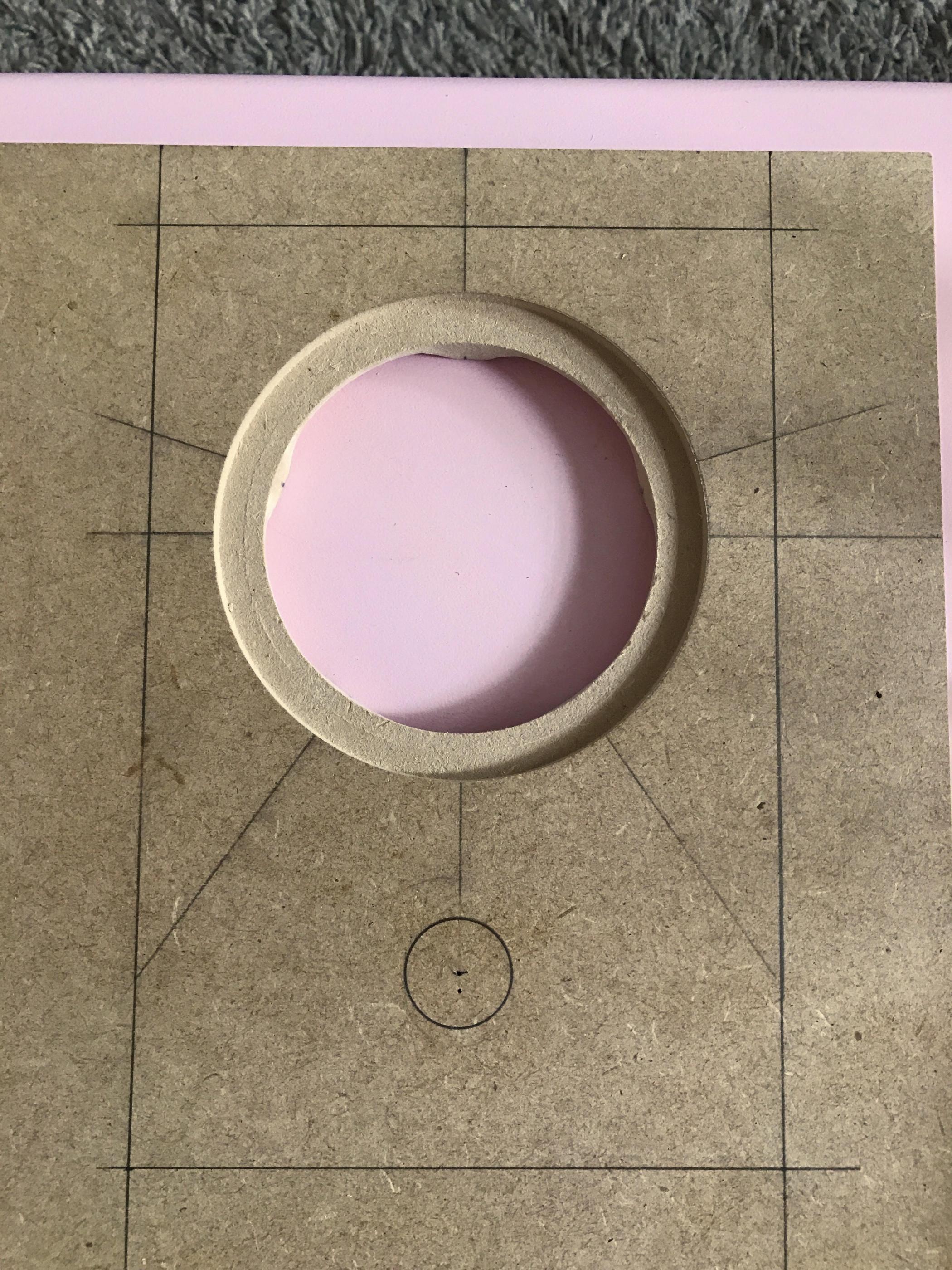

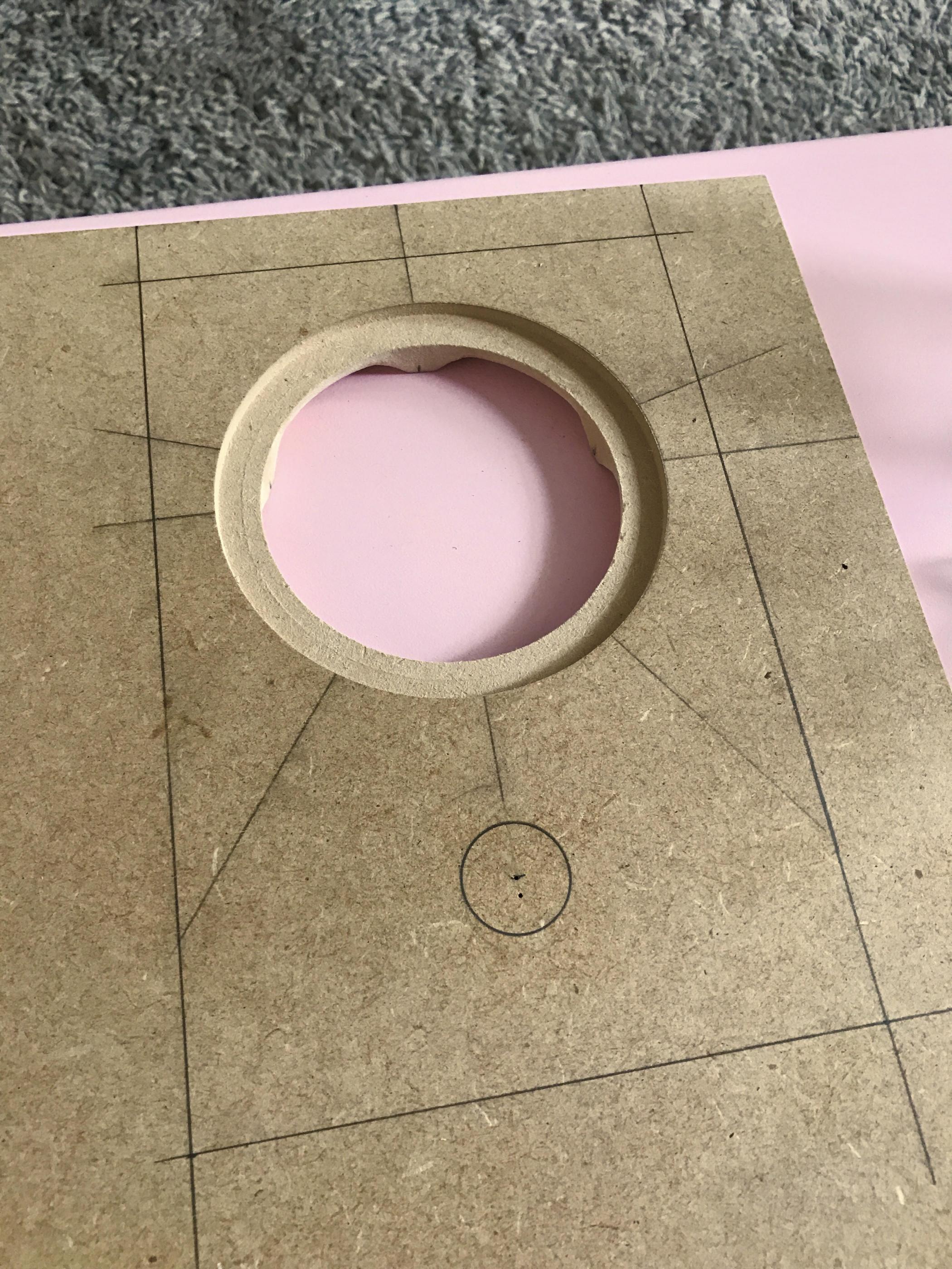

Baffle layout and routing done for GM's plan!
Scallop beveled and sanded smooth. Flush mount rabbet cut to 4mm deep to leave the driver 2mm proud (allowing 1mm for gasket).
Internal dimensions which incorporate port, driver (250ml) and bracing volumes: 120mm x 160mm x 195mm.
Quick question, will the port have any difference mount on the front or back? They will be positioned on the corner of a fireplace with an alcove that is about 40cm deep on both sides.
As always, any thoughts welcome!

Generally speaking it doesn't usually matter unless really close to wall, but close to something as massive/dense as a fireplace combined with its cavity will for better or worse enhance vent output, so you may need to do a bit [more] of any vent damping required than for front firing.

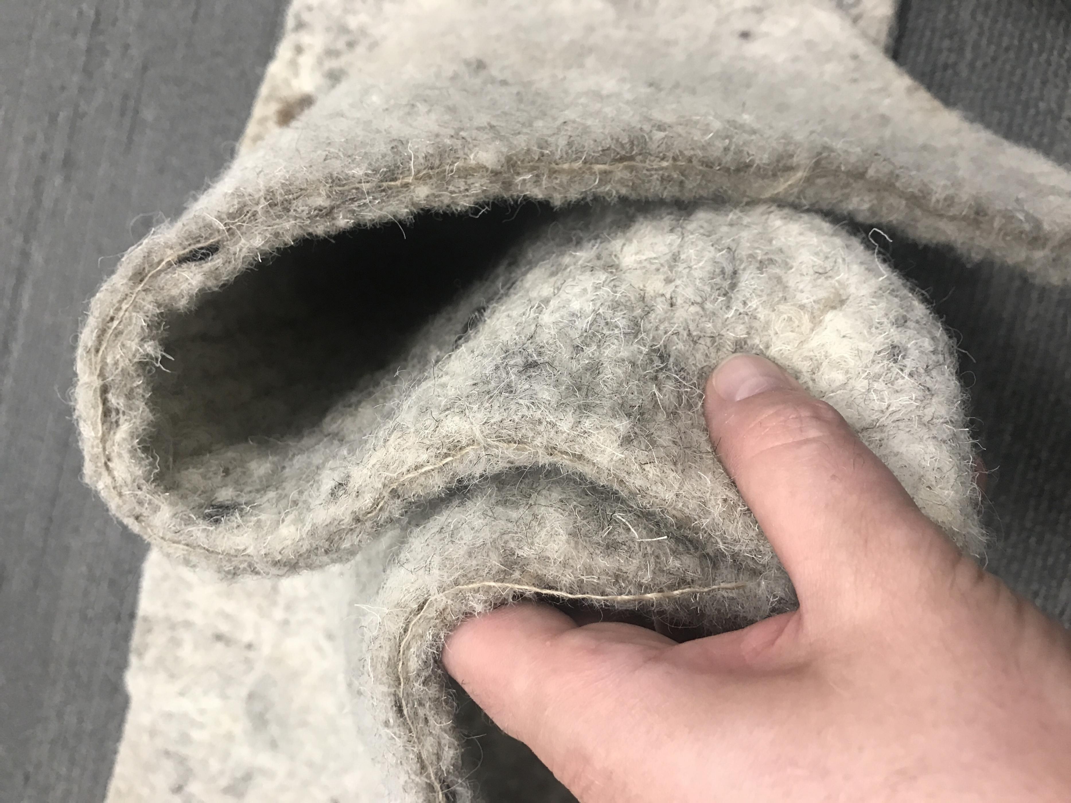

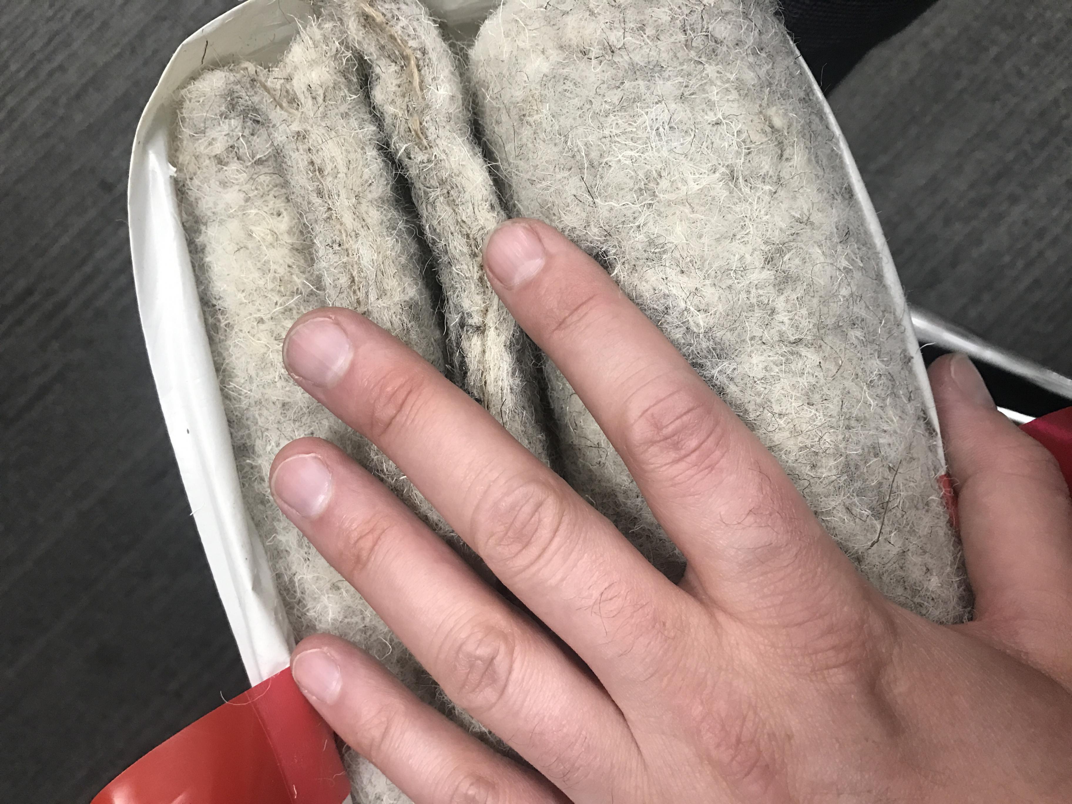

Picked up a Tesco bag of wool at my local rug shop. It's quite thick and smells of sheep. About 13mm, is it too heavy handed for the vented design? It can be de-laminated. Maybe I should just use it sparingly and measure the results?

Would be for me as I prefer fiberglass insulation's damping properties combined with vent damping [if required], but many on the various forums prefer [much] denser materials, so ideally one should test to find what works best overall in the intended app or just use it knowing that you're in the majority ;).
That said, you could do like the pioneers did when using it in vented alignments, i.e. just covering about 70% of the top, back and one side panel down to just above the vent.
Another option is to cover just the top and vertically suspend a loose hanging 'blanket' diagonally down to just above the vent, which BTW works well for damping large vents such as the terminus of the BIB for instance ;).

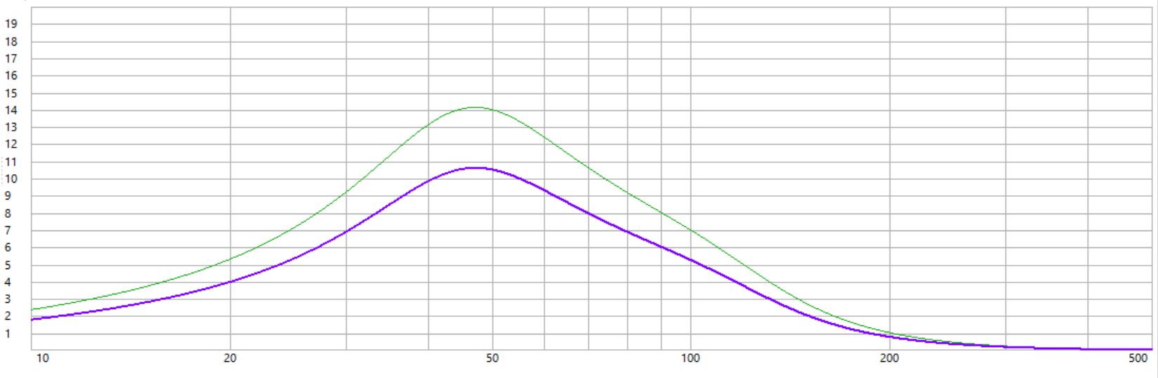

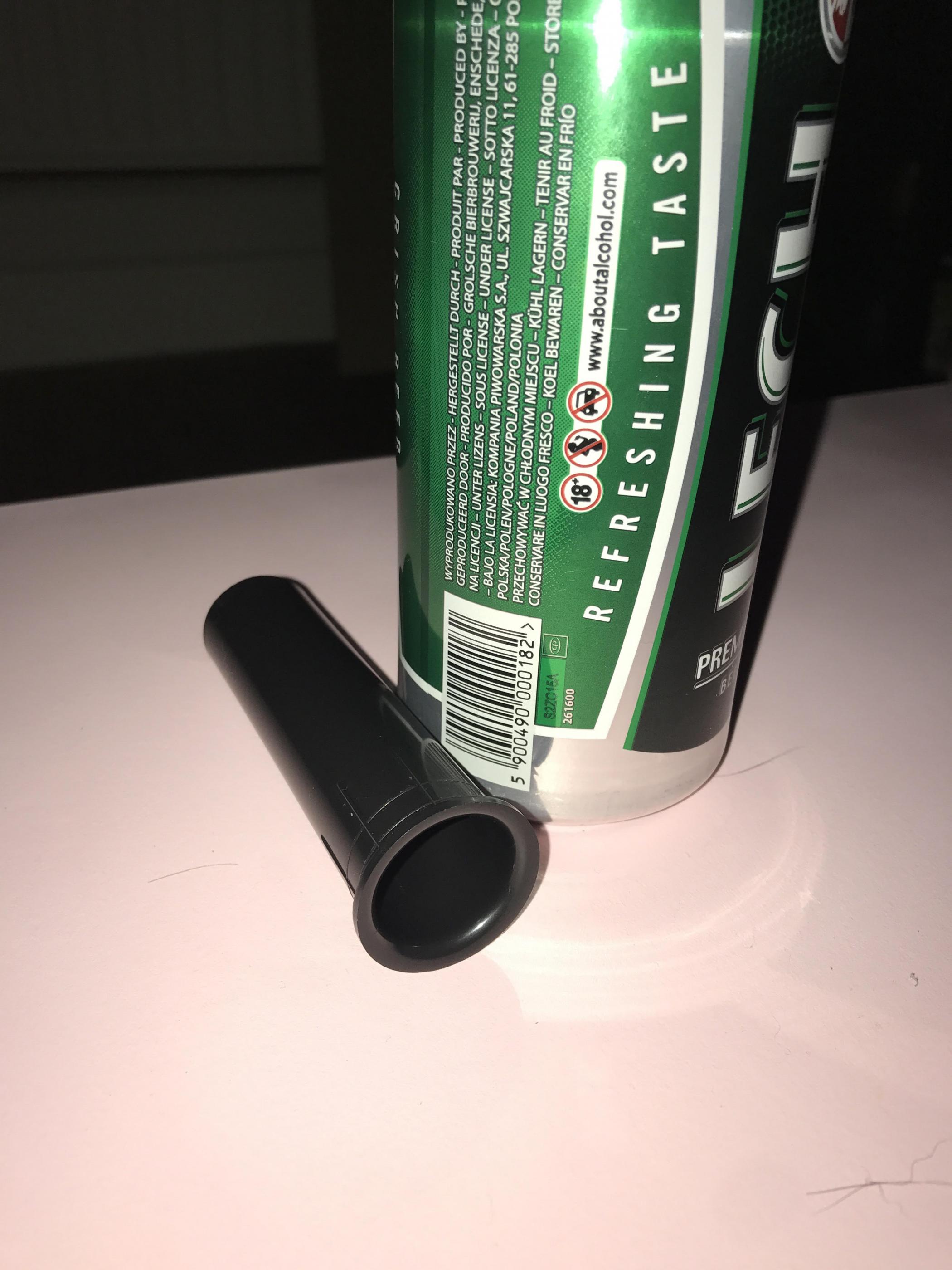

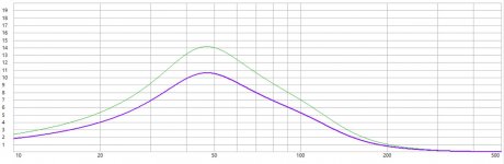

My ports arrived today and the diameter taper goes from23mm to about 22mm at the length I will cut them. From the suggested 25.4mm port diameter this shoots port velocity up from around 10.5ms to 14ms. Is this a critical error as I believe it only effects the response of the port not the driver as the driver should see the same system in place?
That velocity peak is at 46hz and is at 7ms by the time it reaches 90hz.
China needs to buy new a new ruler when it comes to measuring mail order products...
Right, when vent mach gets much above 3-5% of the speed of sound in air [depending on the source], it will start loading up, causing audible chuffing, so 'sounds' like you're OK.
If it really loads up though, then it will shift tuning lower, but typically it will be so obviously distorted that folks normally lower the volume and/or change an EQ setting if available. Then again, the mobile audio crowd typically use grossly undersized vents and been known to crank them up higher to increase distortion. Known some HT folks to do it too, especially with a very well known brand, so I guess one man's distortion is another's special effects.

According to WinISD:
Purple is 25.4mm port
Green is 23mm port (with length adjusted accordingly reach equal tuning).
Since the port is smaller I may sand down the unflared end to match the 2mm flare on the factory formed end. Perhaps this may help minutely.
Can of polish beer for scale... (it's almost midnight here and fiance is in bed, hooray! ...)
