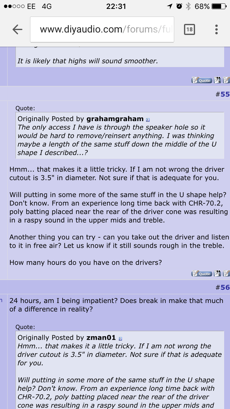

The Sasquatch is really nice though I have always had doubts about damping in them. They have no damping behind the driver as I read in several places that this wasn't appropriate for these drivers. However, having been helped through this process I can understand some of the faults they had.
1. not enough damping behind the driver.
2. Side panels are in 12mm MDF (other panels are in 15mm)
3. They are just a bit too small for my requirements as they are more suited to nearfield use.
