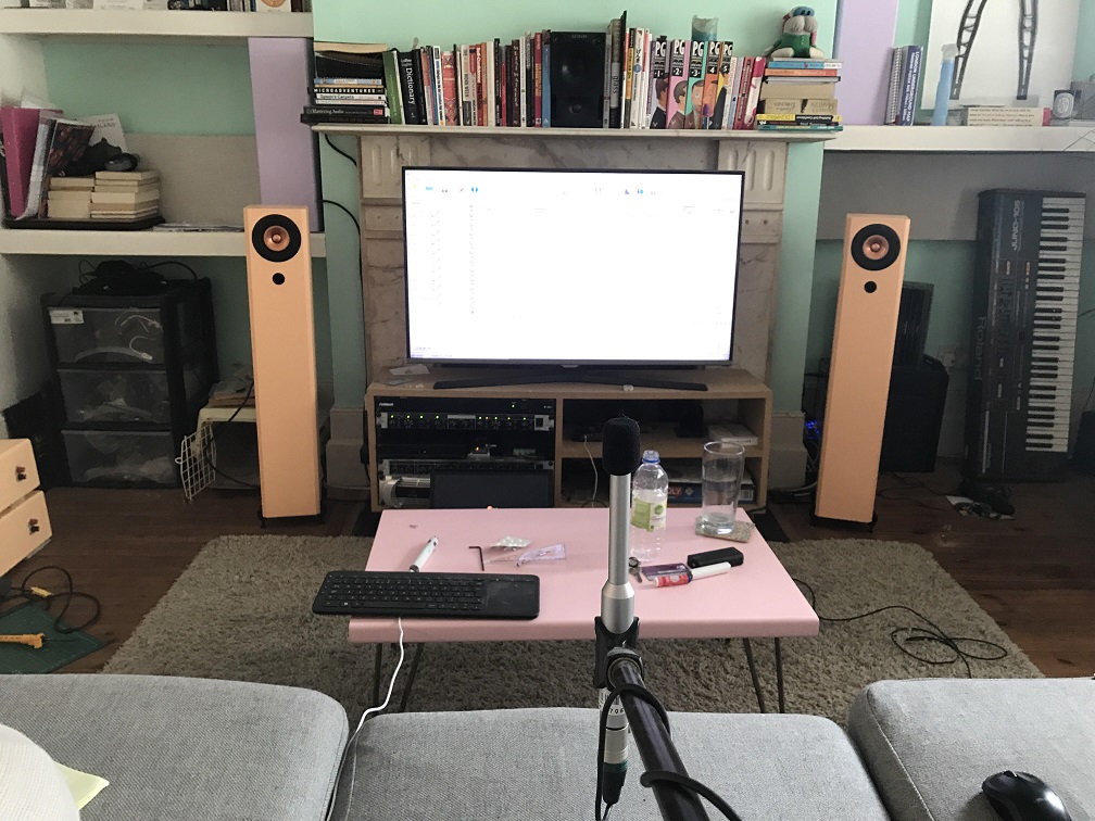

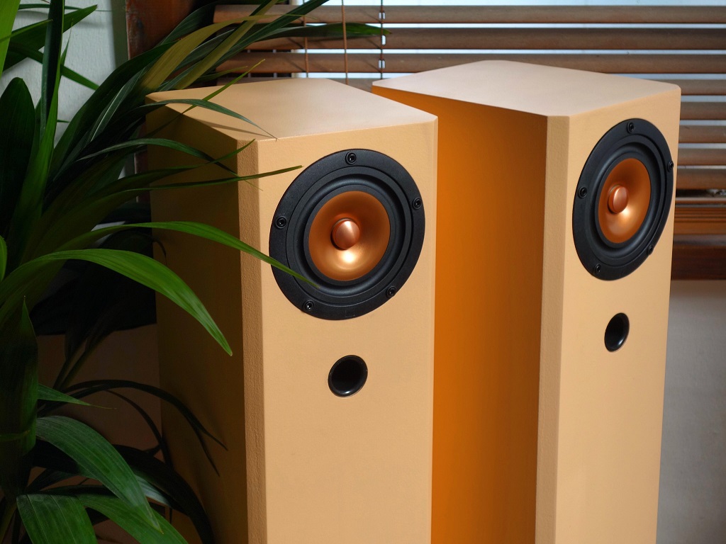

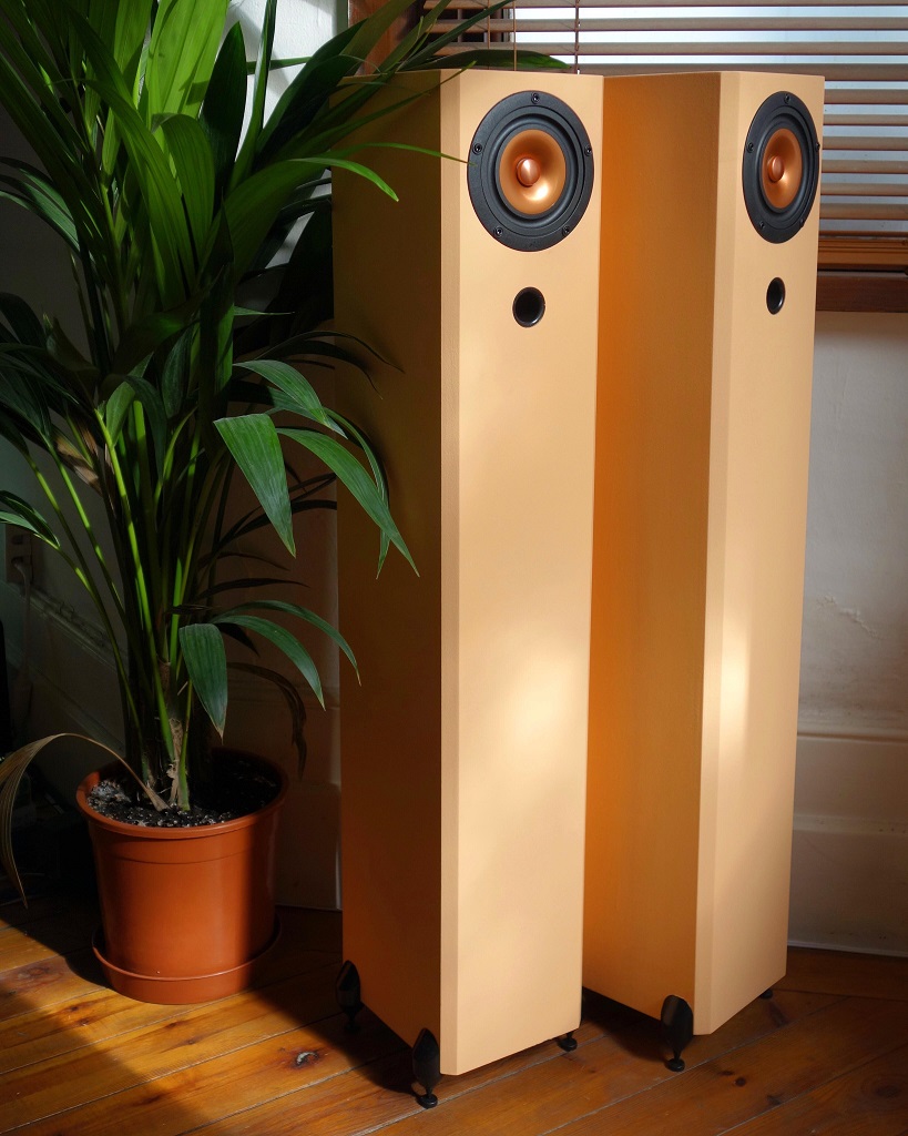

Sorry, I've been quiet, I worked two days flat out to get these done and I am very happy with the results! A few blemishes here and there but all in all they are OK. I just want to say thank you again to all involved that have helped me get this far with them!
I couldn't resist a couple of documentary pics!!!

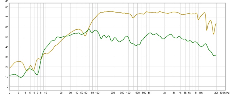

I have started to run some measurements both at near field and listening position. 1/6th smoothing.
attachment.php
Below are both measurements:
attachment.php
Brown is nearfield at 15mm. I believe this looks as it should! The dip at 60hz is a room mode, I believe.
Green is at listening position. Note the valley between 100hz to 1000hz. Is this my room at play?
attachment.php
My subwoofers are about 50cm behind the floorstanders and I have them inverted on my MiniDSP as this seems to give the best crossover blending sound. I haven't tried any time delay or crossover curves - they are currently set to 90hz with a LR 48db curve on both the mains and the subs. This seems to give the punchiest and nicest sound. Any suggestions on where to go with these settings?
I have to keep reminding myself that these are incredible sounding speakers and a great and flexible set up which I am very thankful of. But... there is always room for improvement and tinkering!

2 days to cut, glue and paint 2 enclosures? Time must move slower in your part of the world... I can't do that!

That peak rising again at 1kHz would drive me nuts... I'm very sensitive and hate anything that has a peak at 1 kHz.
Have you tried moving the towers around a bit? Sometimes, just a few cm makes a big difference. Side to side, back to front, see if you can resolve most of the dip by moving them a little. When all else fails, I'd use the miniDSP to bring that 1kHz peak down.
Voices must be "nosy" right now.
Oops, just noticed your scale is 10dBs... that's a lot of swinging around...
Handsome boxes! What do the insides look like?
I'll try and up some images of the build process soon!
I cheated a bit by having some of the MDF boards cut by my local joiner! But after the two days I was absolutely exausted!
The upper mid certainly does have some issues and I have tried your suggestion of bring down the 1000hz hump with MiniDSP, it has improved things a lot but there is still more work to do!
I was thinking that maybe BSC might be needed? It's my understanding that these drivers are design with BSC already considered?
I'll do some experiments with positioning soon.
Also, when you say thats a lot of swing, do you mean that the frequency response is very dynamic along the plot? Big troughs big peaks?

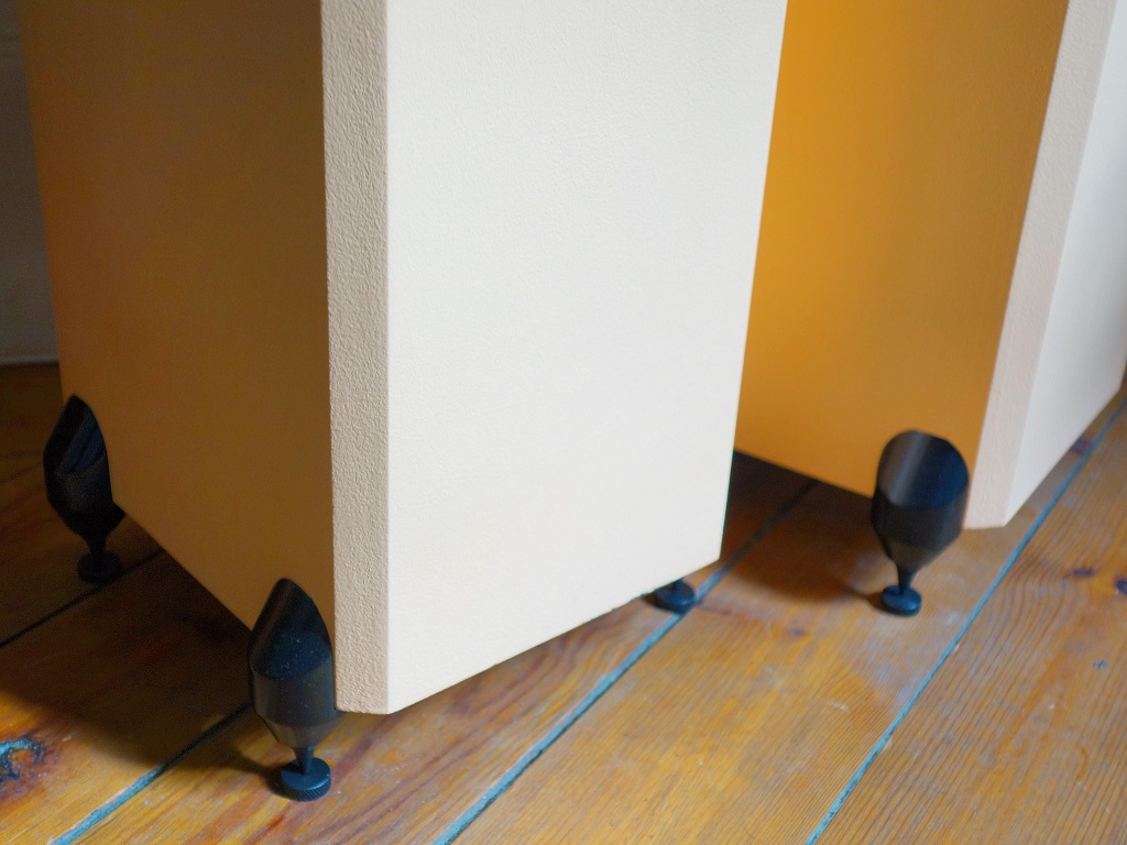

Where did you source the feet for the speakers? Is it made out of some kind of plastic/polymer?
Thanks!
I got them from a chap on ebay. I think they are from a pair of factory made speakers as they have no name or any markings of brand etc! They are smart though and Stefan has suggested I get them powder coated as I painted them with Rustoleum and there was some reaction from the metal or previous paint that created light bubbles. I put the ones with blemishes at the back of each speaker. They are quite heavy, and look cast.

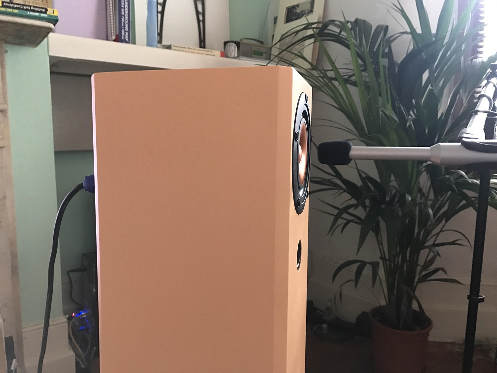

I Think he might be referring to the fact that the front of the mic is pointing straight up in one of your shots, which puts it 90 degrees to the speaker. If it is an Omni mic it shouldn’t matter though, as far as I know...?
Zigzag could be cone breakup artifacts?
Where does that yellow FR come from?
The green is from previous measurements, but we have no idea where the yellow is from.
A BSC, like 1mH and at least 5 Ohms in your case will bring the whole thing curve from 1kHz down, which would be a bad thing since it already drops starting at 4kHz. You would probably lose most of the high end.
Since you have the miniDSP, why not do a broad notch to bring the 800Hz to 6kHz down?
Here's the Harsch XO thread and how to do it using miniDSP.
That's what I thought as well, perhaps I am wrong? It is an omnidirectional mic.
The browny yellow is measurement is at 15mm and green is at listening position - both as pictured in post #147.
Right, got a good idea.
I have been tinkering with that, I will continue, cheers!

I compared the FR from my (yellowy brown) 15mm measurement to the specifications PDF FR and it looks very similar except over 10k it goes a little wilder. Could this be graph smoothing?
Does anyone know what's going on above 10khz? A weird zig zag pattern, hmmmmm.😕
A major dip down in the bass range is normally a vertical null, so ~565/60 = ~9.4 ft ceiling height, or.........?
Hmmmmm.😕 is right! The HF zig-zag is normally cone break-up modes and ~mimic the published response except with a rapid/more erratic roll-off, which shouldn't be the norm unless it's a measurement problem at your end.
The real baffler though is the near flat near-field response that should indeed have not only some audible built-in driver BSC, but enough more to maybe a little too much by the cab's audibly identical slope response down to ~60 Hz where the vent is rolling off faster than the driver on a large OB; and if this isn't weird enough, the stepped up response that should just be a minor dip at ~500 Hz, then decaying/'marching in step' at the amplitude up around 400 Hz implies that short of having a large whizzer cone the driver has already shifted into massive [~controlled] breakup, which while possible [re lead guitar, horn drivers]. I'd like to think it's somehow a measurement error, though ATM no clue how this could be............
