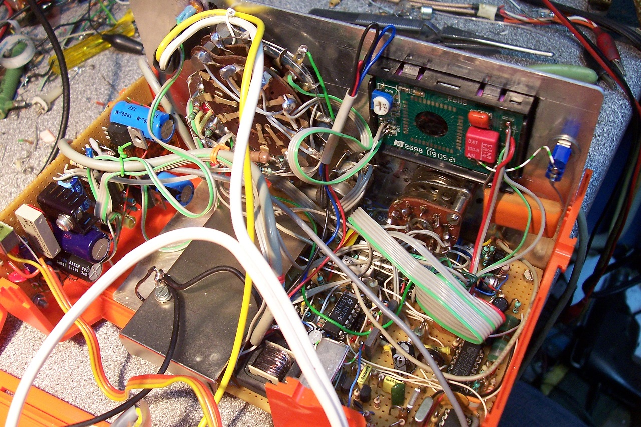

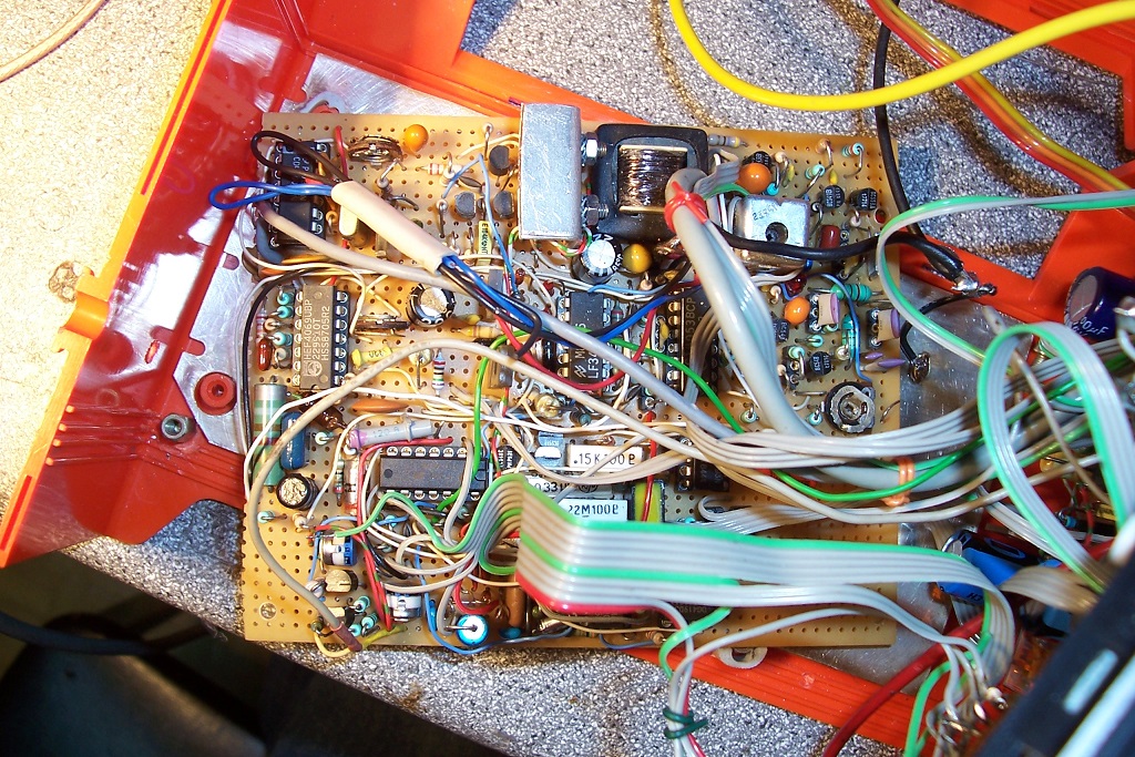

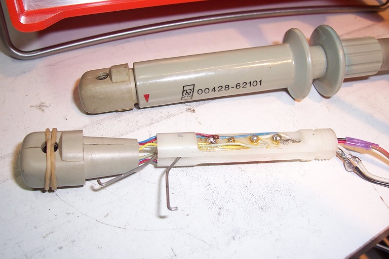

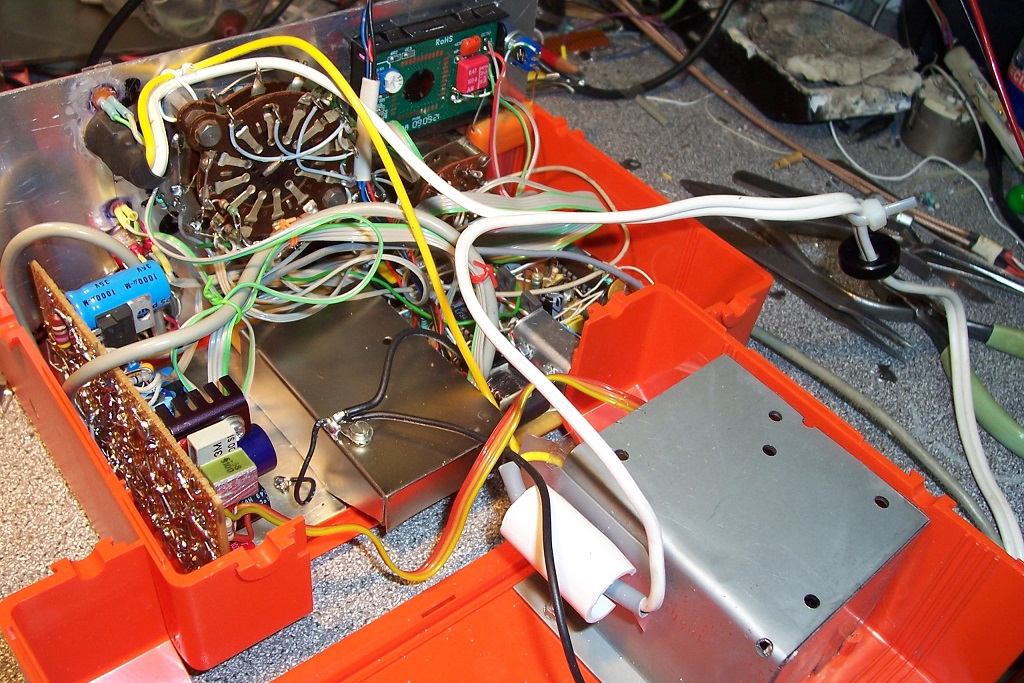

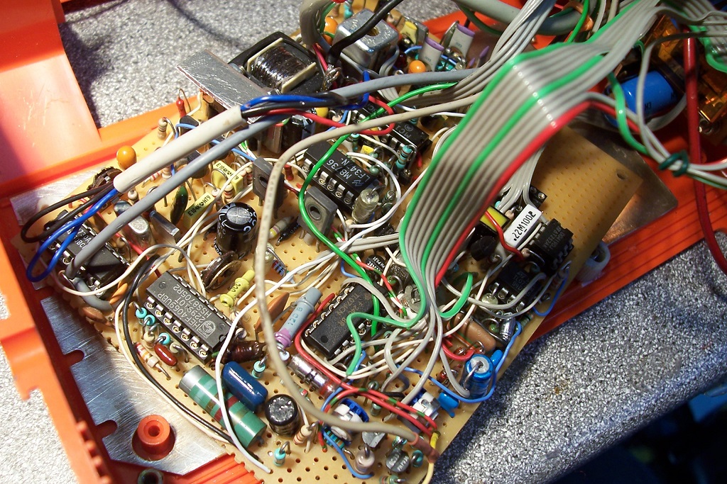

Here is the display board, and some more pics: first, a dismantled probe, and a view of the inside.
On the bottom is the main board, on the left is the supply/degausser

  • I didn't depart fromr the core architecture of the original 428: the probe was designed to be used in a certain way, and reusing the same principles is certainly the shortest path to a working and effective clone, which is my goal here.
    I am certain that the probe could be used in a totally different manner, and still give acceptable results, but I didn't want to engage in some creativity exercise, as it would require much more work for an uncertain result (could be fun though).

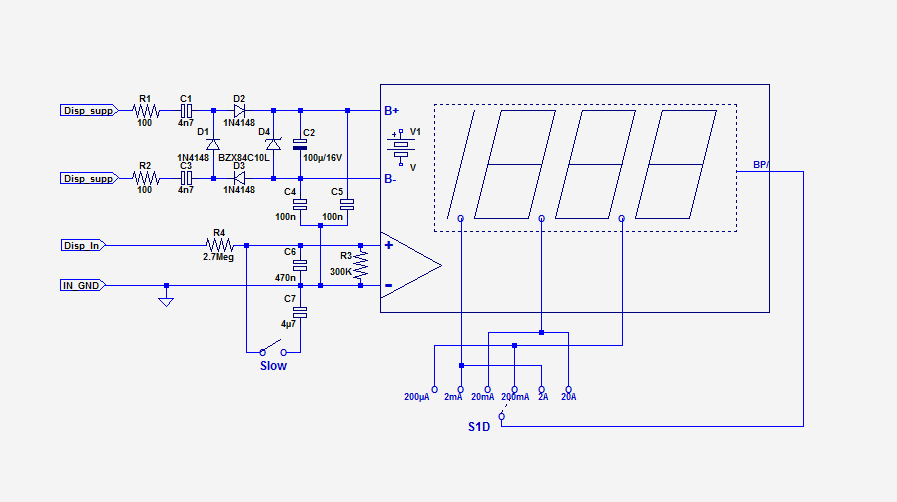

Next function block is the Display Circuit:
Pretty standard stuff for a 7106-based module, except perhaps for the supply: it is derived from the probe exciter.
Since it produces two nice antiphase 50KHz waveforms, it is ideally suited for the job, and the burden of a few more milliamps is completely negligible.
C1 and C3 transmit the power to the floating part of the circuit, and at the same time form an AC divider which results in zero AC voltage on the meter side.
This zero is perfected with the help of C4 and C5.
The signal input undergoes a 10x division: this reduces the offsets of the upstream circuitry by the same factor, making adjustments unnecessary even with standard TLO84 or LF347 opamps. They have just been crudely selected to give a zero reading everywhere.
The time constant of the display filter can be increased by a factor 10, improving the readability on varying currents and particularly on the 200µA range.

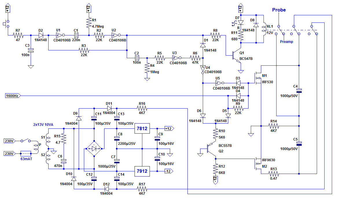

The next and final installment will describe the degausser and supply circuit:

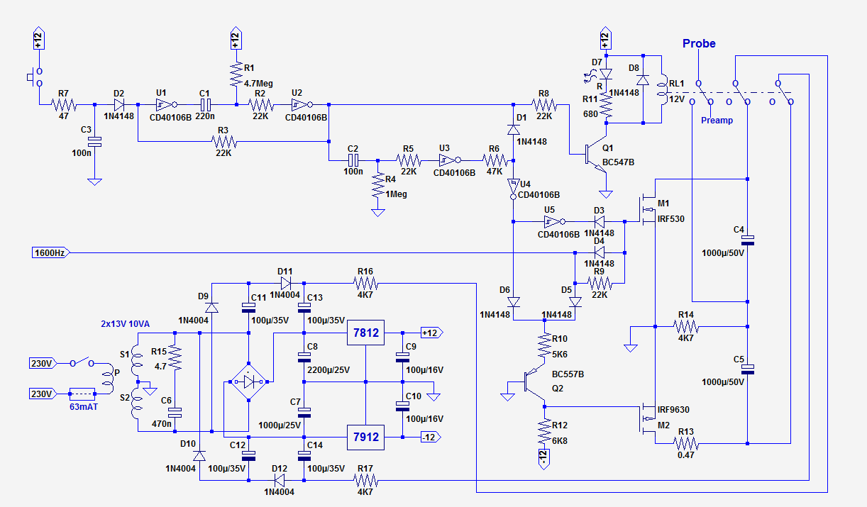

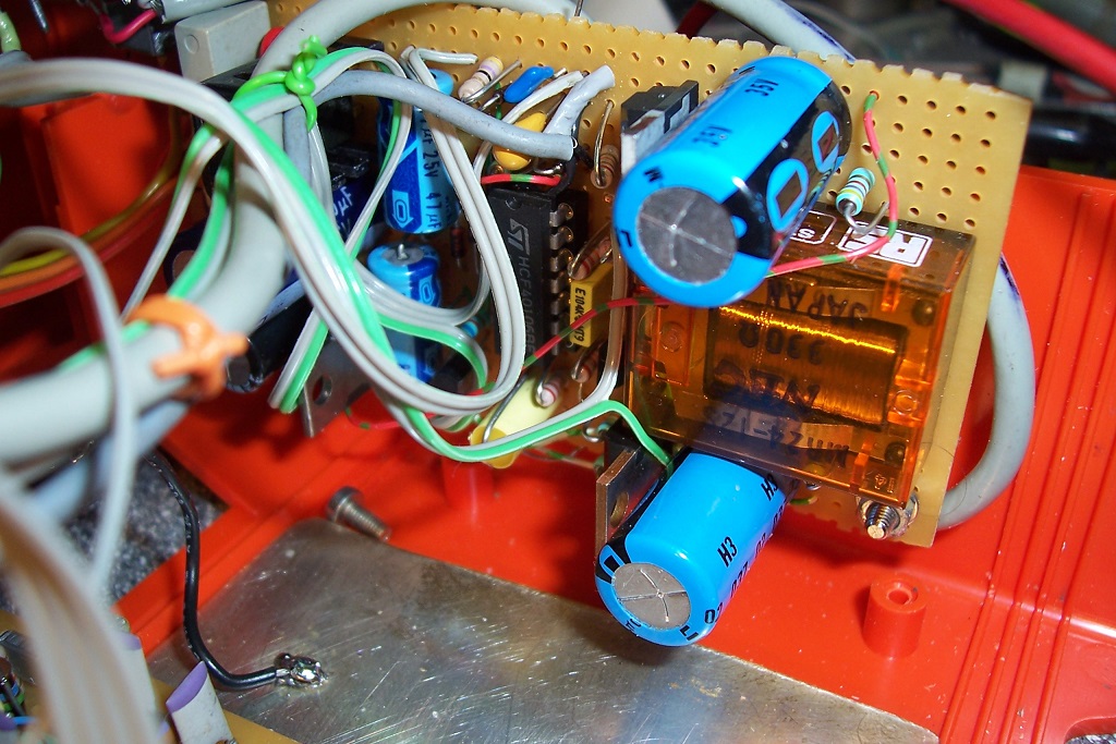

Supply/degausser:
The core of the supply is completely standard. Things become interesting with the voltage multipliers around D9 to D12: they bring the voltage on R16/17 to ~ +/-45V.
After a sufficient time, C4 and C5 are charged to this level.
When the degauss button is depressed, a one-second one-shot is launched, closing RL1. This disconnects the charging circuit and the probe from the fluxgate, and connects the degausser instead.
After a 100ms delay allowing the relay to settle, the 1600Hz gate opens and the degaussing process begins.

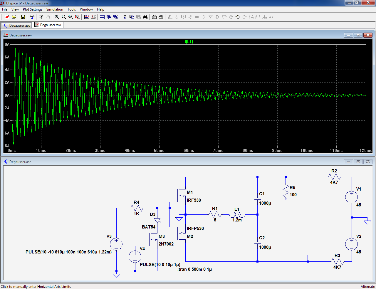

Initially, the peak demagnetization current reaches ~9A (5Ω of the probe/45V), and decays exponentially.
Such a high value may seem widely excessive, but it only lasts a few hundreds µs at a time, and it is required for optimum efficicacy.
Initially, I had tried lower levels, but it wasn't satisfactory.
I had also tried a 800Hz frequency, but the end result was rather random, indicating that the first half-cycle took too long, discharging the caps excessively and magnetizing the probe. In fact, 3200Hz might even be better, but that output doesn't exist on the CD4060.
Anyway, the 1600Hz works fine enough.

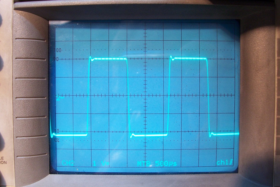

Below is an outlook of the current during the demag.
This degausser is very convenient compared to the original instrument's solution, but it has some limitations: even with this high level of current, only the parts very close to the windings can be reached, which means that if the outer µ-metal shell has acquired some remanent field, this degausser won't be able to reach it, because it is too far, yet this parasitic field will be sufficient to skew the zero.
In such a case, a traditional degaussing is the only solution, but it will normally be very rarely needed: in order to create an unrecoverable remanence, I had to touch the probe directly with a neodymium magnet, something that is unlikely to happen under normal circumstances.
Note that there is no need to remove the probe from the circuit during the degaussing, but the circuit should preferably be off: if a significant current circulates during the demag, the zero will tend to align with this current (which is logical after all).
Even with these caveats, this degausser remains a very useful and practical option
