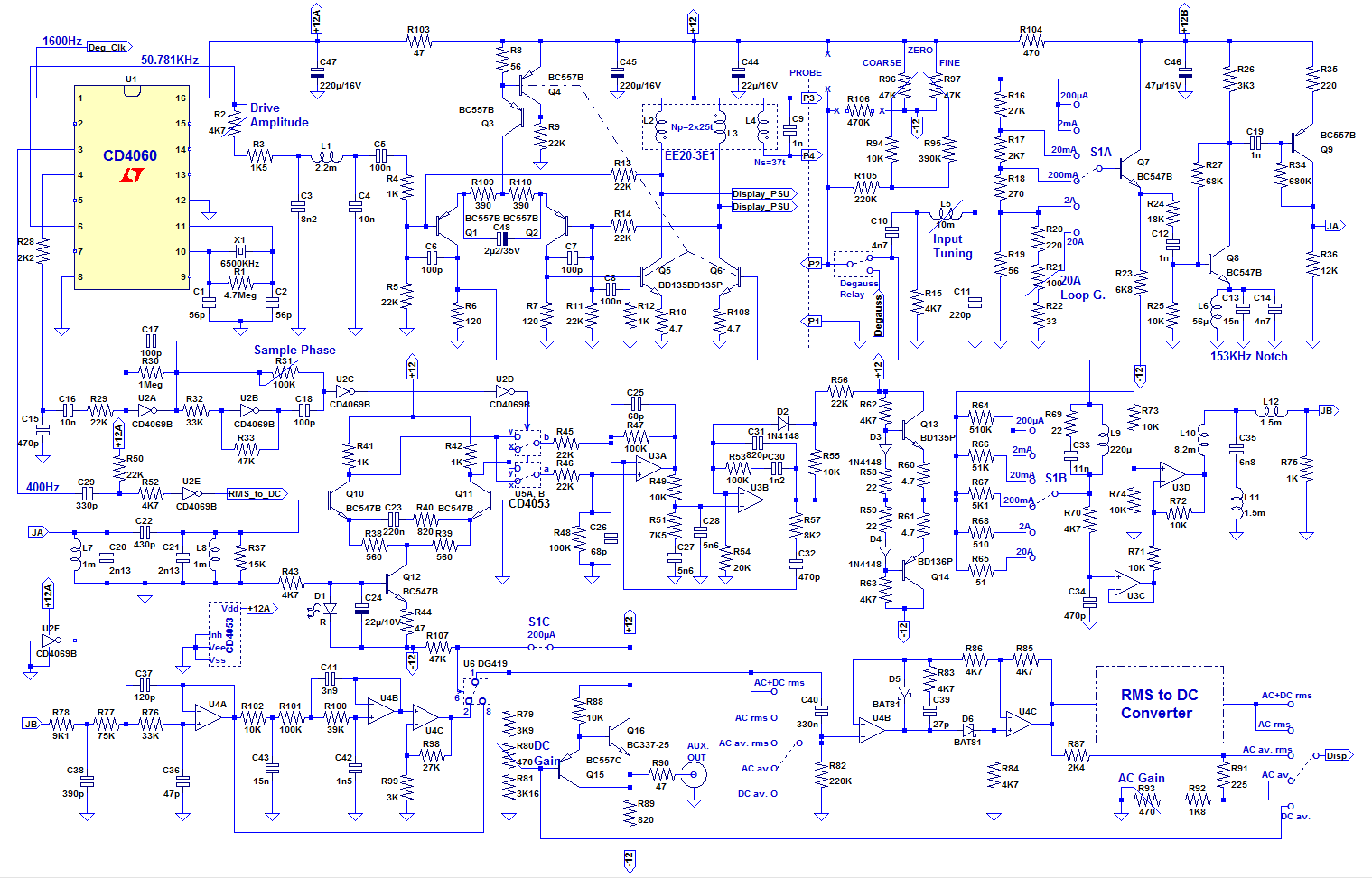

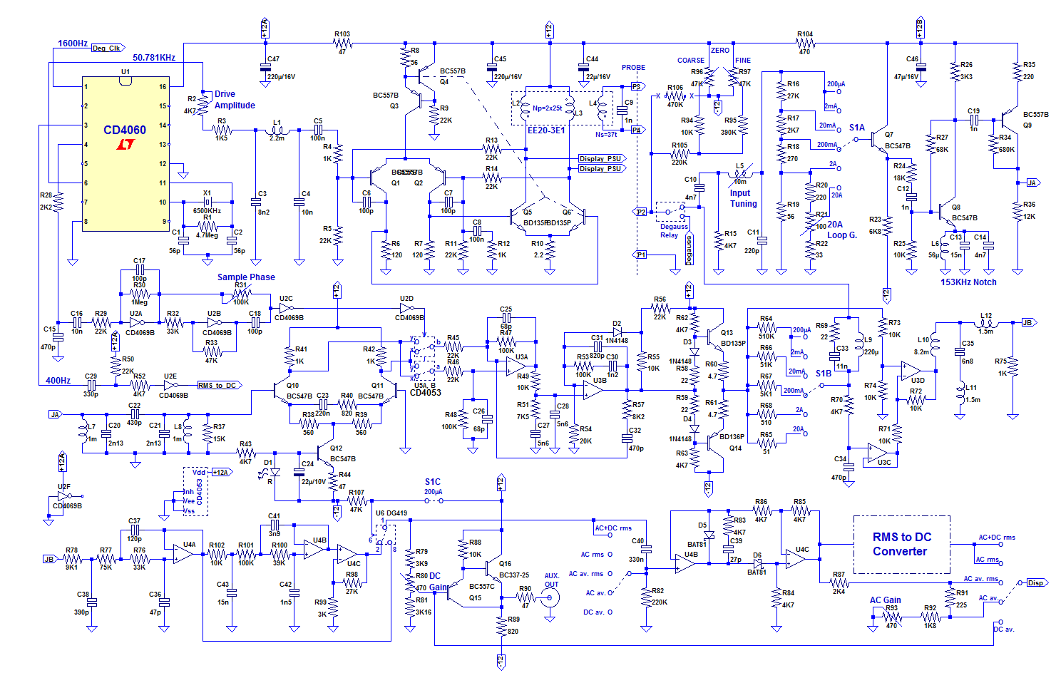

Here is the revised schematic, and a tentative alignment procedure.
The revisions concern mainly the addition of two resistors in the emitters of Q1/Q2, and the splitting of R10.
The resistors for Q1 and Q2 are mandatory, the other mod is just recommended, but is somewhat beneficial too.
If you find difficulties applying the alignment procedure, let me know, I'll try to revise it.

Hello everybody. I didn't post anything so far on this forum but i take a peek now and then.
Couple of years back i saw this topic and bought HP probe that i hope is working, i don't have anywhere to test it. I checked it with DMM and both coils are ok, but ofc i won't be for sure until i build this instrument and plug in probe.
Now let's get back on topic. Since i saw this schematic i had a plan to make a PCB to make things easier for those that wanna build this.
I started to draw schematic in EAGLE but i have few questions about it cause some elements are not marked. I tried to compare schematics to pictures on first page and made some conclusions but this is electronics and if you are not sure in something better to ask then to watch white smoke after you turn on device. 😀
So let's start with questions. Looking at schematic from post 29 i got few questions. OPamps are not marked and looking at pictures of completed device i made some assumptions. U3-LF347, U4-TL074, U7-TL072,is that correct?
Next thing that is puzzling me is cd4060 400Hz output that goes to RMS to DC converter, where that thing goes? I know you said true RMS to DC converter you used is proprietary circuit and we can use some other but i checked some true RMS to DC designs and didn't saw input for some extra signal(like yours 400Hz output from 4060).
Last thing is related to U5-CD4053 and U2D-CD4069 output which goes to some pin on 4053 but i coudn't figure out where it goes.
I think that would be it for now, when i complete schematic i will start with layout of PCB. That will take some time cause this is great project that deserves really good layout.
Once again thank you Elvee for your effort designing this and i hope that once i finish layout somebody will have a good use of it.
Best regards,
Davor
If you test the inductances of the coils and find them similar, and if the probe is in a good mechanical condition, chances are it is OK
They can all be of the TLOxx series, or the LFxxx series, or any similar biFET amps.
Note that many non-FET amps will also work, if they have similar or superior characteristics (without excess though).
You are free to arrange the operators as you find convenient, or you could use duals everywhere if you find it more convenient, etc.
That's precisely because it is my proprietary design....
In your case, you can omit the components around U2E
It goes to the two control inputs of the switches in question A and B: 11 and 10.
Here again, your are free to arrange the operators as you prefer
Yes, and keep in mind that one the difficult aspects of the projects is the inductive components.
If you have little or no experience with this type of component, it would be imprudent to embark on such a project.
Also note that the absolute value of the 6.5MHz is unimportant: only a half-decent stability is sufficient (a good LC oscillator would also work).
A deviation of +/-2% on the absolute value is acceptable.
I am sure many people will
