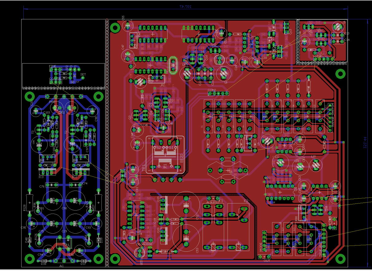

A bit more progress with layout. You can see main circuit board and other ones that you can snap off from it,such as power supply, preamp. I'm still not sure what i'll do with zero adjustment part which is now above PSU, shall i add it to PSU board or make a mini-PCB that you attach to potentiometer.
TrueRMS circuit is gonna wait a bit cause Sreaves is quite busy atm. I'm hoping it's not gonna be big so it can fit in upper-left part of PCB.
Until then i'll need to check track width,make design rule check, fix silkscreen so it doesn't overlaps and you can read it without problem and lots of that small details that i usually don't do cause 95% PCBs i make are single sided and i make them at home. So no silkscreen,no soldermask,etc... :D

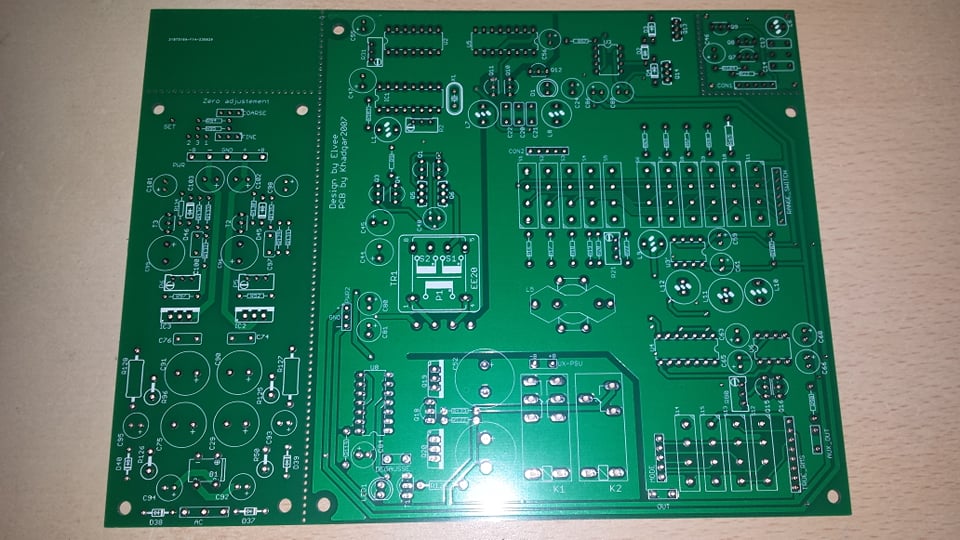

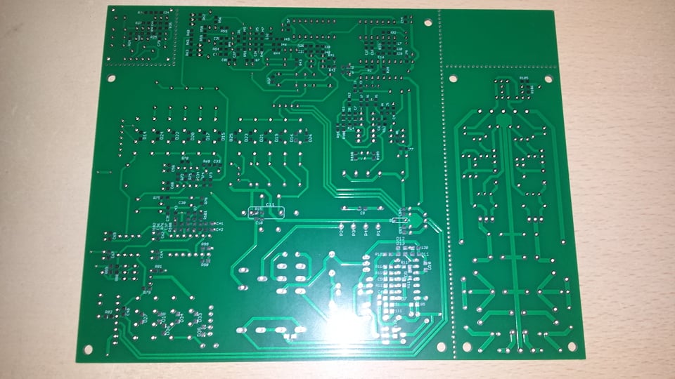

Hello people. It's been quite a while since i finished layout but i didn't ordered PCB until now cause i was hoping i'm gonna design trueRMS converter in shorter time and added it to main pcb layout. Sadly that didn't happen so i ordered pcb's without that part. PCB for converter should be simple so i will diy it at home when i get to that point.
I got couple of jobs that pays bills that need to be done so not sure when i'm gonna start this interesting project. Maybe i'll start soldering bits and pieces together when i get some free time.

I would consider selling them but first i would like to built one and see if pcb works as it should,you know routing gods can be very mischievous and this was not simple project so i would like to be first one to test layout.
And since Elvee was so nice to share it for free i will share entire documentation eagle,gerber files once i have tested it. But since i will have extra three pcb's i would like to sell them so they don't collect dust somewhere in corner.
Btw last time i checked jlcpcb charged some big extra money for v-groove cuts so i made lots of holes for snapping little boards of main one. In theory that was ok idea but in practice i will need to use some tool to cut them off. These chinese fr4 boards are really solid build.:cautious:
edit: I just did two cuts with sharp knife over holes on boths sides of board and it snapped like nothing so i guess idea wasn't that bad.

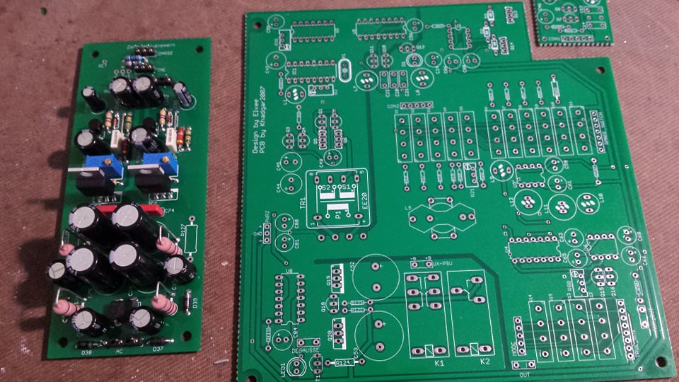

A progress, or actually one step forward,two steps back. :ROFLMAO:
PSU was assembled and i was trying to test it when things went south.Lesson learned, when Elvee says put general type of caps in d-noizer then put them,not Panasonic FR ones... I have one d-noizer that is working and it's in my low thd signal generator so i compared those two. I have found that i put Panasonic FC caps in one that is working, i guess i'll buy some FC series caps for this cases where i don't need low esr.
Here is PSU that worked like charm from moment i soldered last component. Actually i have one FR series cap and it's in feedback line from PSU output.
Here is one that didn't worked like charm, took me half morning to figure out what the heck was going on...
EDIT: Btw i have loads of polymer hybrid caps(Panasonic ZA) in that signal generator as decoupling for all IC's and it seems d-noizer works like a charm as long you have some longer wire and resistance between those two.
