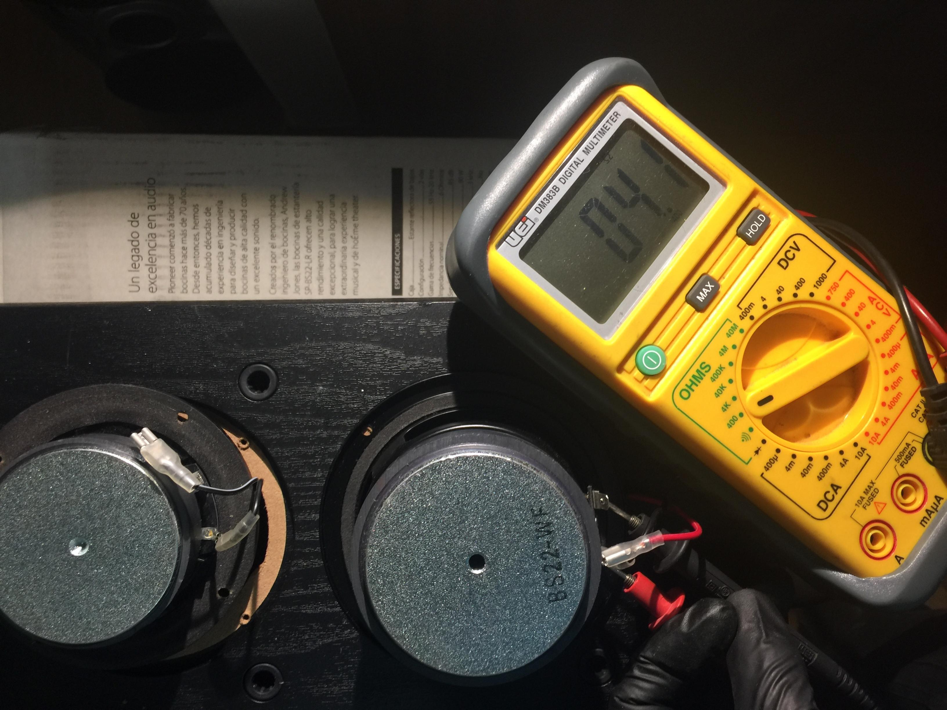

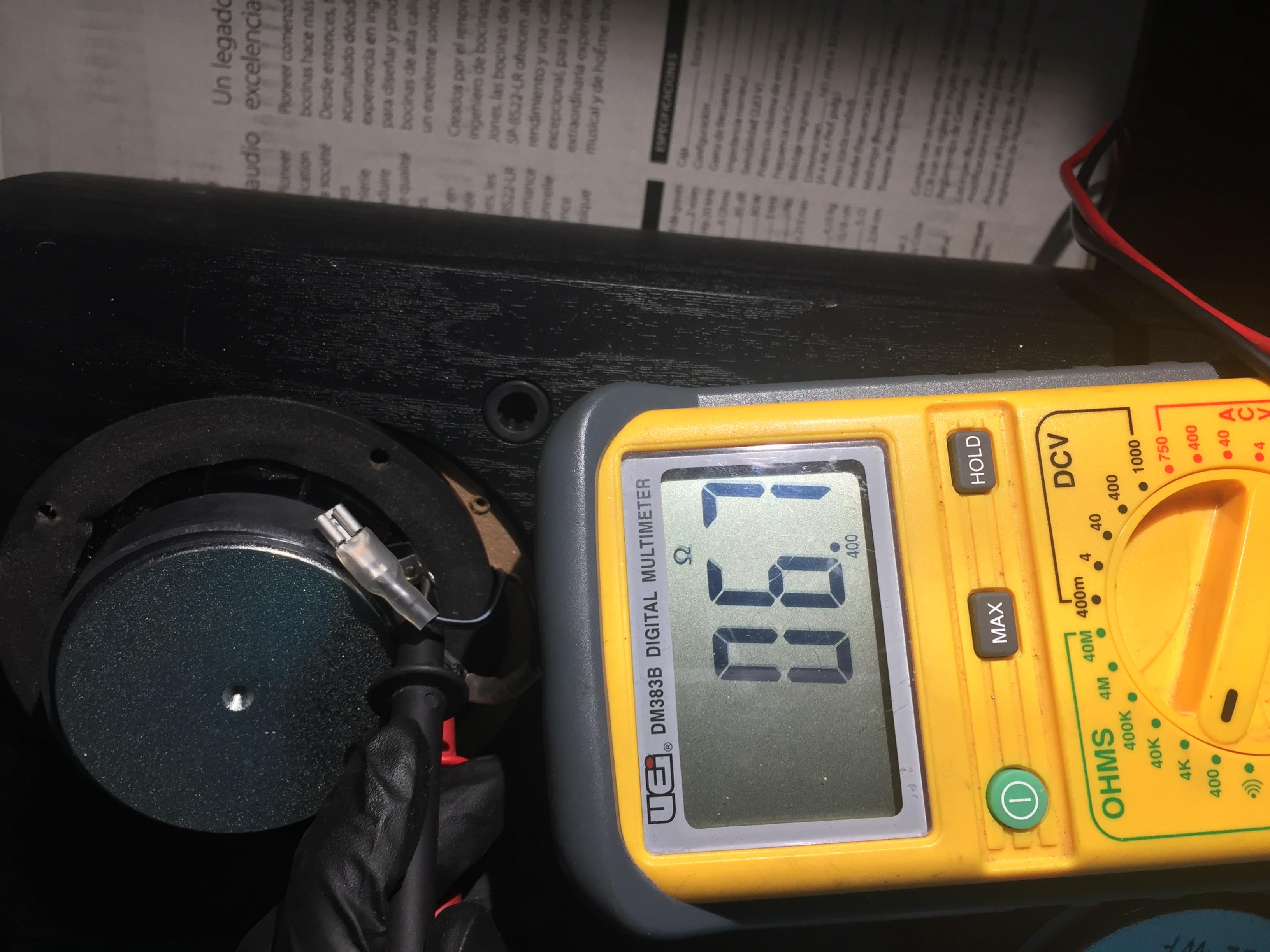

From photos can anyone tell if parts have been changed
From the photos above with somebody with experience doing the modifications that were mentioned another posts can you tell if the speakers or the crossover circuitry or components have been changed from earlier manufacturing dates .
It now looks like the $66 I spent was just for the cabinets and I will be pushing ahead the modifications that were mentioned another post by replacing the tweeters even though these Wolfers are working they were so hot and smell like burnt plastic I will also be replacing them with something better I will read through the posts for a suitable upgrade . Yesterday after my initial upset and disappointed in these pioneer speakers performance I’m a little more levelheaded and calm down today and will just chalk it up as experience and there must’ve been something wrong with the crossover speakers and if I could buy these again for somewhere around $60 or less from another supplier or even Best Buy if they do matching of prices I will purchase another pair for testing . Because if these initial speakers are as good as everybody says they are from all the reviews then post that I have read these would make excellent Christmas or birthday vgifts at the $60 mark or below for teenagers or younger nephews and nieces and young cousins that was my intention for the speakers .
The hot melt glue on the underside of the crossover board does not look stock. Perhaps the crossover was tampered with. My suggestion is to do the "Dennis Murphy" mods (good tutorial on audiokarma and audiocircle by MCM_Fan) if the woofers test okay. Firstly, you need to disconnect the woofers from the crossover and measure their resistance, in the picture you are measuring connected to the crossover. I can't recall what they should be, but if they measure the same, should be okay. The tweeters are discarded and some crossover components are re-used for the mod. These will end up sounding great, they are my garage speakers and probably get more use than any other speaker in my house. A nice little project that yields great dividends. BOM for mods attached.

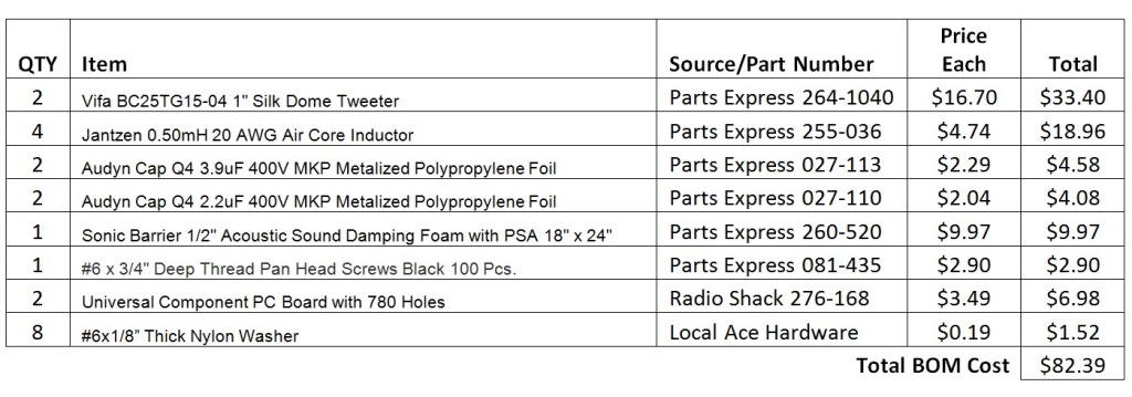

Thanks for posting. Are you going to do the Dennis Murphy mod? For under $150, don't think a better sound speaker can be found. Very tempted to buy more speakers I don't need.
There is currently a super clearance deal on the DCM TP160S on eBay- $79.99 shipped. The modded Pioneers would almost certainly sound better, though.
I will do the mods
I too wanted to buy extra speakers just because the price was so good I can give them away as Christmas gifts.
I will probably do the sound deadening mods to the cabinet treatment first because I already own all the materials even some more high-tech sound absorbing deadening material then was listed in other mods.
No matter what you end up spending more in the mods then the speakers cost but at $48 I don’t feel so bad now.
