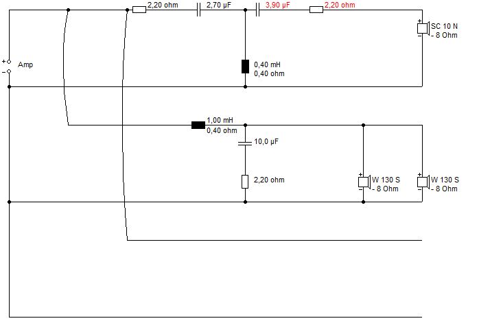

I spent more time on the Pioneer SP-C22 centre. The Dennis Murphy plan seems to be add a 3.9uF and 2.2R. It fills a serious crossover hole by going third order and tames the top end. Whether you substitute the Vifa BC25TG15-04 is up to you:

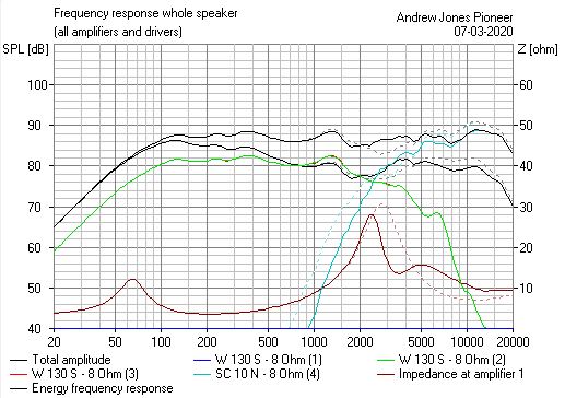

My question: if playing with this in Boxsim, where do I get the driver characteristics? Is there a basis for choosing the W130S and SC10 for which data comes with Boxsim?

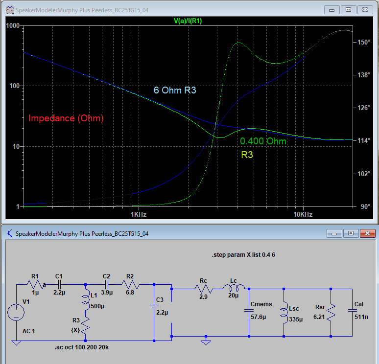

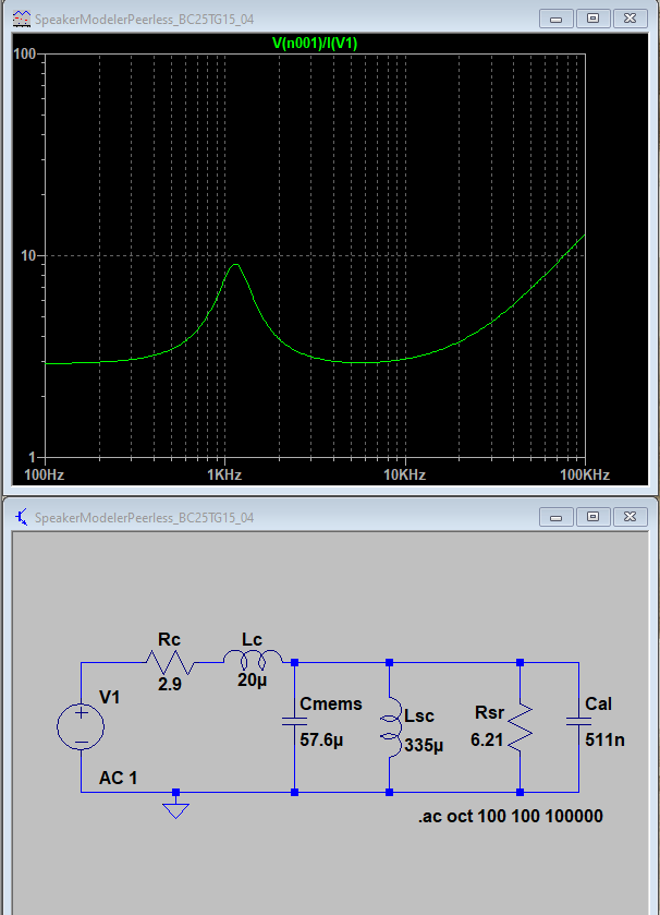

Modeled BC25TG15-04 Impedance:
So the impedance-model for the Peerless tweeter looks OK, I joined it to the Murphy XO and found that adding more resistance to the inductor L1 significantly smoothed the electrical impedance in simulation.
Will have to see how this works in real life.

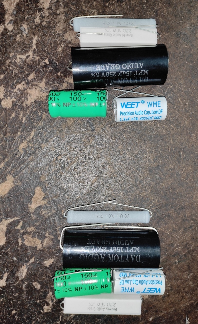

Pioneer FS52 crossover - Modification
C1 - 1.8uf
C2 - 15 uf
C2 - 150uf
L1 - 0.39mh ( air core)
L2 - iron core (didn't measure)
R1 1.8Ohms
R2 2.2 Ohms
R3 3.9 Ohms

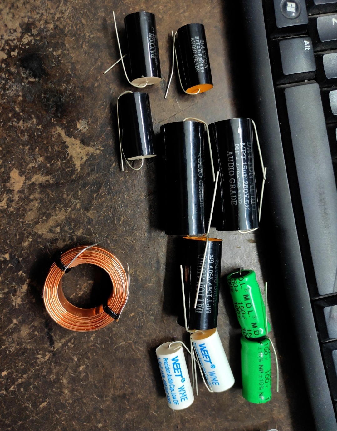

I am trying to replace the capacitors and resistors with Audio grade components
C1 - 1.8uf
C2 - 15 uf
C2 - 150uf
R1 1.8Ohms
R2 2.2 Ohms
R3 3.9 Ohms

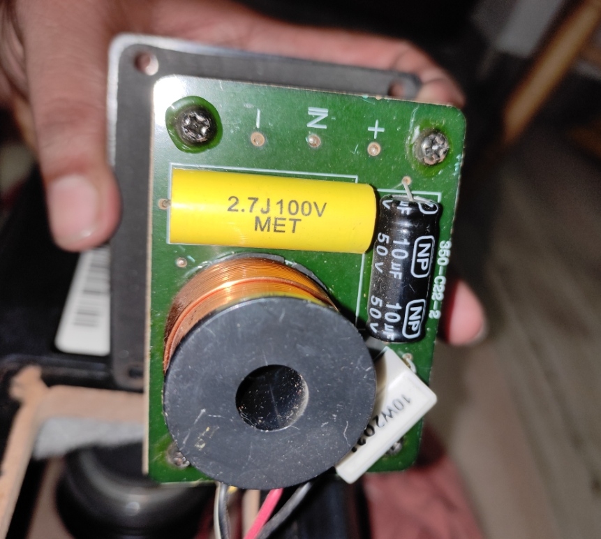

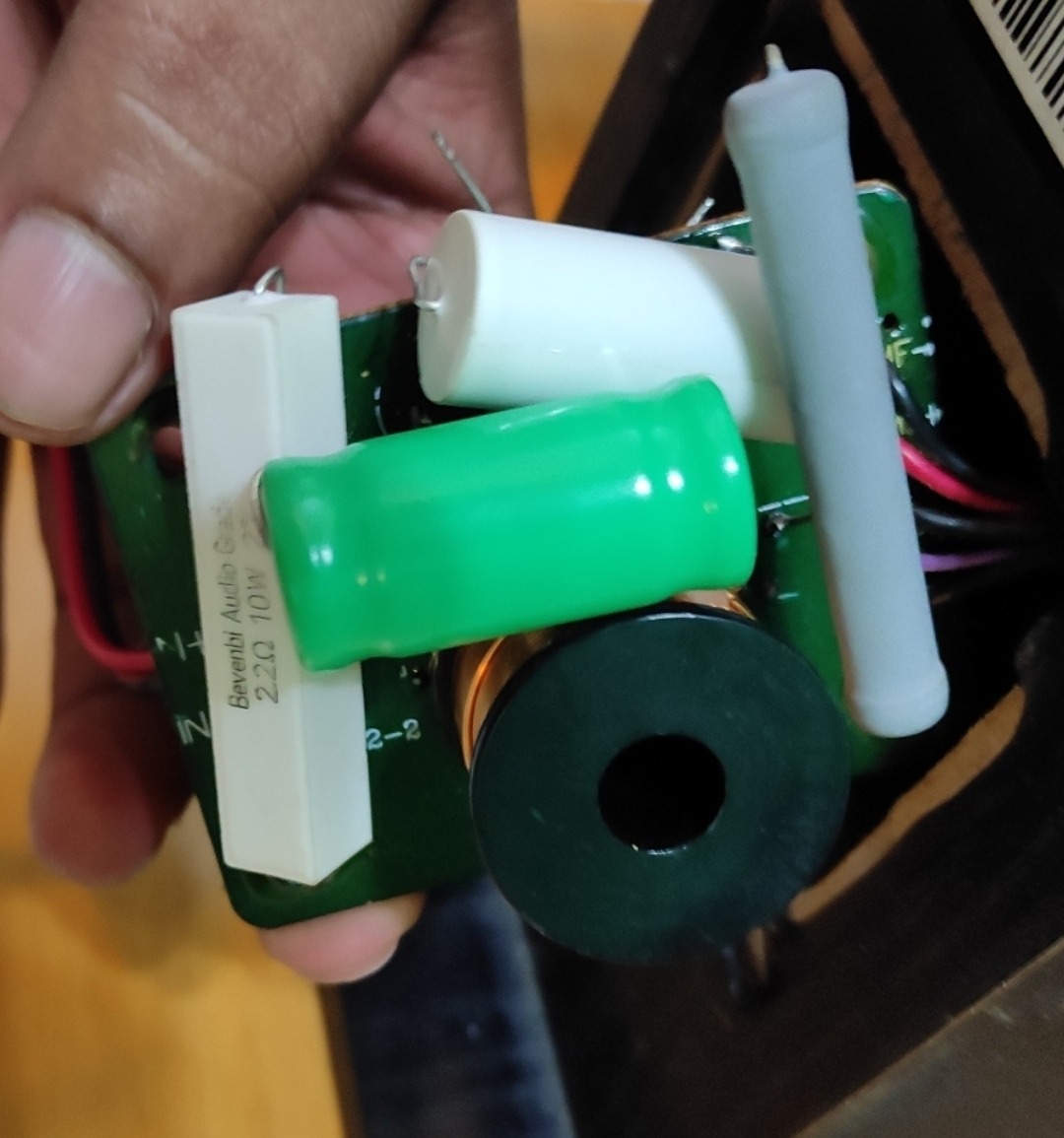

The above components are used in the current crossover for fs52. My friend is helping me to replace it with a good parts. The nuts used for crossover are very low quality ,it just broke while try to open, it's rusted and easily snipped . The binding plates are plastic not made of metal.

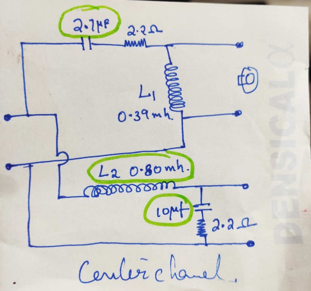

Center channel drawing with existing tweeter, FS52 cap and resistors are also changed.
The cabinet is weak and has low dampping, if u can use noress inside,it would be good.this center channel has a limit,so always set these speakers as small and crossover at 120 above

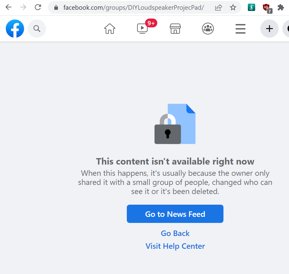

Post that on DIY Speaker Project Pad (facebook page)
I'm sure you'll get a response.
I'm still salty that they banned me

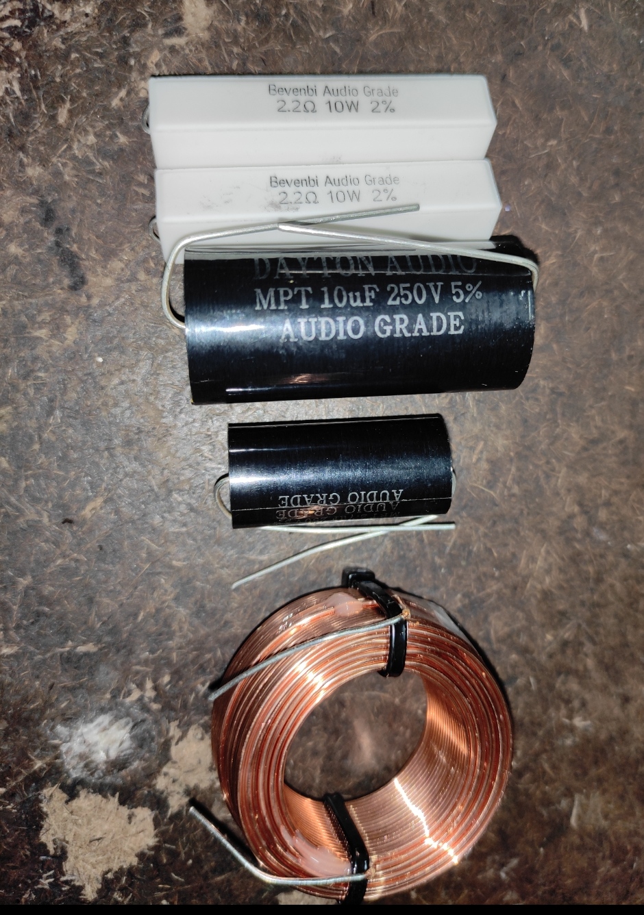

Didn't wanted to spend more money on tweeter and crossover parts, the crossover in the center channel caps is so cheap when I try to remove it just deteriorated . So in spent less amount on Dayton caps and resistors.so no one has figured out the peerless tweeter crossover...
