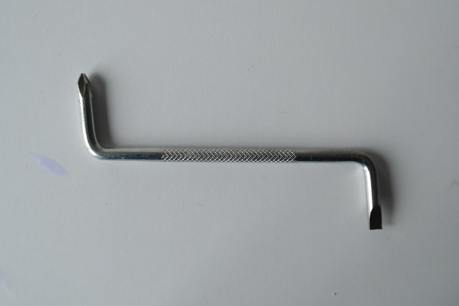

This is what I used.
It cost less than $1 at a local hardware store. Its a bit more fiddly than a normal screwdriver, but it gets the job done.

Looks kinda like an IKEA tool. 🙂 You won't be able to get a lot of torque on the mounting screw with that, unfortunately. A hex key or Torx would be much better.
Tom
How much torque is needed? - we aren't tightening cylinder head bolts!
I just tightened the screw until it was firm. To go any further would have risked stripping the aluminium threads.
Its a trivial tool, for what is essentially a trivial job.
It may not be a cylinder head, but the THD does degrade if the LM3886 isn't firmly fastened against the heat sink. I know because I've measured it...
As long as you can get enough pressure into the screw head that the tightening tool doesn't slip, you should be fine.
If I'm going to the hardware store to buy another tool, I might as well just pick up the socket head screws like Joseph K suggested. 🙂 Better solution. Better tool for the job.
Meanwhile, my solution of creating a stud from a longer machine screw will work too.
