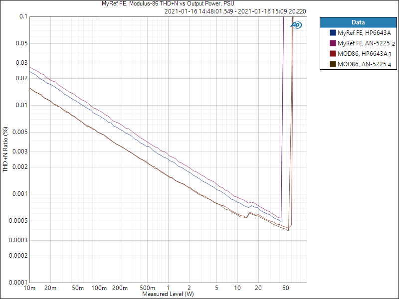

The graph shows the THD+N vs output power for the MyRef FE and the Modulus-86 when powered by a pair of HP 6643A lab power supplies and when powered by a 2x25 V Antek AN-5225 power transformer.
You can find the rest of the measurements here: Review: MyRef Fremen Edition / MyRef FE – Neurochrome
Dario read through my review immediately after its publication and provided feedback, which I integrated. He also requested that I commented on the Build Guide, so I added that section.
Overall, the MyRef is a quite capable amp. It's a bit unfortunate that it has relatively high output noise (69 uV RMS, unweighted). Its high gain (30 dB) will also result in greater amplification of source noise. The MyRef is also a bit sensitive to the power supply as seen in the slight degradation in THD+N when used with the recommended power transformer. I doubt the degradation is audible, but it's a bit unfortunate that some performance was left on the table. I think those who wish to further improve on the MyRef FE can do so by following my recommendations for grounding provided here: Taming the LM3886 Chip Amplifier: Grounding – Neurochrome

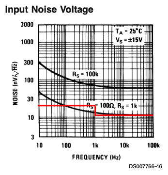

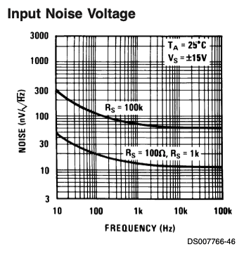

Another possibility for the higher noise floor might be the big input cap ? This reminds me of this old thread : Big film caps and noise

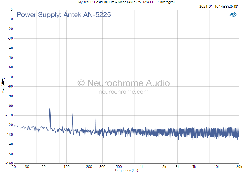

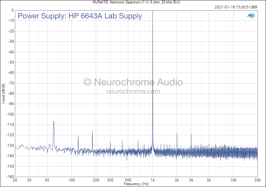

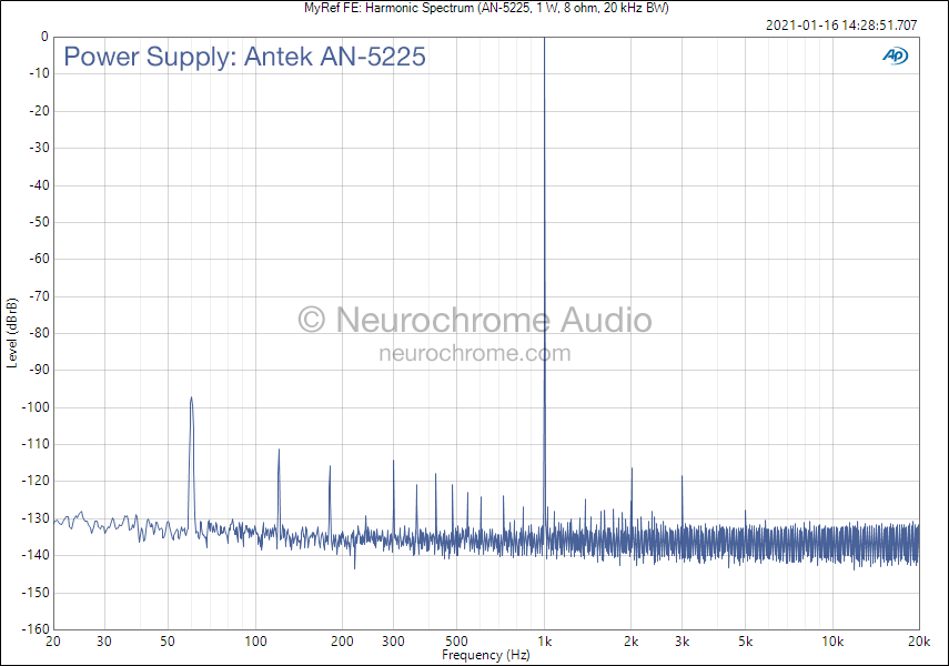

It's a common misconception that film caps pick up noise. They can pick up mains hum and rectification hash, but that would show as an increase in the 60 Hz and harmonics, which does not seem to be the case. In fact, I tried shorting the capacitor by soldering a wire across it. That made no difference. That said, physically smaller is usually better for a wide range of things, EMI/RFI included.
Also, if the capacitor was picking up hum, it would do so even when the amp is at idle, so you would see a degradation in the noise floor when the amp is powered by a transformer. That's not the case for the MyRef FE. Rather the degradation occurs when the amp is producing a signal. That indicates to me that the source of the degradation should be found in the PCB layout.
Tom

A_MyRef FE_ Residual Hum & Noise (AN-5225, 128k FFT, 8 averages).png51.9 KB · Views: 267
A_MyRef FE_ Harmonic Spectrum (AN-5225, 1 W, 8 ohm, 20 kHz BW).png53.3 KB · Views: 268

A_MyRef FE_ Harmonic Spectrum (1 W, 8 ohm, 20 kHz BW)-2.png53.9 KB · Views: 247

The MyRef FE produces 69 µV of white noise at its output. I can hear this with my relatively inefficient bookshelf speakers as hiss from the tweeters. I hear this when I have my head within 30 cm of the speakers.
Unless you believe that 69 µV of white noise from the MyRef FE is somehow different from 69 µV of white noise from another noise source, my speakers will produce the same SPL with the two sources. Implying otherwise would mean that the speakers had some sort of mind of their own or memory that allowed them to reproduce higher SPL with one 69 µV source than with another. That's absurd. Last I checked speakers were linear (relatively anyway), time-invariant, and causal systems.
As we discussed via email, I believe the LM318 is the dominant noise contributor in the MyRef FE. You can find the voltage noise graph for the National Semiconductor LM318 attached here. You can find the full data sheet here: http://www.mit.edu/~6.301/LM118.pdf. The TI data sheet does not have any noise data.
You're looking at around 11 nV/rtHz at 10 kHz and higher at lower frequencies. The calculation gets a bit involved with the relatively high 1/f component, but I think a reasonable estimate is:
En_out = Gain * En_in * sqrt(BW) = 31.62*(11e-9 * sqrt(19000) + 20e-9 * sqrt(1000)) = 67.95 µV RMS
Basically I'm estimating the total noise by approximating the noise voltage as outlined with the red line in the second plot. It's probably a bit pessimistic, but not overly so.
