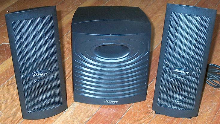

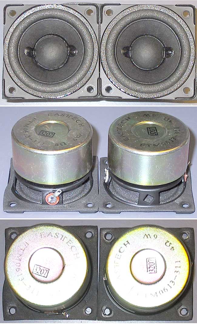

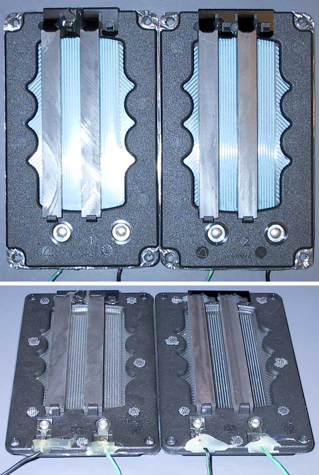

I disassembled many of these and every one had a passive XO (cap+inductor). no pics of one, there are probably still some downstairs somewhere.
Pics of the rest:

thats what i had assumed as well but to my untrained eye they look like svhs connectorsIIRC both the 2 way MH500 statelites anf the 700 panels had RCAs on the end of their cables. The controller had a multipin connector. Pictures?

well i cut the connector off i got 1 red, 1 green, 1 black and 1 white. from trial and error red and green are planar not sure which one counts as black and red on my amp sockets and the little speaker is black and white. these speakers were an impulse buy for my pc but sound decent
If you decide to do something better with those, remove the monsoon logo, its just glued with hot glue. There is one screw under. This holds entire metal grill. However, they use sticky stuff all around, you need to use some force to remove it.
Then you are facing the drivers, each held in place by four screws.

The 3FExx wants a significantly bigger box than the Monsoon has. Not sure how it differs from the many MH-502 i had thru here, but the midrange is more like 2.5”.
It sounds like you want to start from screatch but use the eletrodynamic tweeter? Tou might have sensitivity issues with most 3” FRs. Aura NS3 (Dayton does them now) could use some HF help and is a bass champion. But it needs a biggish box.

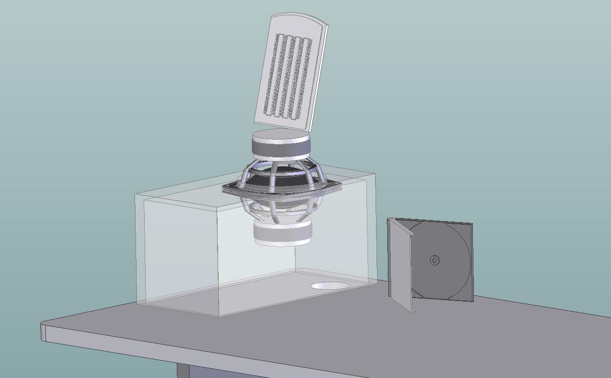

I made this frankenspeaker which has been my desktop mini-monitor for several years - better than my wildest hopes
The base is a radioshack cast alu ported box with a replaced tangband long throw mid-woofer , minor crossover tweaks, the box and planar have great synergy. I did measure this way back but don't have the graphs at hand.
