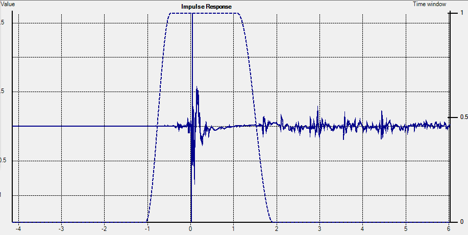

The solid line at the bottom of this measurement of Monster Massive is the THD. (The phase and SPL are also on the same graph.)
![monster-massive12.jpg](https://lh5.googleusercontent.com/-DkOfDfqStmE/VJR4EYQ7PbI/AAAAAAAAJ30/1AWSL9lIsYo/s800/monster-massive12.jpg)
Here's the THD of the SH50. While it's true that the THD of the SH50 is lower, I think it's remarkable that the $20 Vifa and the $30 Daytons keep up as well as they do. This is something I've been saying for a few years; these little Dayton ND91s are beasts. Although they look like cheezy computer speakers, their performance is remarkable for their size and cost.
Ironically, the main source of distortion in Monster Massive is the TC Sounds fifteen!

![monster-massive13.jpg](https://lh3.googleusercontent.com/-Rqw0Nmpv7tw/VJSHA8yvseI/AAAAAAAAJ4E/d9HIbUTAJIQ/s800/monster-massive13.jpg)
Here's a measurement of the Danley SH50, and each one of my Gedlee Summas.
I know what you're thinking, why is there a midrange suckout?
For years I've argued that my Summas sound better at a distance. In Oregon I had a big ol' house, and a ginormous living room for my Summas. Here in San Diego, my home is the size of a postage stamp, and the Summas have been relegated to the garage.
For years I *thought* the speakers sounded better at a distance. Turns out I was wrong. You need to be equidistant from the woofer and the compression driver.

On the upside, there's lots to like here, once you move your mic to the correct vertical axis:
![monster-massive14.jpg](https://lh4.googleusercontent.com/-oKMWL4Dt_Kk/VJSaWsllnpI/AAAAAAAAJ48/soaN2pQejp4/s800/monster-massive14.jpg)
![monster-massive15.jpg](https://lh4.googleusercontent.com/-lYHyhP_voEQ/VJSaWh2FOMI/AAAAAAAAJ44/c3U0IAQGvG4/s800/monster-massive15.jpg)
![summa_FR-s.jpeg](https://www.linkwitzlab.com/images/graphics/summa_FR-s.jpeg)
Here's the unsmoothed polars of my Summas, the smoothed polars, and the published polars.
1) The high frequency directivity of the Summa is superior to the SH50
2) The SH50 has greater output per watt. This is because there are two woofers in parallel at low frequency, and *four* midranges in series-parallel at the crossover. Thos midranges really bump up the efficiency in the midrange, relieving the load on the compression driver. In the measurement above, the Summa and the SH50 are measured at identical "volume" on my amp, but the SH50 is drawing more voltage.
