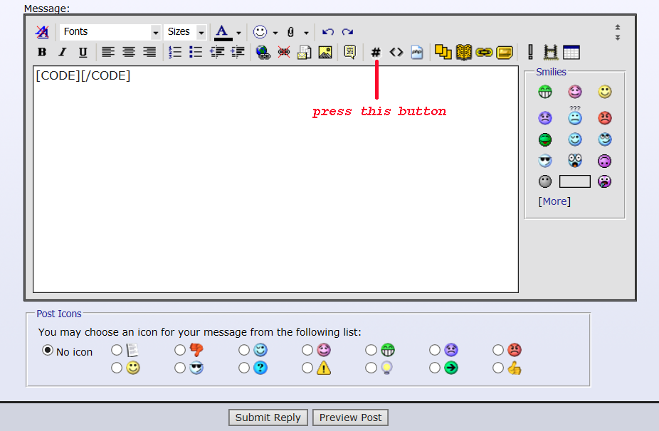

:captain: Here's a posting technique tip from moderation.
When long code is to be posted or long spice models etc. there is the # in the Go Advanced answer menu that wraps code tags around selected text.
So those huge miniDSP code posts could have looked like this (up to 30000 characters long per post).
Code:
