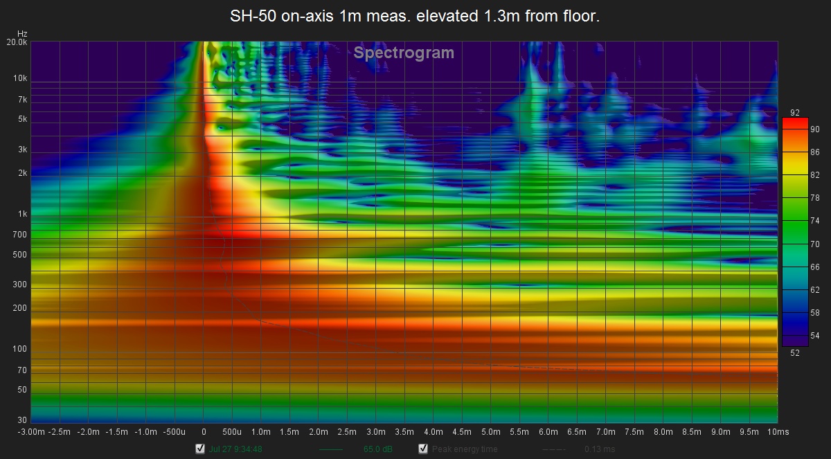

To anyone here that wants to know more about the SH-50 passive crossover, just ask. I'll do my best to answer your questions.I believe the primary advantage of a Synergy Horn over a Lambda Unity Horn is that the Synergy xover includes some little-discussed features that aren't in the Unity horn. (It's in the patent, hint hint.) Also, if I'm correct about the Lambda Unity Horn, then there's real potential to turn it into a world-beater by revising the crossover while using the same drivers that it came with. The Unity horn concept came a long way between the premier of the Lambda Unity horn in Y2K and nowadays.
I believe that when you look at the spectrogram of the BMS 1" driver, that will begin to answer your questions. When you look at the level of chattering present above 10 kHz and the overall impulse decays above 4 kHz, that will give you a strong clue (the SH-50 crosses at ~1350 Hz to the midrange drivers):I think the treble of the Waslo designs is superior to the Danley designs, but the Danley's image a little bit better. I think the reason the treble on the Danleys is a little rough is because the midrange taps are significantly larger than the Waslo designs, and I think that's impacting the treble. Danley doesn't really have a choice here; he's selling a high-output design and if the midrange taps were smaller it would limit the output.

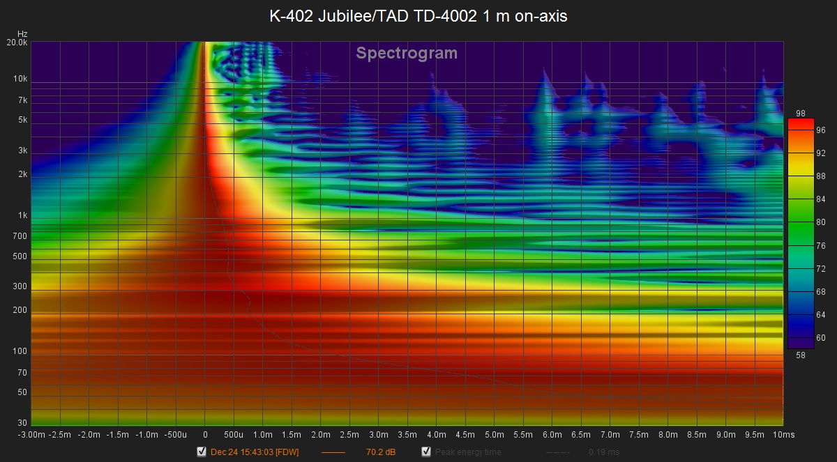

Here's a spectrogram of a K-402 two-way Jubilee 1 m on-axis (in-room) with TAD TD-4002 driver for comparison. Note the smoother and much more uniform decay vs. frequency, as well as the only artifact of the impulse event--mouth bounce of the K-402 itself at 0.7-1.2 ms:
If you feel the SH-50 disappears into the room, then you should hear a pair of Jubilees (well set-up). The effect that you mention is heightened even further than the SH-50 in my experience. My border collies sleep on their dog beds in front of the Jubs and K-402-MEH. The sound is still "diffuse" even though you put your head into the mouth of the K-402-MEH.Possibly the weirdest thing about the SH50 is that it's really difficult to perceive where the soundstage begins and ends. I've never heard a speaker like that. I've told this story a million times, but when our twelve year old daughter was sitting THREE FEET away from a Danley SH50, she asked "is it on?"

I think this effect is caused by two things. First, the crossover. Second, the midrange taps in the Danley products are *much* further down the horn than in the Cosyne. In the Cosyne, it's two inches, in the SH50, it's 3.5". In the Small Syns, it appears to be about 1.75"
So you have this situation where the wavefront that's produced is in-phase, but the *sources* of that sound are radiating from three points in space separated by almost a FOOT in depth.
