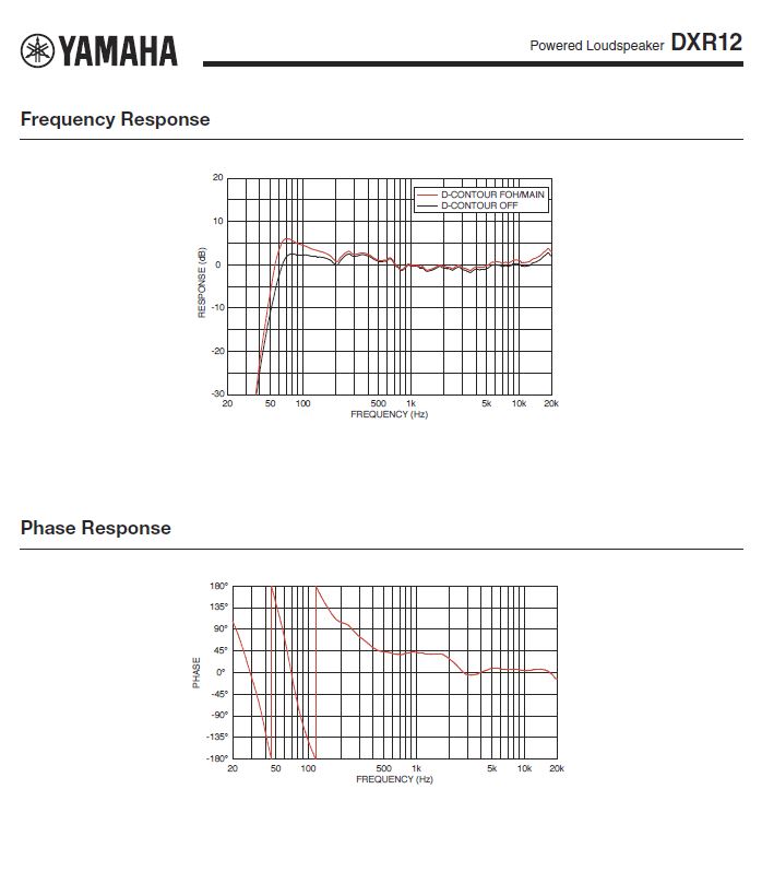

So basically there's a series of things happening in the Yamaha's midrange that might be impairing things:
1) possibly a steep xover, which is also complicated by it's use of FIR filters
2) diffraction off that sharp cabinet edge
3) my walls are 100% untreated, and according to cask05's wiki, I need to address that
4) the Yamaha fits very tightly into a corner, so reflections off the walls are likely more audible. Or are they less?![]()
I don't think#1) on your list is a problem....
The crossover is at 2.1kHz and whatever order xover is being used, it appears phase has been taken care of via FIR.
BTW, what are you using for a sub, and it's crossover to the dxr12?
