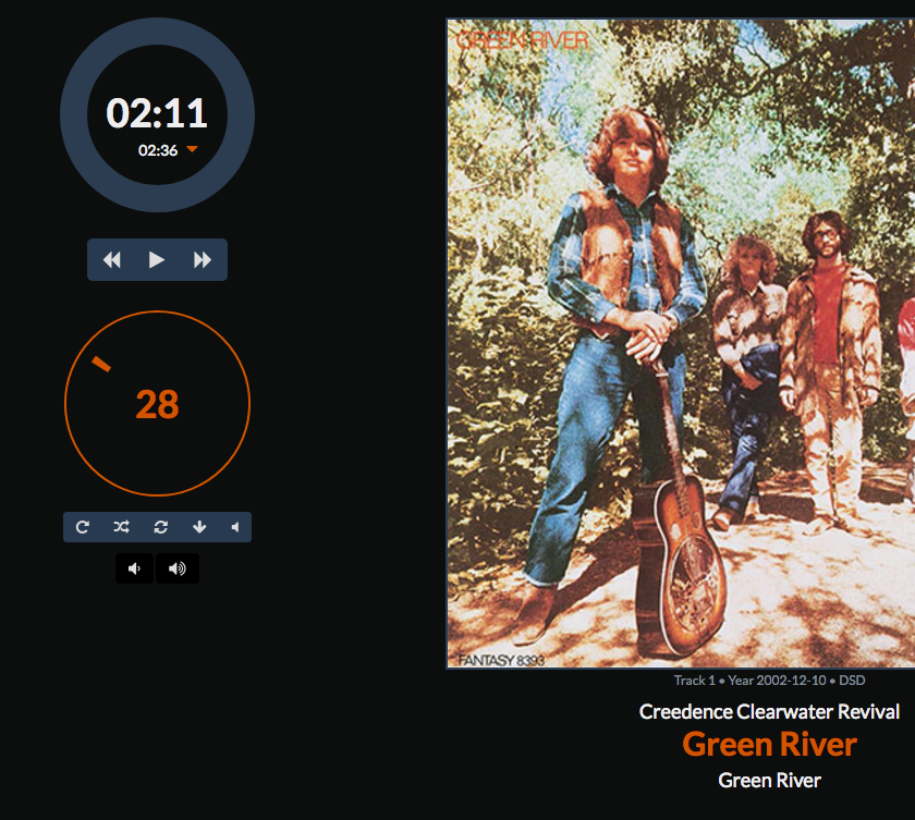

No joy with Piano 2.1 and DSD
Made the suggested changed and rebooted. Added track to playback ( file is on USB drive along with non DSD files. This time the track plays see the screenshot but there is absolutely no sound. Other non DSD files play just fine. I noticed when adding DSD files to playback there is a long delay in loading as well. If there are MPD settings that may need to be changed I am will give them a try.
Thanks again for Pro Tips.
The Piano 2.1 does not support DoP protocol. Set "DSD over PCM (DoP)" to no and you should be all set.
