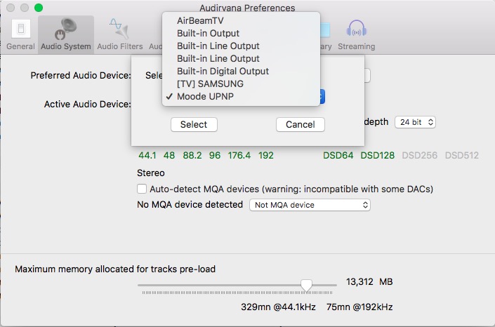

Running beta11 on MAC and would like to enable UPNP so I can play music files in Audirvana +. Thanks to member yannig for letting me know this is possible.
I have turned on UPnP renderer. Is there another step in process to enable Audirvana to see the MoOde device?

@onionhead
You need to select UPnP in Audirvana somewhere in settings. You of cause must be on 3.1 or something higher. If you cannot get it to work, head over to the Audirvana forum.

@onionhead
I also did not know it could be done. In moode you go to config, audio, renderers and activate upnp renderer. In audirvana 3.1 or later you go to settings, audio system, prefered audio device, change, and in the drop down menu you select moode upnp as you can see in the attached picture. Sound quality is as good as playing directly from moode. When you click play in audirvana, moode will start playing. It shows the artwork in the moode playback tab, and on my oled display it shows the artist and song name.
