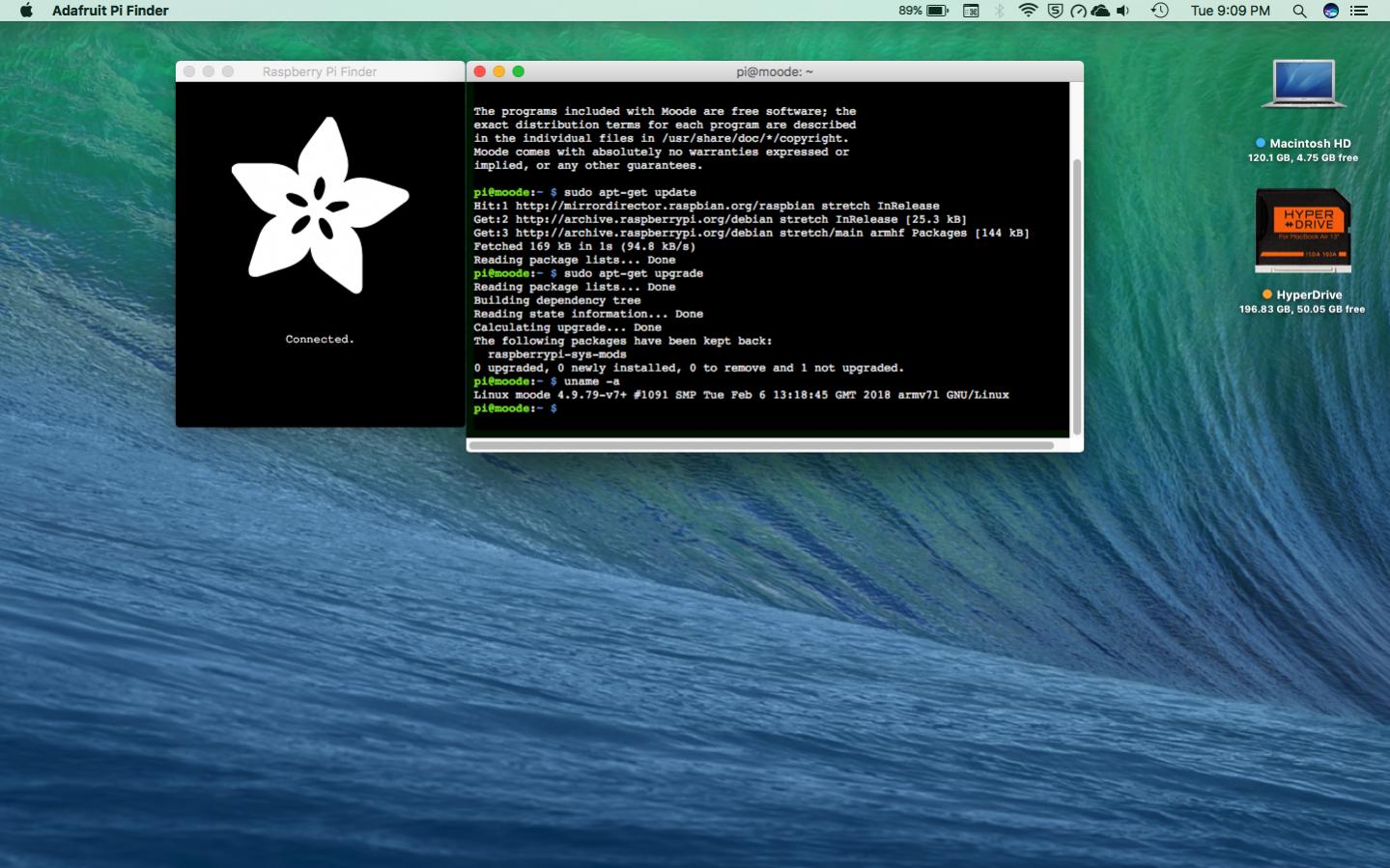

First, just to be sure we're on the same wavelength, you're doing the update/upgrade steps while still on an RPi2B or RPi3B but not the RPi3B+, right?
The update step just downloads information about the packages in the raspbian repositories. The upgrade step then compares this information against the currently installed packages, decides which old packages need up to be upgraded, which new ones need to be installed, which old ones need to be removed, and which old ones can't be upgraded.
Sadly, I didn't keep a log when I updated/upgraded moOde r40 but here's the relevant lines from another raspbian system:
I believe you should have seen similar statistics with even higher numbers. Instead, your report says nothing was done, so the image on your uSD card doesn't contain firmware needed for your RPi3B+.Code:93 upgraded, 0 newly installed, 0 to remove and 1 not upgraded. Need to get 143 MB of archives. After this operation, 375 kB of additional disk space will be used. Do you want to continue? [Y/n] n
And that last line you asked about simply reflects what was said earlier in the process
I saw this too but the result worked for me. Someone with more knowledge of the sys mods than I have will have to explain why they weren't updated (e.g., what the conflict is between old and new packages).Code:The following packages have been kept back: raspberrypi-sys-mods

Kent,
Yes that's right, I did the update/upgrade with the Moode 4.0 card still installed in the Pi3B, then shutdown/took the card out of that board and put it in the new 3B+ board but couldn't get it to boot up.
Upon returning that card to the older 3B board, everything still works fine, it's still a fully functioning instance of Moode 4.0 on that older board.
I'll try it again tonight.

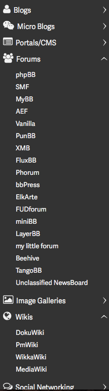

My hosting provider offers forums, wikis, etc via cPanel. I could install any of these into moodeaudio.org but I'd need others to volunteer to do the admin.
Would any of the below work?
-Tim

apt-get upgrade - packages kept back - Raspberry Pi Forums
I have just done the same,
Code:sudo apt-get update sudo apt-get -y upgrade
and had the same result. One package not installed but Moode works on the new pi3b+.
I did not think to run uname -a before the upgrade but this is the kernel it gives me after wards.
Code:pi@moode:~ $ uname -a Linux moode 4.9.80-v7+ #1098 SMP Fri Mar 9 19:11:42 GMT 2018 armv7l GNU/Linux pi@moode:~ $
I'll run the apt-get dist-upgrade on the new pi and see what happens. 😱
Ronnie.
Thanks for this, I just ran name -a and I return a slightly different result (attached).
