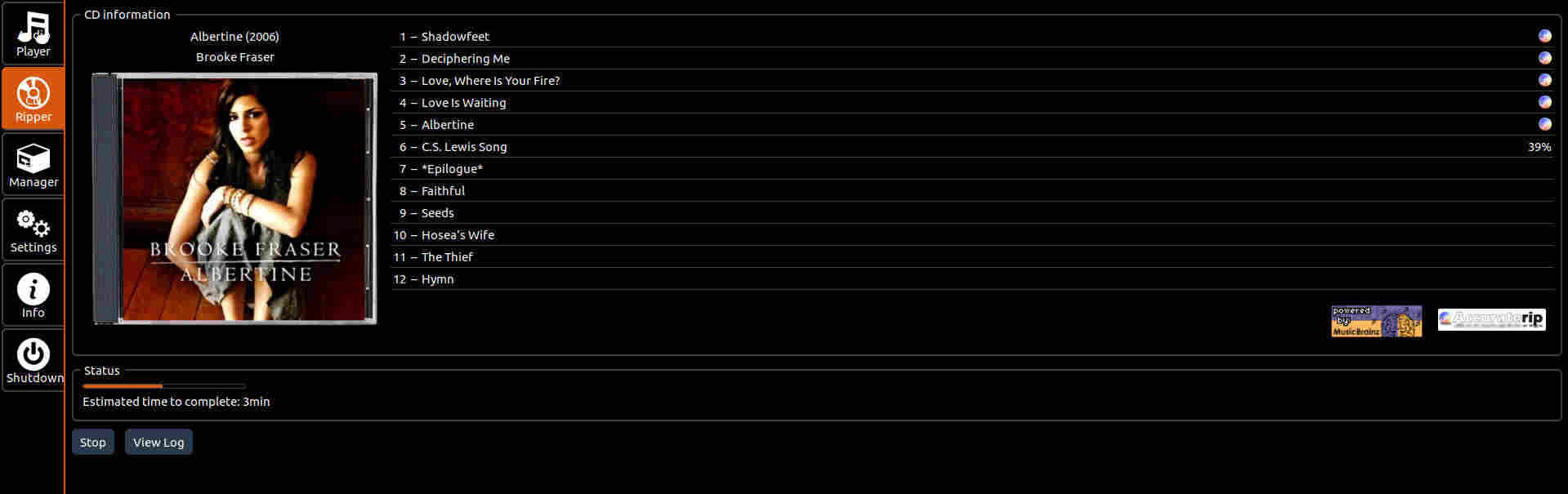

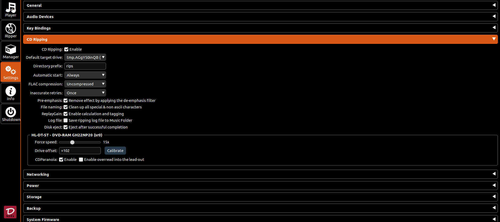

Thanks sjoerdju for the beets info... most interesting and solved a drive full of orphan rips needing artwork.. 🙂
I have since revisited my abcde config and setups..... The time and travails to configure for format, drive offset, artwork etc was becoming onerous with each and every os upgrade...(Ubuntu you need a rolling release ;-) )
Sooooo I downloaded and wrote to a live usb install, Daphile. (sort of MoOde for x86)
It has a ripper that is abcde base, has offset calibration, musicbrainz(s), lookup and 'accurate rip' checking all as checkbox defaults...🙂
I have an old HP t5470 thin client with 2Gb ram and 2Gb flash that just fits daphile.
Add an external cd/dvd drive and configure.
An old laptop or tower would be fine and everything can run from the Daphile live usb so just plug n play for ripping duties.
All headless and independent of main o/s and Moode player. No hit to resources on those setups... ;-)
Thanks @DRONE7, I hadn't considered using Daphile for CD ripping duties. I already have it on USB stick so will look into this. Like you I find ripping with Ubuntu convoluted at times -- I generally end up using MusicBee on a Windows install for that.
