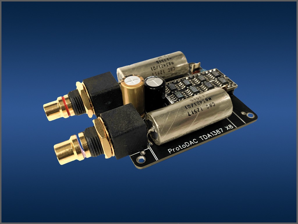

The ProtoDAC section at http://moodeaudio.org has been added 🙂
Visit the Forum for more information. https://moodeaudio.org/forum/showthread.php?tid=5488&pid=46081#pid46081
