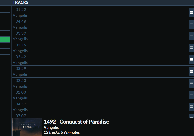

It looks like the library is sorted by the Artist. Is there any way it can be sorted by the album artist?
Are u using Album Artist tag for compilation albums?
Tim
Tim
I have many classical music albums. In my music library, album artist has the superior grouping criterion over artist. If there is only one artist, both fields contain the same data. However, there are many artist names in classical music album such as orchestra name, conductor name and etc.. I'm looking for a way I can group albums by the album artist using Moode Audio.
I just installed the v2.5 and it's working great. I moved from Rune Audio.
Moode Library panel rolls up Albums whose tracks have different artist names into a single album with a virtual artist named "Various Artists".
For example the album named "6 String Theory" has 15 tracks each of which has a different artist. It appears in the Library panel ALBUMS column as a single item: "6 String Theory Various Artists".
When this item is clicked, all the tracks appear with each individual artist displayed.
How do your Classical albums appear in the ALBUMS column?
Tim

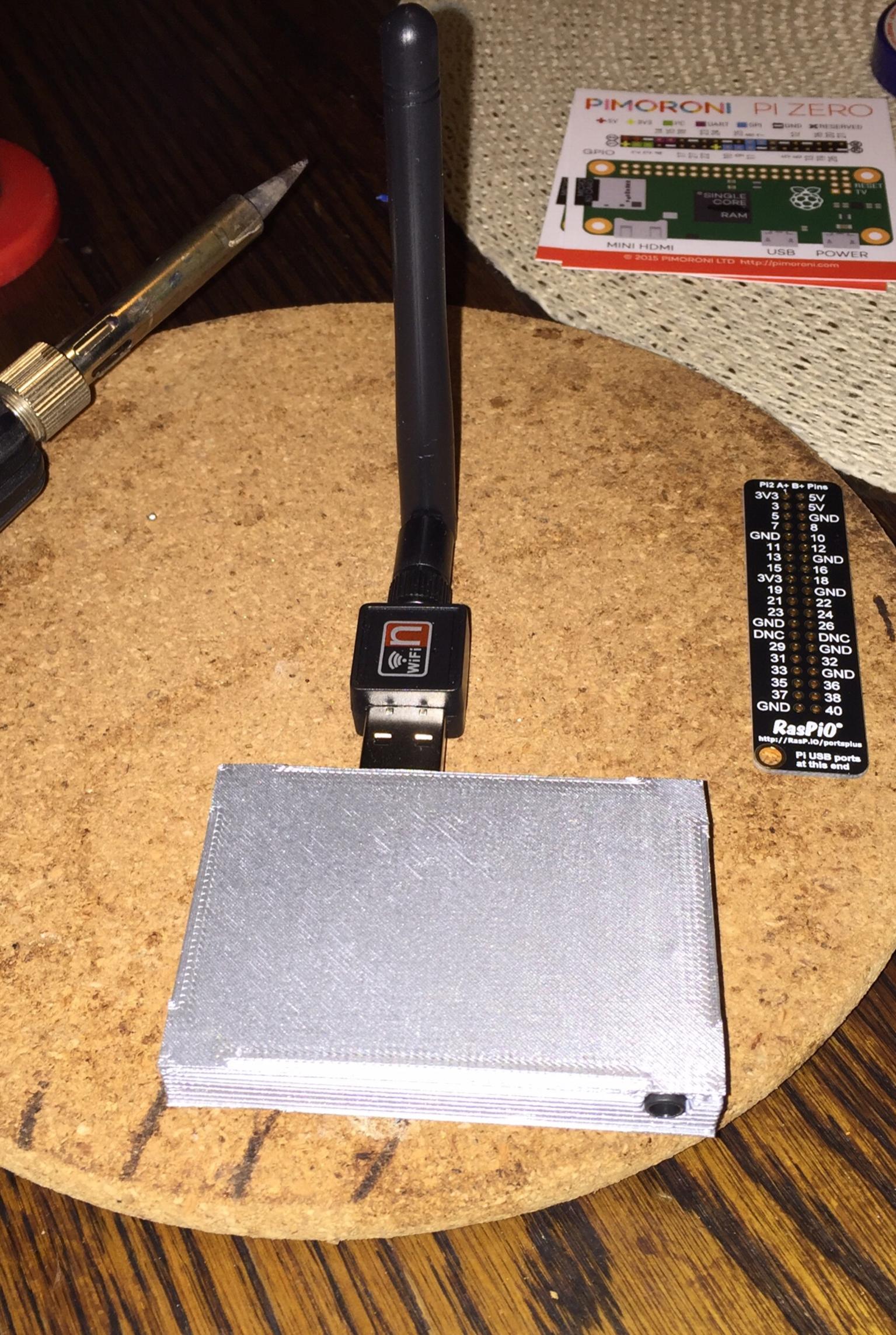

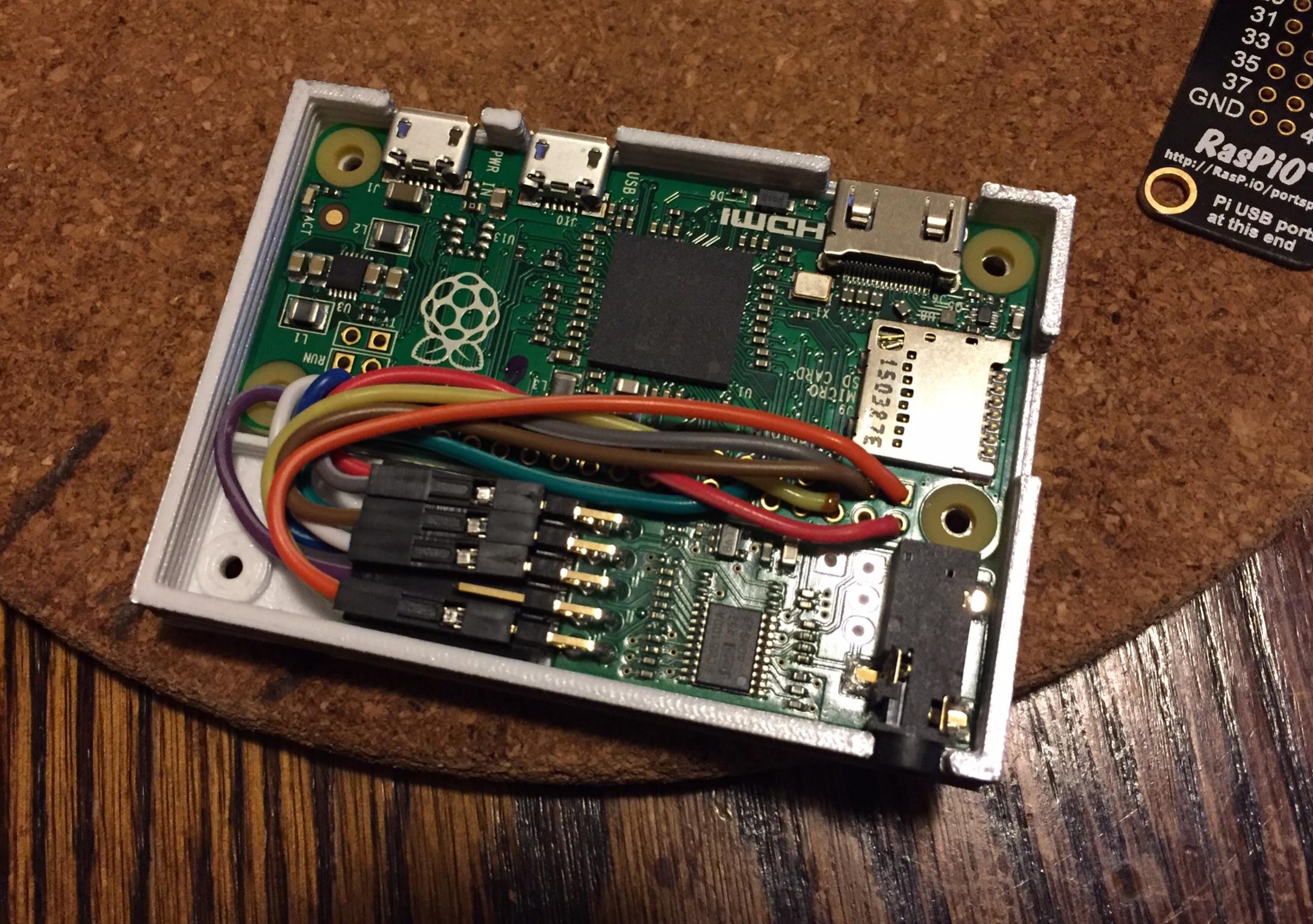

Recently, I've switched over to the TR2 (and, nota bene I've build second player - this time for a bedroom - see pics).
Since TR2 I've noticed strange behaviour of the library tab.
For example (another attached pic), I've "1492" album from Vangelis.
In the library, I see only the track numbers and when played, I see their titles in the Playback tab.
In the TR1 version library was correctly displaying all the titles.
Is it bug or something I can easily fix?

Is this the only album where Library does not display the title?
Zip up a few of the the tracks and mail download link to tim at moodeaudio dot org and I'll investigate to see if its a bug.
Btw, nice to see PiZero being put to good use 🙂
