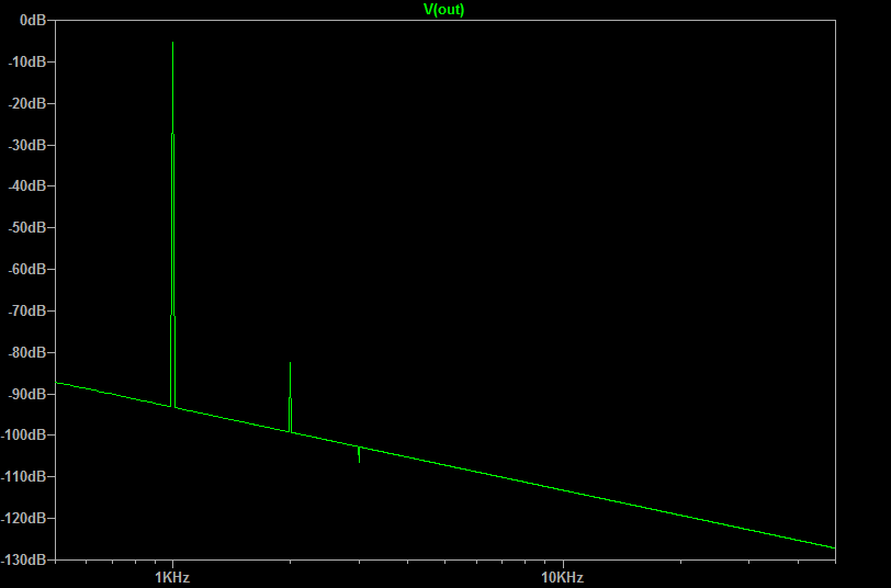

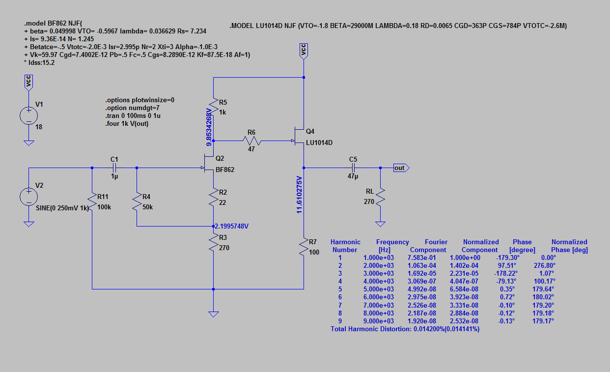

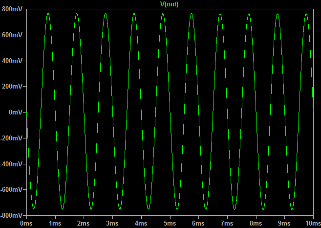

Here is the LTSpice sim of a single LU1014D for output. I adjusted the source resistor to 100R for about 100mA bias. The predicted FFT at 1.5v p-p output is quite good with THD of only 0.014%.
Schematic:
588533d1483117660-mosfet-source-follower-headamp-juma-aksa-bf862-lu1014d-schematic-v1.png
1k Sine wave at 1,5v P-P:

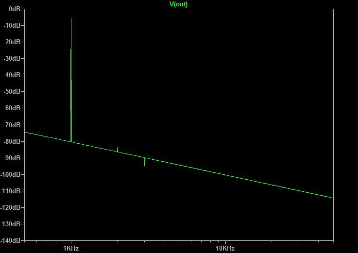

For 60ohm cans, it is even better (THD is 0.010%):
588536d1483117862-mosfet-source-follower-headamp-juma-aksa-bf862-lu1014d-amp-fft-60r-load.png
This suggests one should add parallel load resistors on the output to get 60R. So about a 70R resistor in parallel for 250ohms cans should reduce HD.
Not too shabby for a 2 transistor amp!
