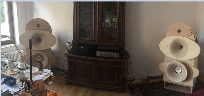

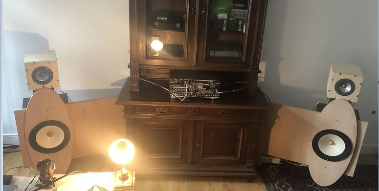

Hi there, it is a quite ordinary room with my home office in there, the other big listening room is not ready yet
I tried this one some time ago:
and changed to this very experimental setup, especially from a craftmanship point of view
I went back to the small setup with the 4.5 inch KEF R3 coax with a Sonido woofer from a very large setup that was far too big for my home office
see also here for further details
https://www.diyaudio.com/community/threads/ultimate-open-baffle-gallery.123512/post-7393996

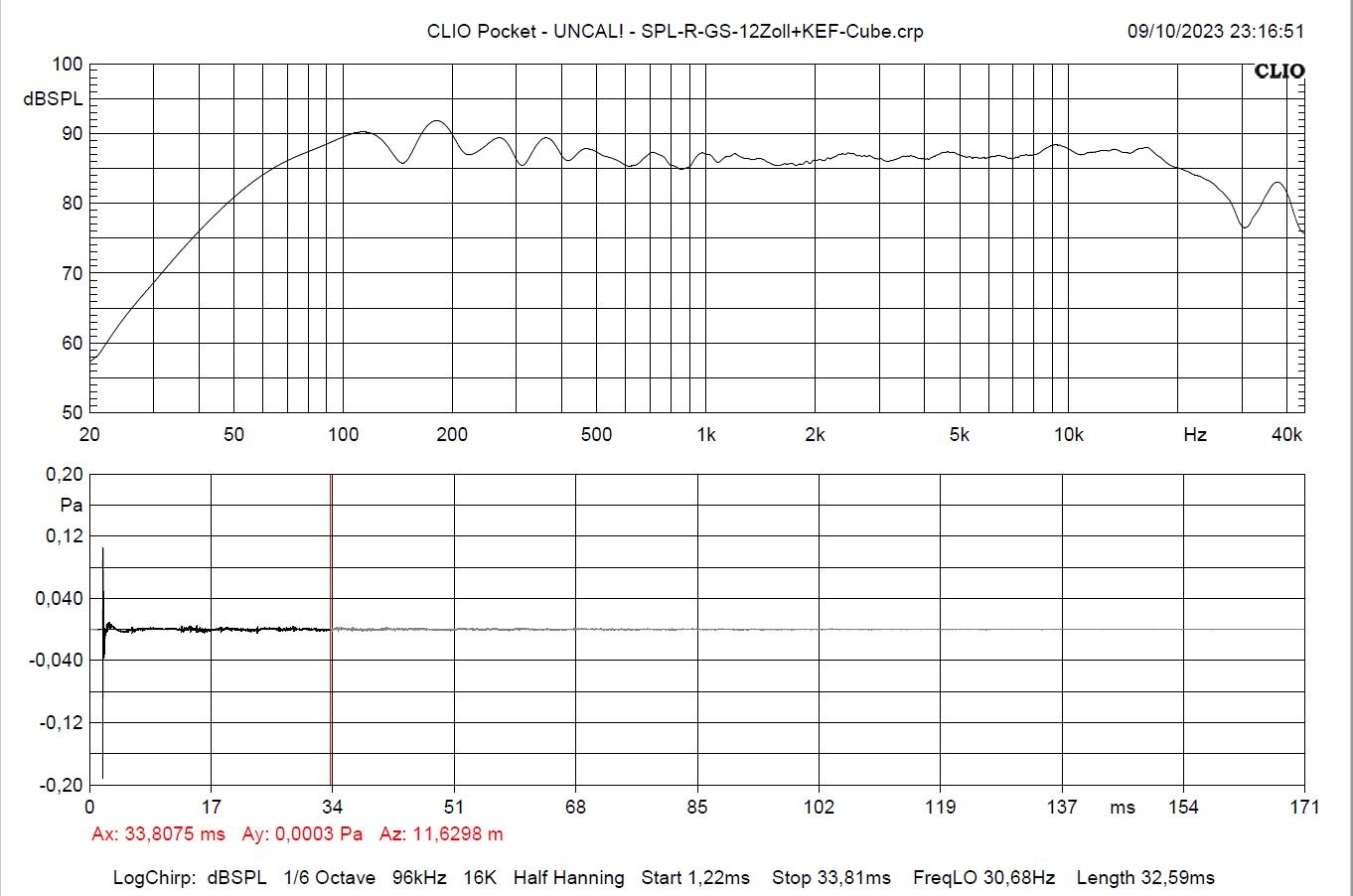

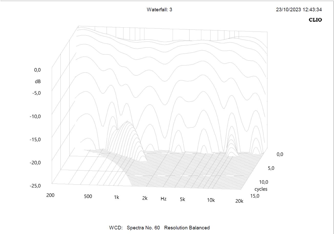

The first setup shown above was too large - i tried real downsizing but it was too boring although the measured over all SPL, CSD and WCD of the KEF coax + woofer in CB with massive active PEQ was looking good
SPL-20-20000-Hz-32,6ms-Window-Capture.JPG WCD-200-20000-Hz-6ms-Window-Capture.JPG
- i needed to go back to a open baffle to save some space with a decent midrange horn, not really down to 400 Hz but with the 18sound XT1464 and the B&C DCM414 quite close
Hope it helps to understand what i mean - Stefano
