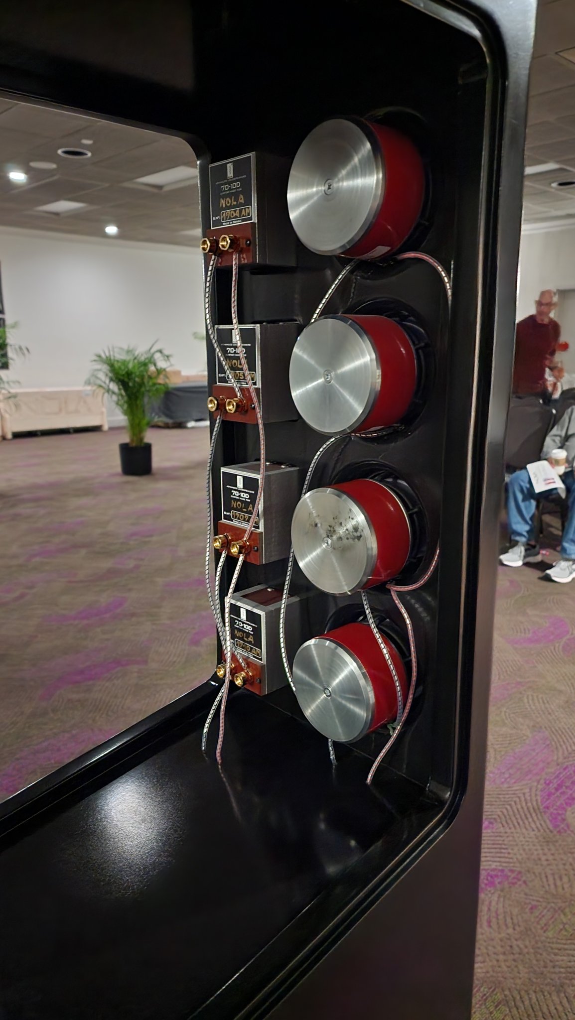

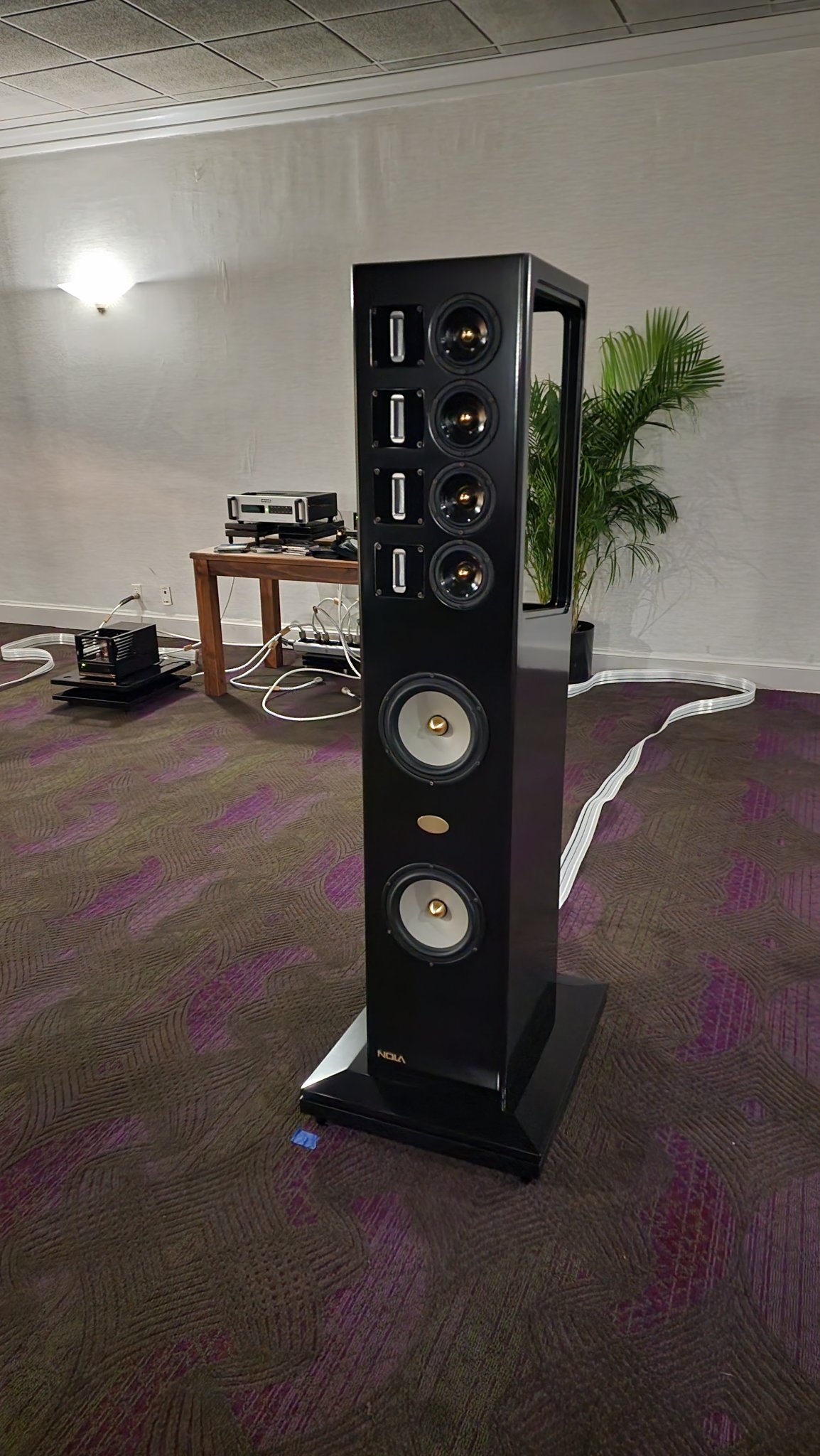

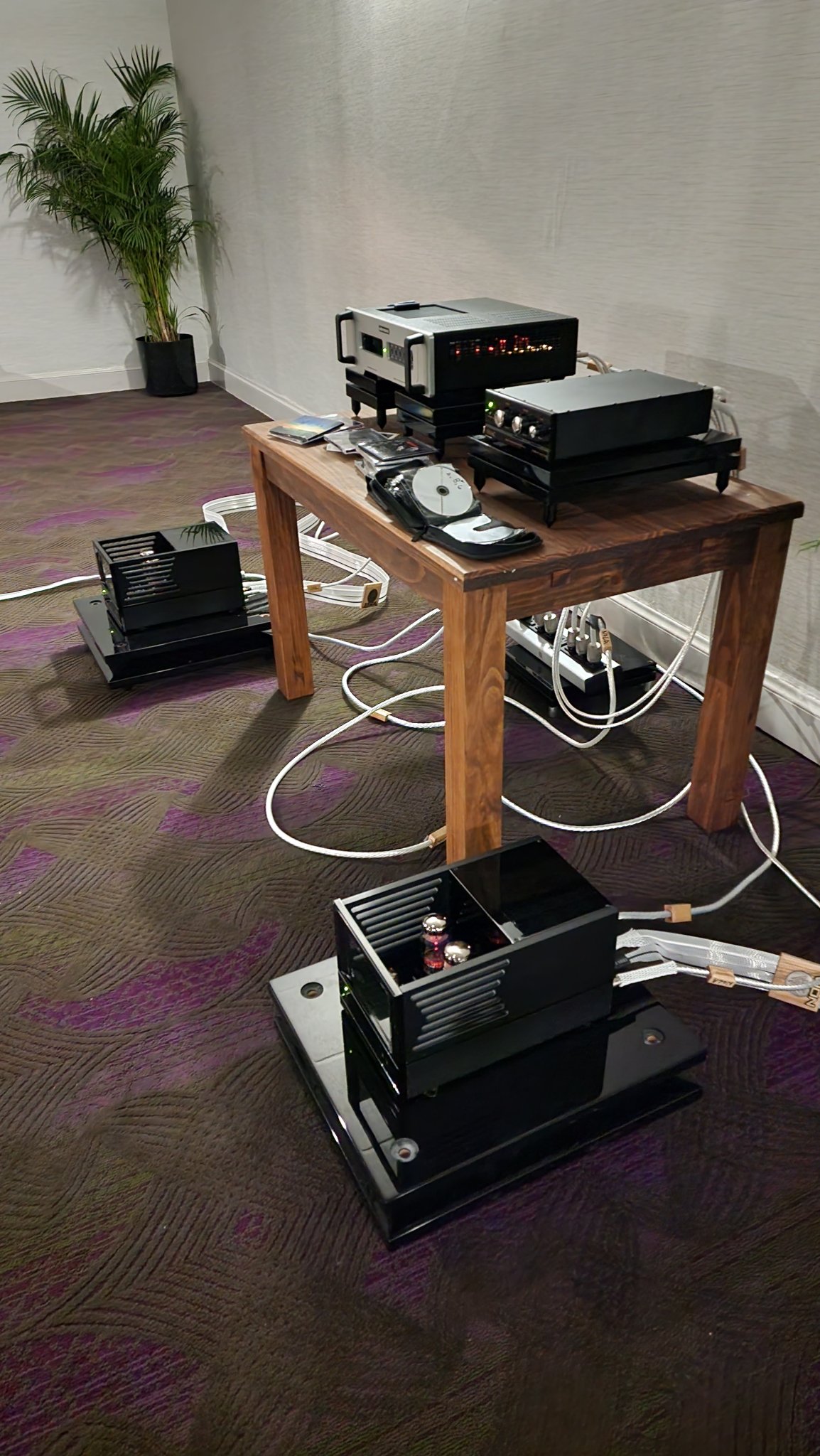

Recently visited Capital Audio Show. While there were many rooms with great sound, none would easily qualify as euphoric.
One room which always stands out for smooth musical and pleasing sound is nola.
I bet those mids are of high quality. But tube pre and tube power monoblocks are responsible for great sound too.
Here are some pics, enjoy.
