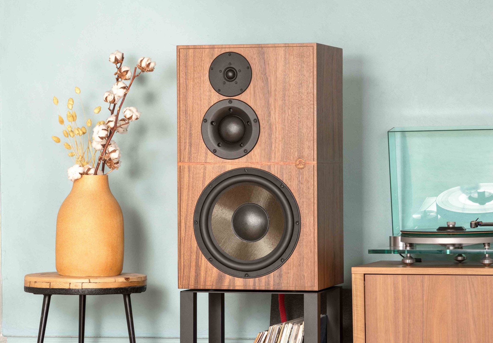

No idea where people have the idea these mid dome drivers are "weak". The loudest HiFi/Studio Speakers are built with them, they have higher sensitivity as all HiFi drivers. 3" coil - many low frequency drivers don't have coils this diameter. They produce dynamic and level way over normal HiFi midrange drivers!
You just need to cross a little higher, in an area where wavelength is about 0,8m. That's actually pretty easy to do seamless.
Nothing wrong with them for their purpose but they somehow lost popularity among the speaker makers and the listening public. You look at speakers from 80's and there are lots of midrange domes. Where are they now ? In studios mostly in form of ATC ,PCM . And the reason is ?
After heard the ATC dome, I don't know what could be the reason why manufacturers are not digging for mid-domes. But wait, look at Scan-Speak, Bliesma, SB Acoustics new models, or Yamaha, ProAc, Wharfedale etc speakers!Where are they now ? In studios mostly in form of ATC ,PCM . And the reason is ?

The reason why there are less 3" midranges? Easy - they are expensive! Look at these ATC drivers - they are monsters with huge magents and produced in low pieces. And you need a proper 3-way construction - also expensive.
As long as people are happy with some 6"/1" bookshelf speakers ... you can earn way more with these.
3" midranges where always in the market for the use cases where you couldn't find better material. And seem to find a comeback, I recon cause we need loud and distortion free speakers for home cinema.
