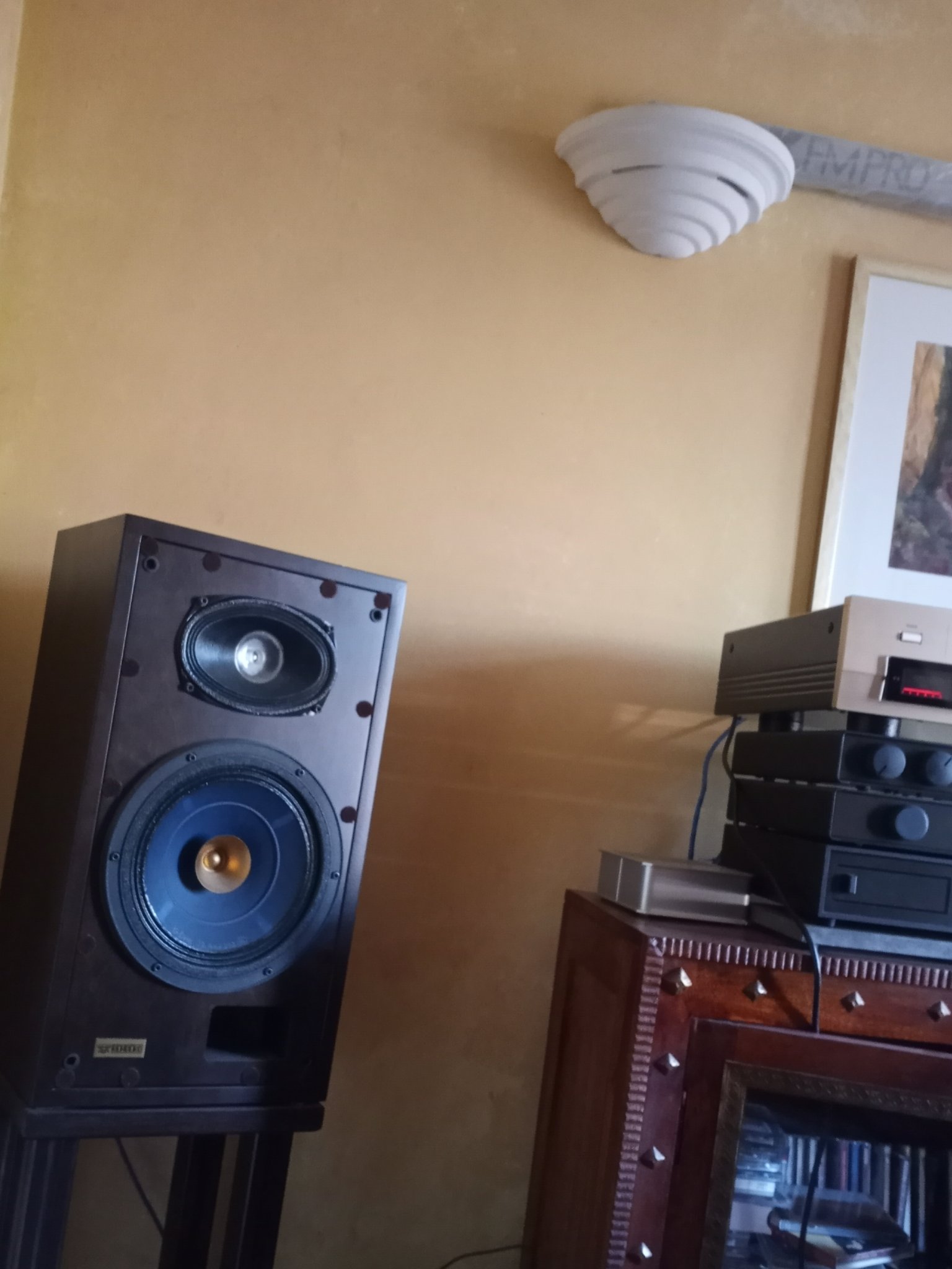

Rhedeko lovers are a small club indeed ! I wondered if it was one because of the blue cone.
Here we had some old drivers that sounded good : old cabasse one (not all their drivers) and also Siare which is less known abroad. They fall in the musical loudspeaker that are not fidel, often. But who care if it is the one one likes. The guys from Audax came for many from Siare.
