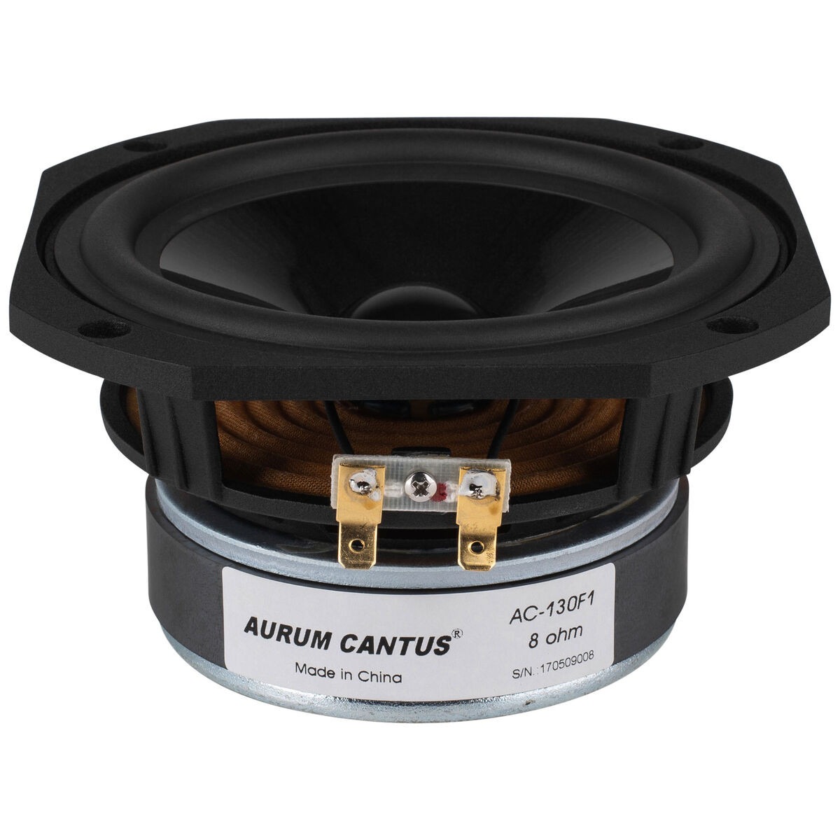

Back to the original question, one of the better midranges which i use often is AurumCantus AC130f1. Its lightweight membrane has almost no breakups. I use it up to 5kHz. In some cases, small bookshelfs, even without any filter at all. Sounds very good to me right now. I have been experimenting with small hamptone preamps, for pure 2nd harmonic sweetness, together with one of small lineup classA amps fills the room nicely with sound i adore. Amplification is very important part of the quest.

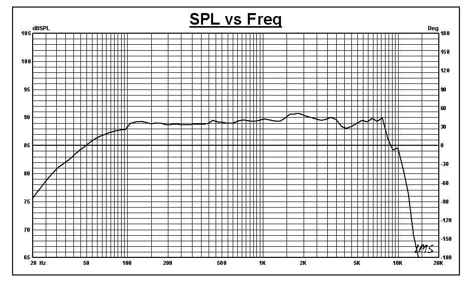

Another midrange i use a lot is betsy. I never use it as fullrange, since i dislike whizzers, maybe from my lowther era, so i either order betsy wow, or i simply cut the whizzer out.
Again, its lightweight cone, fast, can be used from 100Hz to all the way up to 5kHz. It has some breakups, but not too severe, crossover can easily handle that.
I use betsy wow on open baffle, off course, but it can be used in bookshelf too. Its no woofer. Midrange is rater good and with higher sensitivity, does not need much power. Highly recommended.

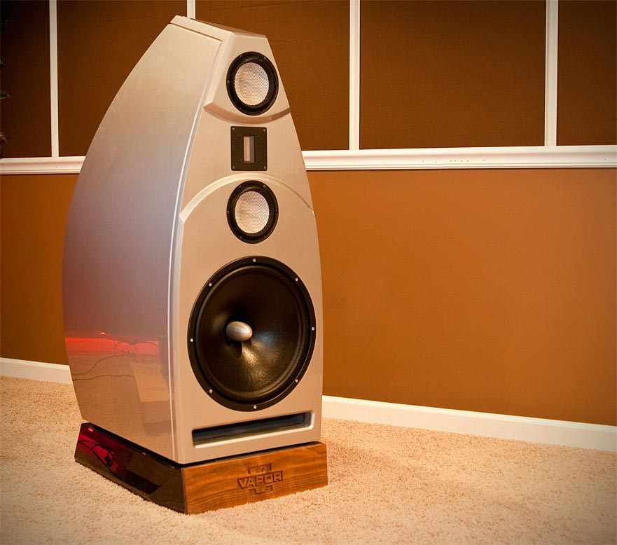

I was listening today to Vapor Audio speaker with Accuton mids and Raal tweeter / Acoustic Elegance 15" woofer. It was a peculiar setup. 80's turntable and humongous 80's Jap receiver with gazillion controls and lights. Expensive cables and that's it. I remember the speaker from Chicago audio show. It was so bright it was painful to listen to back then several years ago. It wasn't so bad with vintage tech. Tight and fast with jazz and properly squeaky with Starker solo cello recordings. Midrange sounded specific , hard to say when listening to such unusual combination
The owner is bored on retirement and wants to build Altec based system so I delivered empty Valencia Cabs , 515B woofers and Jabo KH-55 horns as a starter kit to monkey around.

Aren't we all ? That clip sounds better on my phone than on the system so maybe there is something to it Vapor sounded like a new car. Tight, smooth. comfortable and with lots of perceived power it can pump into air. What's not to like ? I can sympathize with studio guys having it under the palm of the hand.
