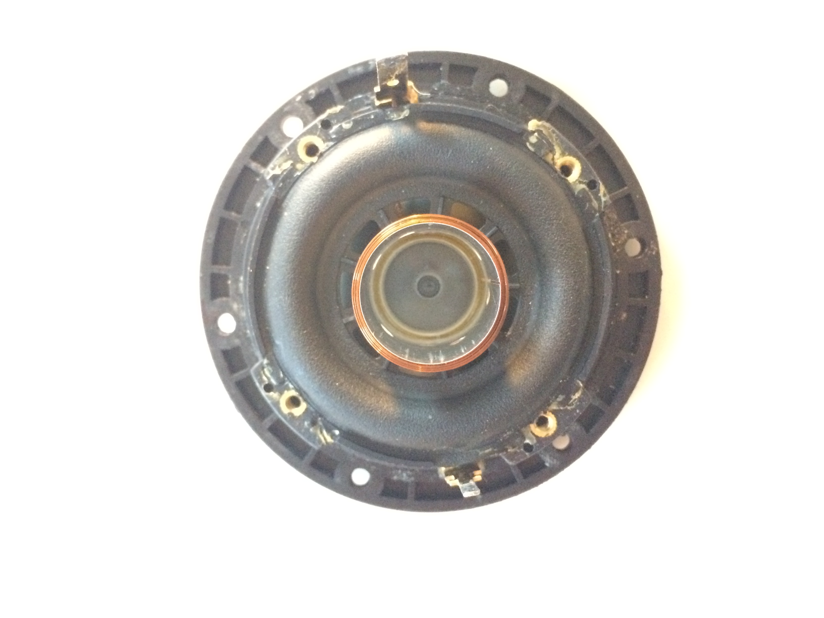

I'll say (coincidence)sqr! I use this driver in a MLTL and I'm very satisfied with it. Not only good transients but also deep bass. If I can reduce the 8 litre to 0.5 litre with the same SPL using two drivers, less THD, dynamicly balanced mass-acceleration etc then I will be very happy.
You are right about the dustcap. However the inverted cone is very hard and the joint to vc very solid. A holder with sensor will work very well if I compare to the Philips design which is my only experience sofar.

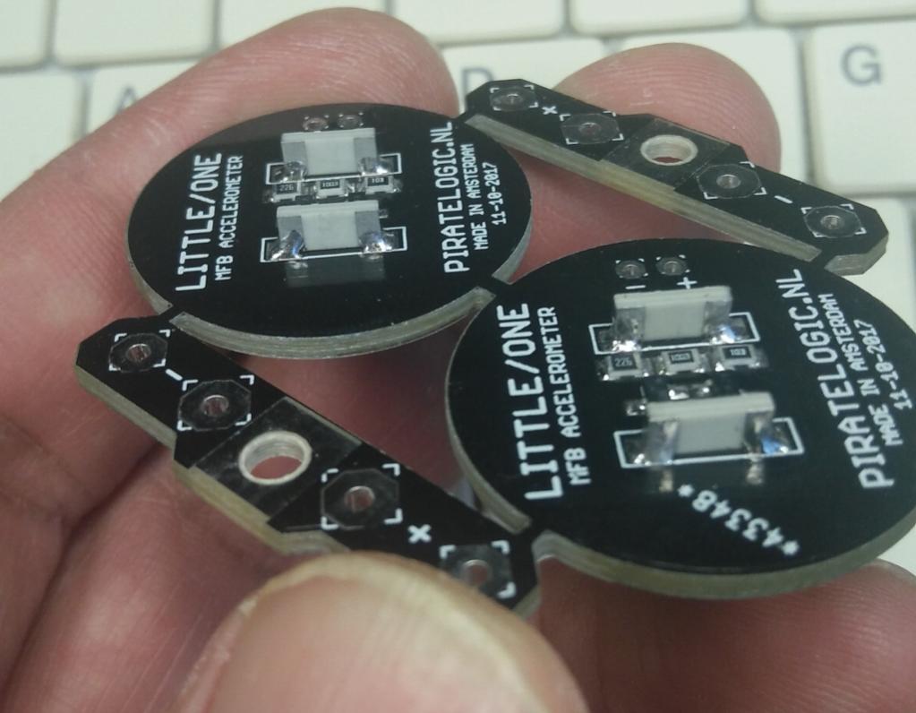

I hope you can help me chose the right sensor for my MFB project in post #137. I have looked at the Piratelogic homepage and find ClingOn especially interesting. I plan to use a 3D-printed holder that integrate very well with the hard cone. It will be like an extension of the vc.

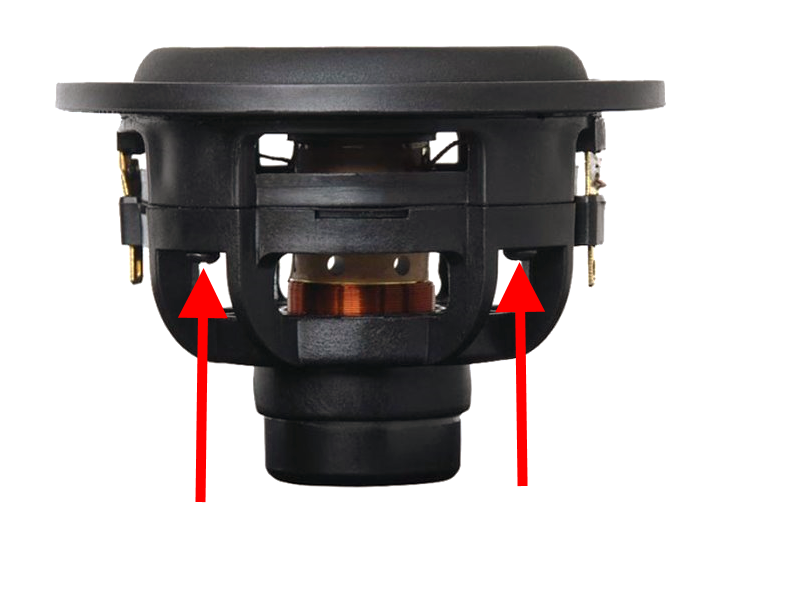

TadaaLooking at the w3-1876 driver I wonder if it allows the magnet to be dismounted from the basket using the screws indicated red
A sensor d 19mm fits inside voice coil. However risk for rumble from compressed air.
Thats great newsTadaayes it will! The first time might cost the driver but next one will be quite simple.

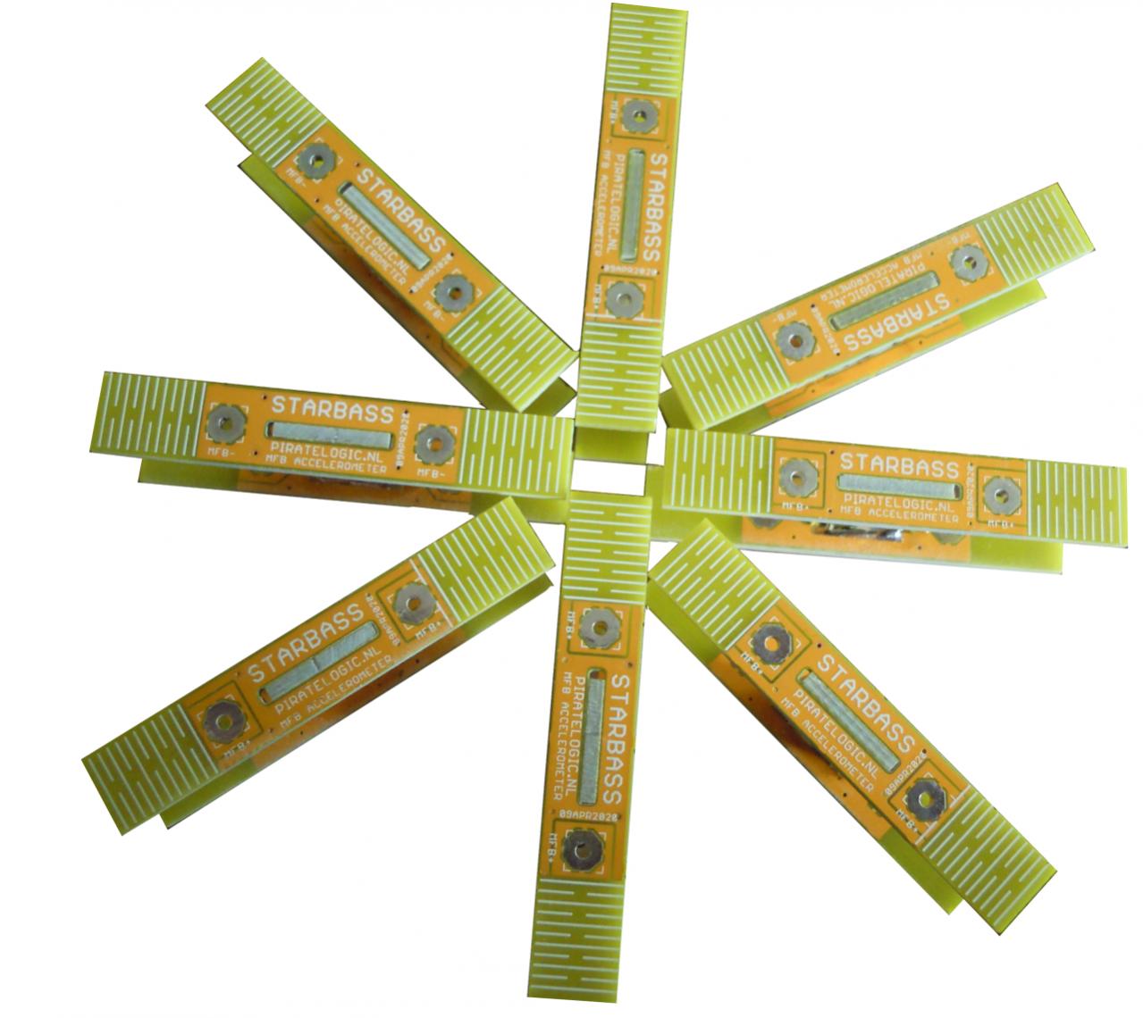

The obvious choice would be a StarBass 25 accelerometer modded to fit the 19mm VC:
Assuming it gets tightly glued against the back of the cone that shouldn't be a problem as the Murata elements themselves are airtight.However risk for rumble from compressed air.

By the way what is the roughly weight of a modded starbass 25?
A standard StarBass 25 is around 3 grams and expect a 19 mod to sit around 2. I'll send you more details later this week via mail.Let's get on with it! GIve me instructions..😀

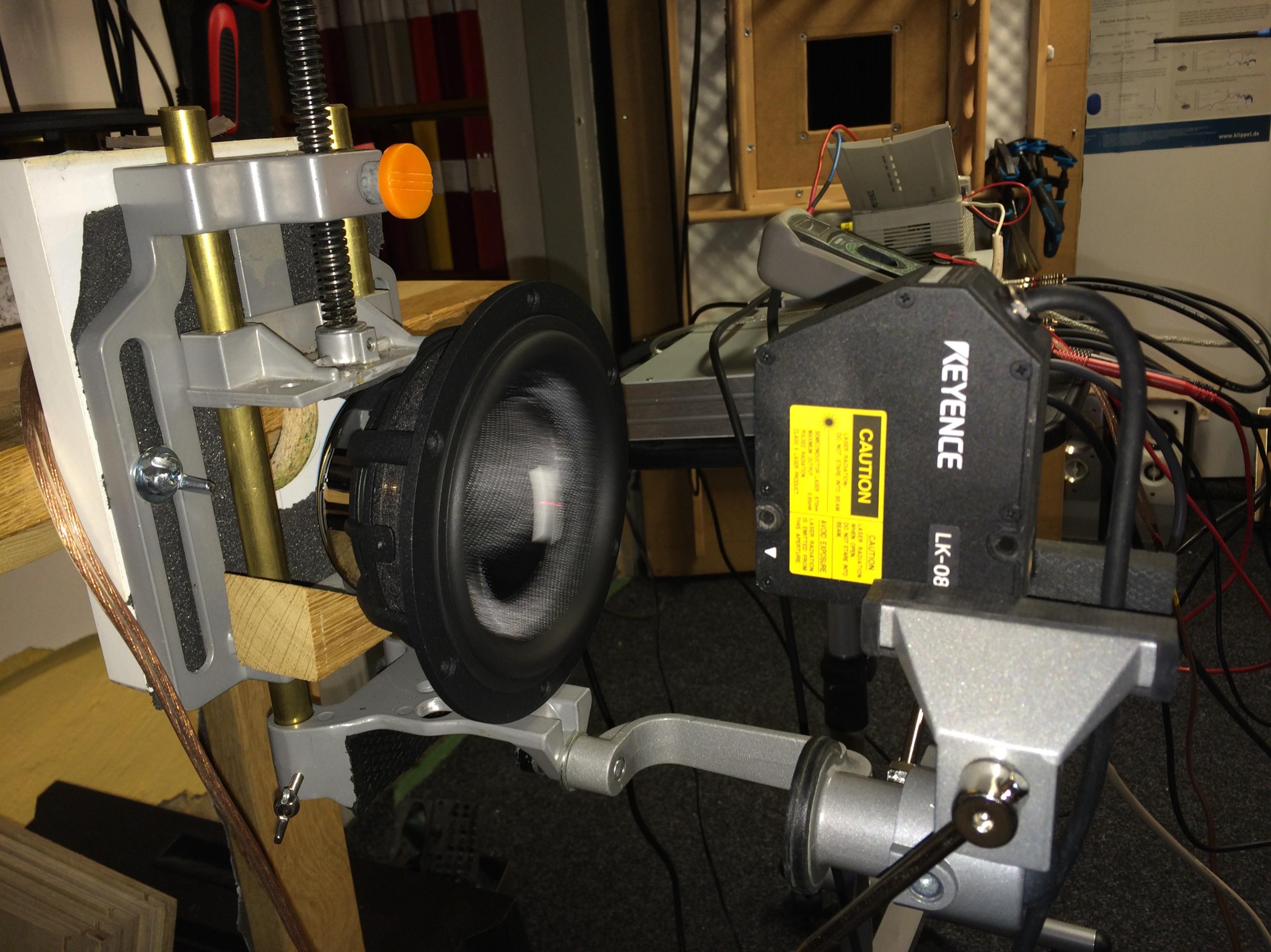

With regard to laser sensors, we used a variant of these for height control on bevel plasma cutting systems. My guess is that nothing of this type would be fast, accurate or inexpensive enough for use as a loudspeaker voice coil position sensor.
I use the laser on the photo for linear and un-linear parameter identification (TS and LS parameters) among other precision measurements.
Its good enough up to 700Hz with a resulotion of 1u in a controlled climate. However high quality measuring of a bending, wobbling or angular shifting of the cone demands more than one laser point.
It would be an ideal solution for a feedback as it does not interfere whith the object and the challenge I assume is how to get a robust signal.

The Klippel measurement system at my workplace also uses laser. And i Guess that 4kHz sampling would be good enough for a subwoofer. 40 times oversampling @ 100Hz.

Is it optoNCDT 1420 Klippel are using today? The one I use is what Klippel used some years ago. Max sampling 1kHz but the rest the same for both in spec.
It's not always I manage to measure up to 1kHz because of noise. At cone diameter less than 170mm the pistonic movment is decreasing and gradually distorted by bending at the periferi. Depending on stiffnes of cone, elasticity/density ratio, internal damping etc influence also I assume.
To get a good result it's important that the laser triangulation is made perpendicular to the surface and to have a consistent surface reflection. Also the choice of location for the laser i find essential. There is not one spot on the cone that moves completely pistonic is my experience and manifest in noise.
To clarify previous, the cone breakup start at the vicinity of 1kHz for a 170 mm cone.
In addition to design and material inconsistencies, glue beads, tinsels, anisotrop properties, surround and cone partial resonance modes etc contribute to the challange to use the laser for good results.
