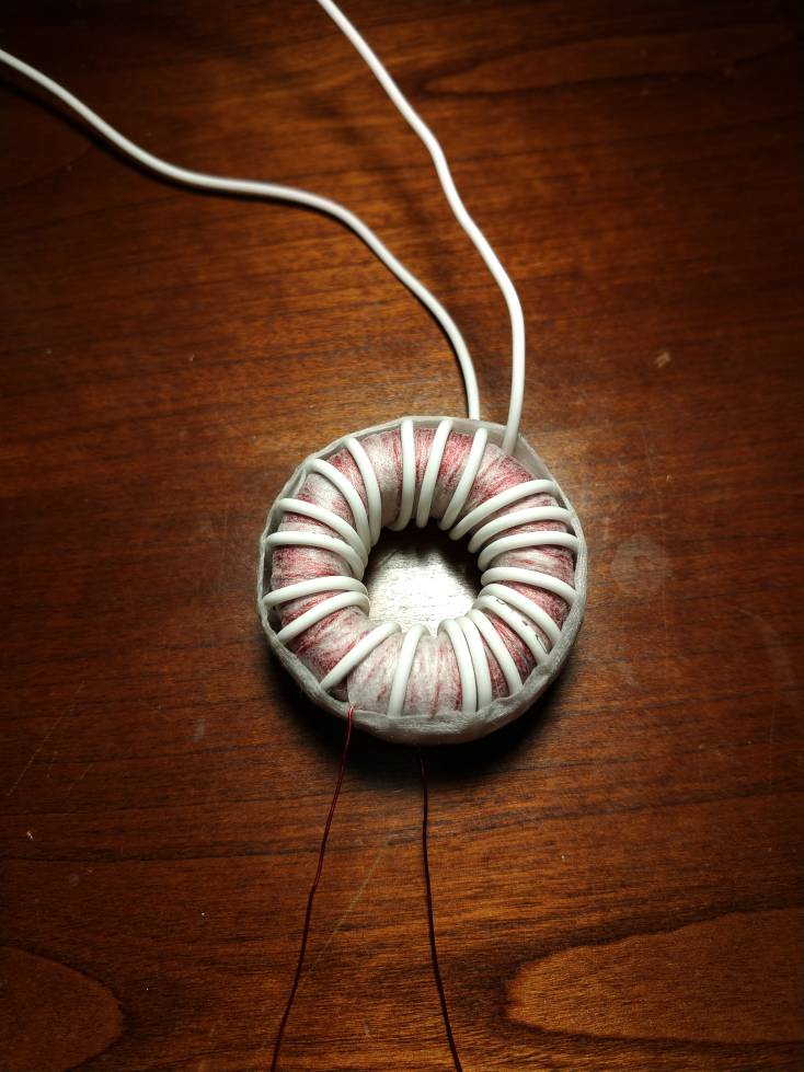

Feedback coil for Mr. Erath's circuit.
Given the mysteriousness and vintageness of the LWE speakers, as best as I can guess*, that coil is the leg of the Wheatstone Bridge meant to simulate (that is, to balance against) the driver.... a circuit well-known in audio circles at the time (mid-70's?) and that others (and me) had been experimenting with for some years (see JASA, Werner, 1954).

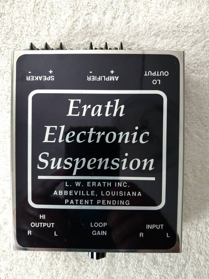

What Erath marketed what a little passive panel containing the bridge and some odds and ends and the speaker. The buyer had a choice of purchasing the LWE amp all connected or doing surgery on their own amp to connect the feedback signal. It would be perilous to try this on a modern high-feedback factor solid-state amp today.
By all accounts I've seen, the modest (and kind of tacky) LWE box greatly impressed reviewers. Which is true of nearly every account of MFB I've ever read, including this thread.
Erath was an audio amateur whose day-job was geophysical engineering. All adherents refer to him as a gesture of the highest esteem and genius as "Mr. Erath".
B.
*Sure would be nice if troystg could provide a schematic or link to the circuit.

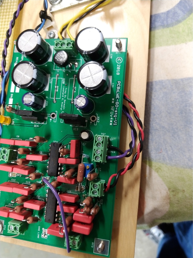

I have several working units that I bought from him directly. Not the earlier LWE speakers with clip kits but purpose built stand alone units. In all actuality I probably have the last units he made before he passed excluding his Trout powered speakers.

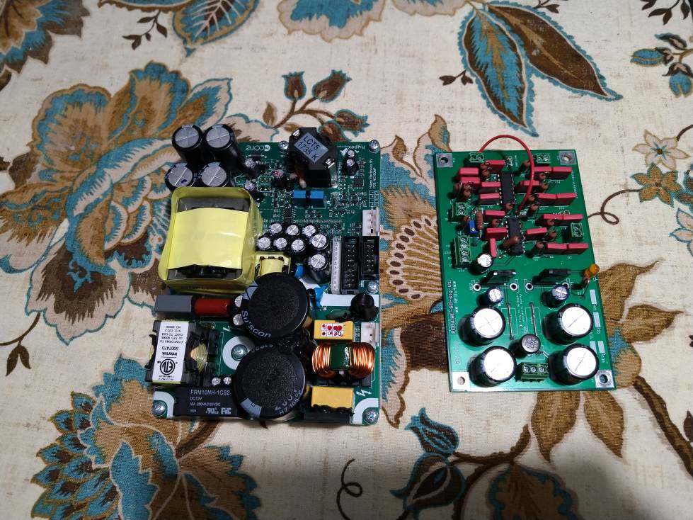

Problem is the unit is a single stereo box and I am making 3 channel amps to sit next to the speakers.
So I am trying to copy the stereo unit into mono units. Off and on for 10 years now. I am finally in a position where I have time and resources to finish this project.
The amps have room in the enclosures to add Mr.Erath’s units when I finish them. All wiring in the amps, other than power and switch, is temporary and too long. Will be cleaned up once complete.
Thanks for update. Good luck with your project.
Based on painful experience with the risks of feedback turning into howl back, use an amp with output lower than what your driver can handle without burning out and be cautious.

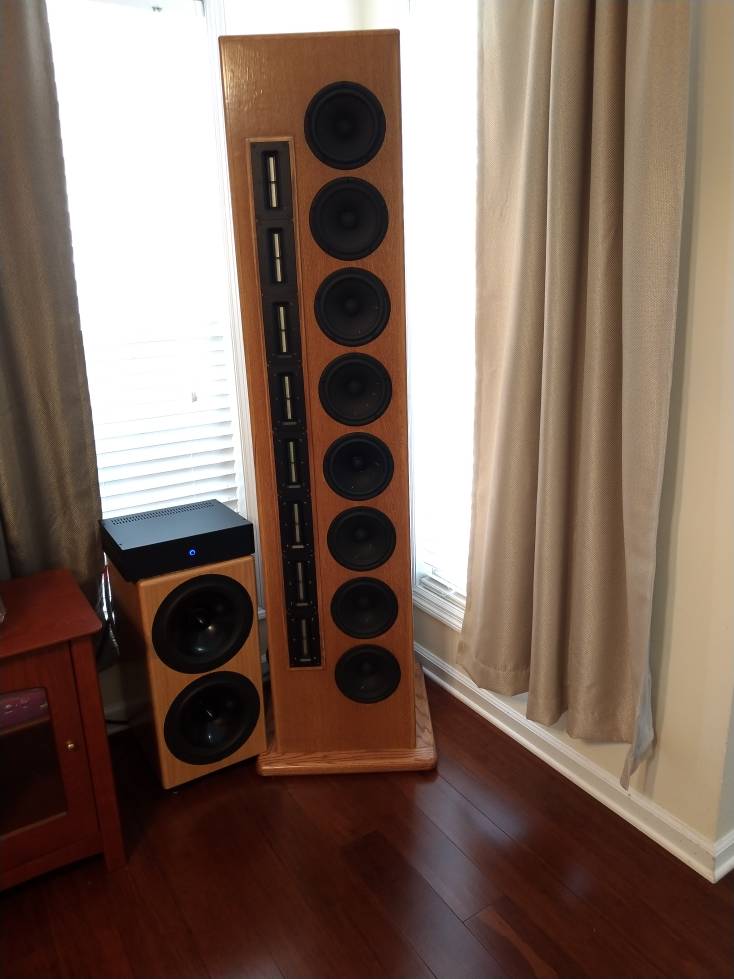

The line arrays were built by a close friend of Mr. Erath. 8 x Scan Speak Revelator mids and Fountek neo 2 ribbons. The woofers in the picture are 2 x 10" PartsExpress Reference Aluminum woofers but they are for one of his other servo units. His best servo uses a 15" woofer in a 1.25cu. ft. sealed enclosure. I hope to eventually have 2 x 15's on each side and then dynamics will never be a concern. Even though all new music is compressed to hell.
Ummm, quite an accomplishment just getting a 15-inch driver into a 1.25cf box.
The servo function has nothing to do with the nice looking tall speakers, only the subs.
If you don't ever plan on providing information on the LWE MFB circuitry of 1970, there's no value in this thread with pretty pictures of boxes. You've popped up in various threads over the years with adulation for "Mr. Erath" but I have yet to learn anything of interest about the design from you.
