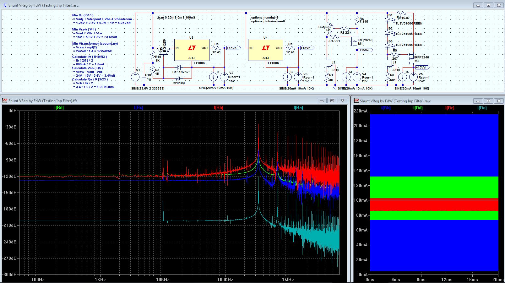

EDIT: Michael, I can't read it: What are the parameters of the input Voltage Source (you use for the distortion measurement)
Have you already simulated that whole schebang ?

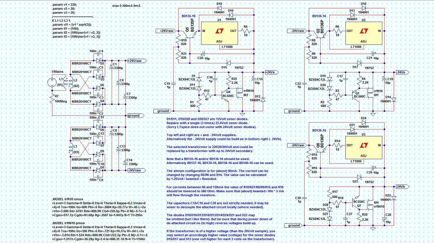

Still working on the final version (there is a (small) one wire change). I will publish in the next hour.
About the servo, normally I would use a somewhat bigger capacitor (1u poly) and smaller resistors 1Meg or even 100K. My opamp of choice for servos is the OPA134 (like D.Self 🙂)
Sorry Joachim one small change to make, the capacitor that was placed between the transistor base and ground has been moved to (between) transistor base and output. This gives a much improved load response.
Attached are may (currently final) research and power supply schemas with annotations. Also attached are the LTspice source files. Next thing for me (is build the real thing).
There are a positive and a negative supply and one variation that uses (almost) the same components for the negative supply as for the positive.
Also note that BC327 and BC337 transistors can be used to replace the BC550 and BC560.
And finaly, if you want more than 100 mA you should replace the single transistor (in the gyrator) with a Sziklai pair having a Rcb of about 100 Ohm. (more usage for your BC327 and BC337 transistors).
  • Shunt Vreg PSRR.asc.txt
  • Shunt Vreg 24V.asc.txt
