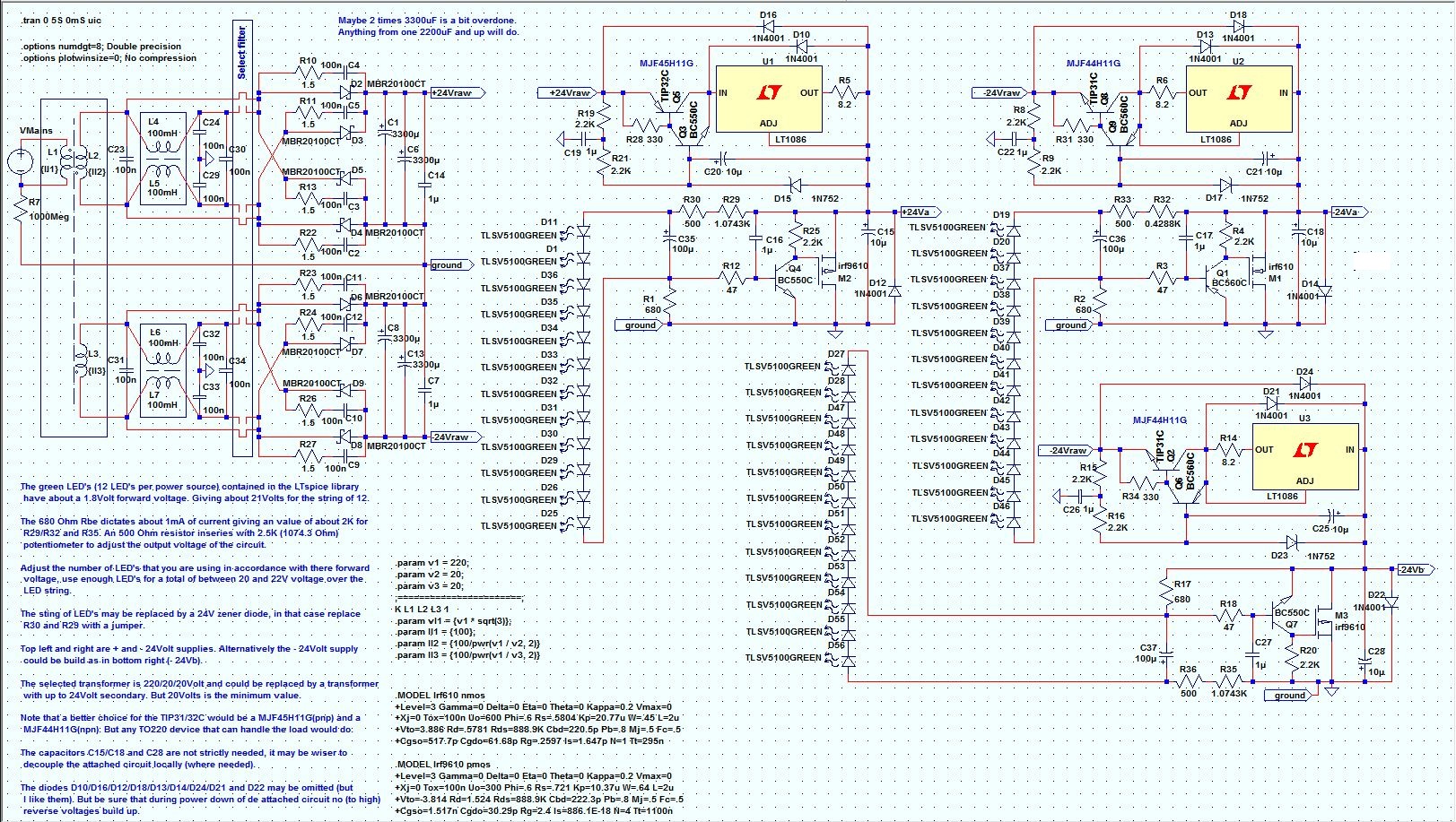

Here a version with the filter, snubber resistors and LED's. The current has now been set to 150mA ( 105mA for the amplifier, 45mA to warm the planet).

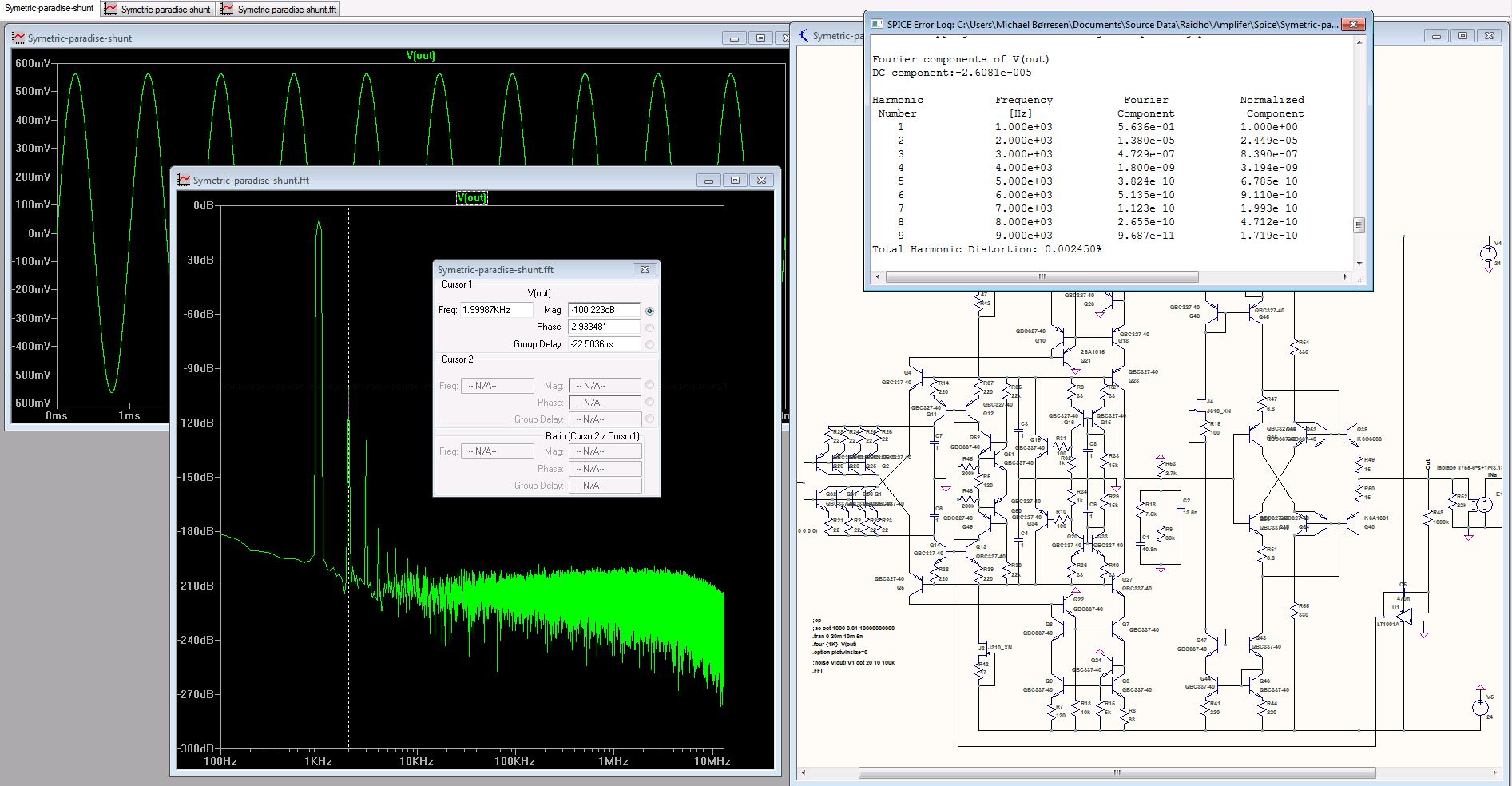

Seems like it get's better with 22 ohm degenration....but again worse with 10ohm, so 22ohm could be a sweet-spot at least for simulation...distortion looks good...

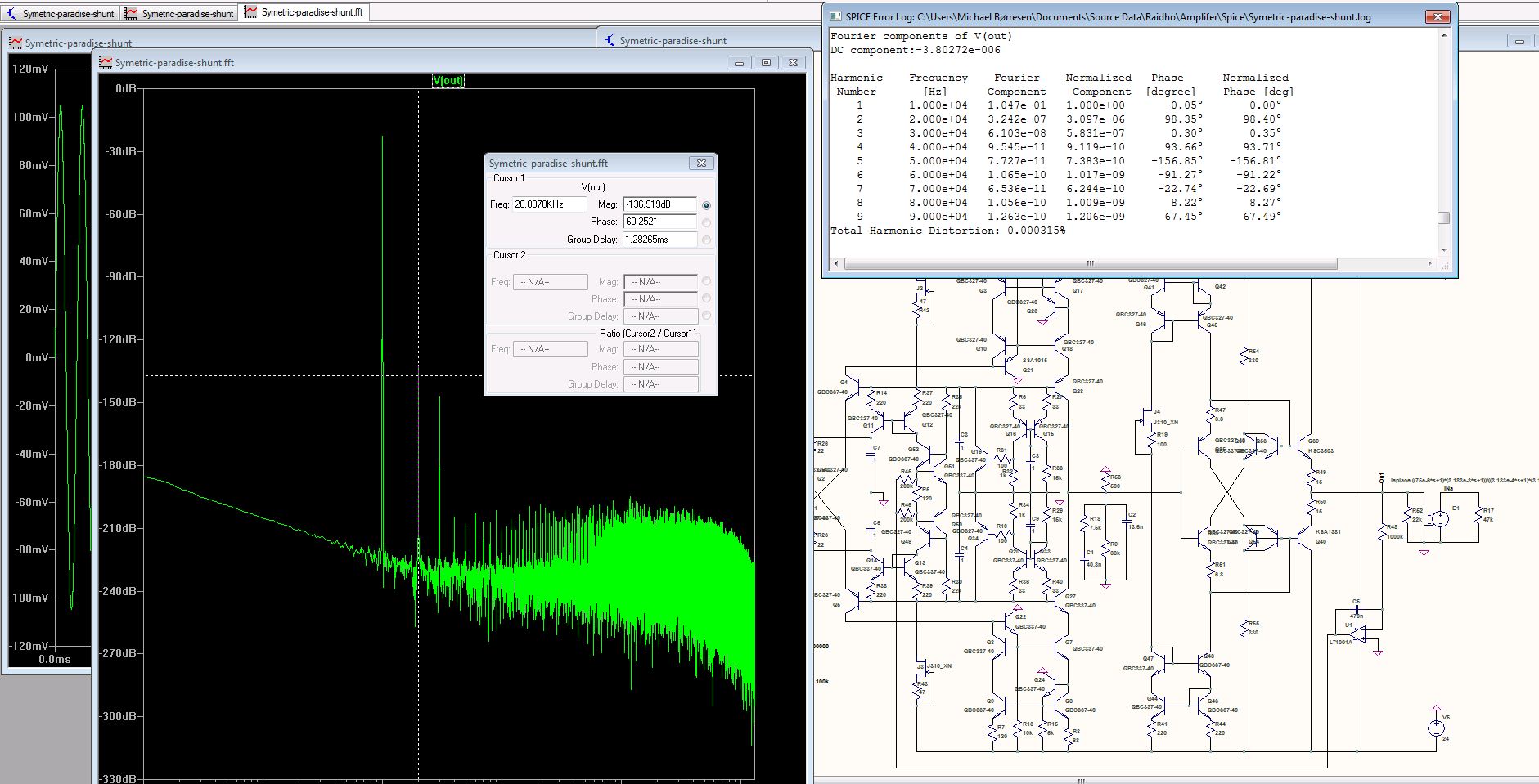

I have also made distortion analysis at 10KHz, where the gain is 46 dB, and here the current RIAA really shows what's it's all about, Distortion drops quite a bit. This is the ultimate strength of this circuit, Lowering distortion as frequency increases and no feedback. Only type of circuits i know off that is capable of this...

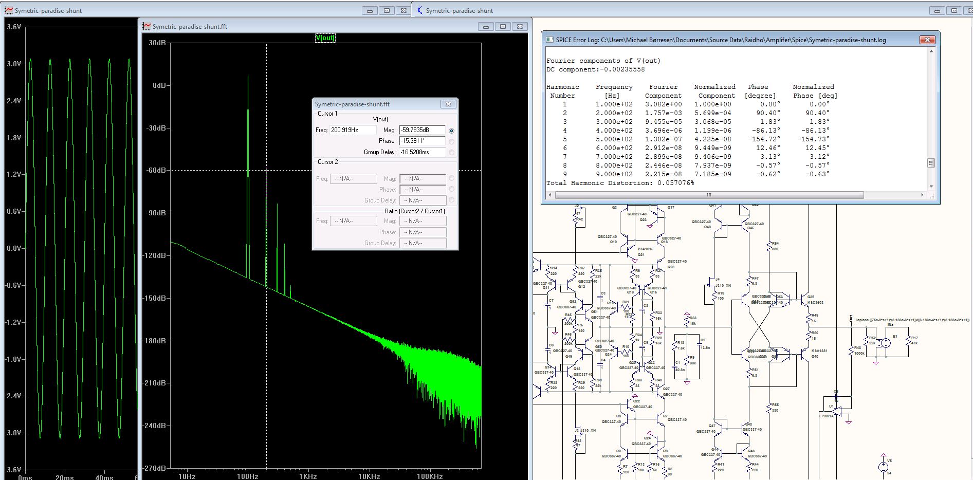

This is how it looks distortion-vise at 100 Hz, where the gain is a whooping 80dB
and the signal out is +-3V (will never happen)
max voltage-swing before visual clipping is app +-8V

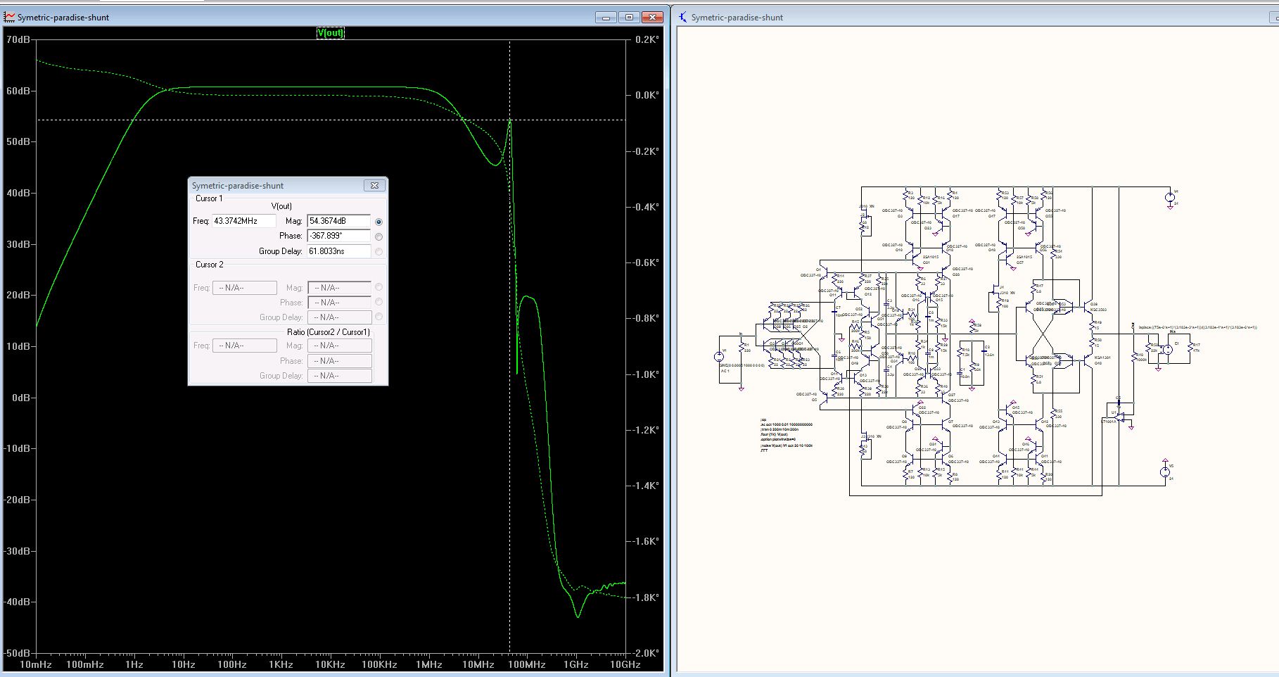

I have some issues on the BW plot, as there is a gain-peak/resonance at 44 MHz, I think that PCB trace-capacitance/resistance will deal with this, but more skilled people than I must chip in here, could be we need some compensation....Only thing is I'am clueless where to place it..

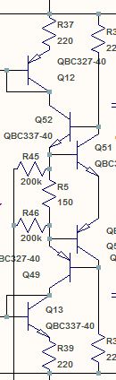

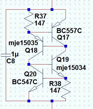

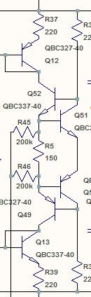

The only non-mirrored item in there is J4 at the cost of 4 transistors (6 cents) it could be replaced by this nice mirrored ccs
Do not worry too much about the 44Mhz, I think also it will go/disappear on the board, and if not it will be easy to hunt down (I think).

I thought about putting in the same CCS as we use in the front end

Yes, Rüdiger. I would do an RC filter before the buffer. The peak comes from the buffer i suppose but is is very high up so input impedance must be quite linear. First it gets inductive and then capacitive. Maybe we should limit at 1 to 2 MHz, then we have a nice Q 0,5 rolloff with very little phase change.
Something like 220Ohm in series with the input of the buffer and 150pF to ground.

So it is an infinite mirror, we can that Spiegel im Spiegel in Germany (;
Michael, running the output trannis in 15mA at 24V gives a dissipation of 0,36W. That is approximate half of what the transistors can stand. this is still ok for me. We could also use two plus two i parallel with separate emitter resistors with double value. That is more linear and gives half dissipation.

Can we consider the option to use a higher current in the psu shunts ?
IMO irf9610 starts to sing between 180 and 200mA.... I even noticed some improvements using those at 300mA. I know it is a big waste of heat but substatntial sonic gains can be achieved that way![]()

Frans, i have to look up where you would like to put in the new mirror.
I was not totally serious about that, I just thought to sell another 4 transistors, it won’t make any difference
Anyway, lower R5/R6 to 6.8 or even 5.6 and the current starts flowing no need to change anything else. Be sure to use a bigger transformer and double the buffer elco's (if you are busy at that). The current that will flow is 1.25Volts / Rset = Iccs. And (Iccs - 105mA) * 37Volt = Wwarm-the-world.
If i would have the final saying then i would prefer to get the job done just right and not over engineer it. Too much heat is not what i want. The circuit itself has superb suppression of PSU anyway. Cascoded mirrors, cascodes with mirrored and shunted bias everywhere.
This is not a simple single ended phono where the break through of the PSU is clearly audible.
