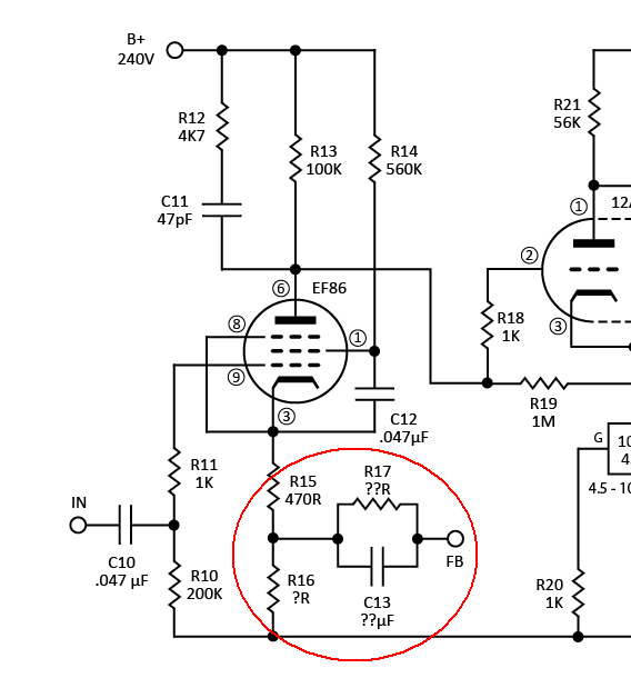

There are only a few items left to resolve to finish this off:
  1. The global feedback component values (R16, R17, C13)
  2. The mains fuse rating
  3. Name
(Of the names I've seen so far -- mostly my entries -- I like "Nocturn" best. It suits my cynicism about whether this amp will ever see the light of day. And it just sounds romantic.)
Then I can start drawing the 6GK5 version, while someone "smoke tests" and tunes this version.
..Todd

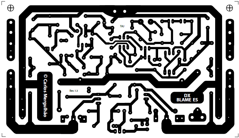

Oh thanks dhieber,
I use Adobe Illustrator. Schematic capture applications just frustrate me when it comes to drawing restrictions. But then Illustrator doesn't consider electronics, so all error trapping must be done by committee.
I've used it for designing DIY PCB's too, but since it doesn't reverse annotate or correlate to the schematic (no ratsnest), I've decided it's too error-prone of a method. You really need to use a PCB package to make sure the traces match your schematic. It took me about 6 revisions to correct all the wiring errors on this board.
..Todd

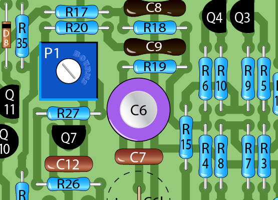

And Illustrator doesn't do 3D like most PCB programs do, but if you want 3D, Illust. certainly has the drawing power to let you fake it in 2D.
..Todd

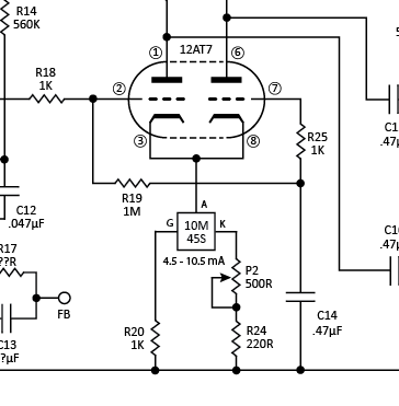

In the last schematic, I drew the LTP CCS terminating to ground, but I also see it being run to the negative bias supply in some schematics. Does it need a more negative terminus?
I'm reading steadily out these tube things, but I have a long way to go.🙄
..Todd
