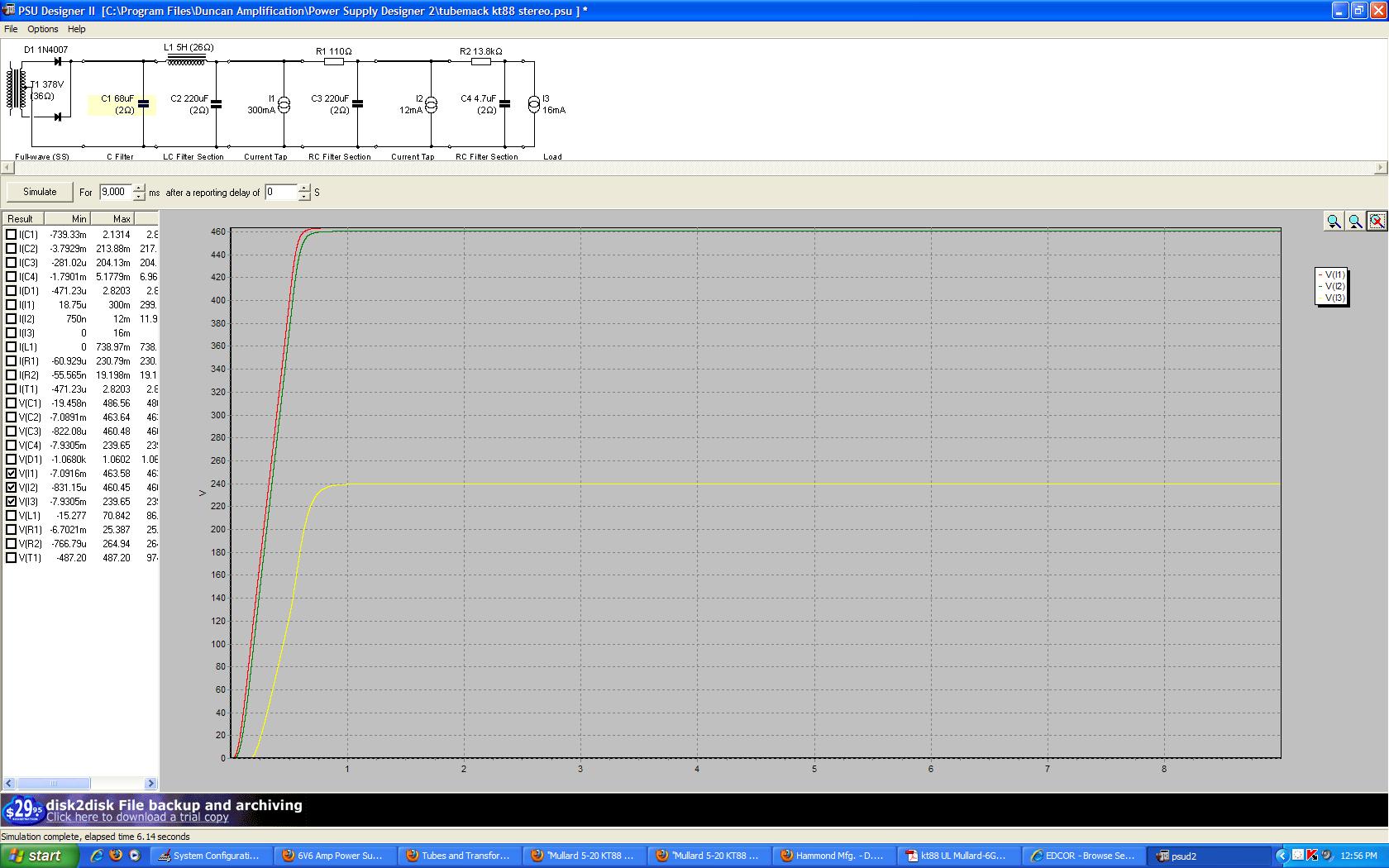

Taj: For some hands-on training, download and run PSUDII from here:
PSUD2
Take the existing PS model, and double the currents on the current taps, see if the B+ voltages and ripple voltage and current are reasonable. Also, you'll need a choke with lots of current capability, which puts you back to the enclosed Hammond 193 series.
Ask lots of questions if needed.

Stereo Power Supply
I just modeled the stereo power supply, and assuming that I have the current draw for each stage correct, it "barely makes it" with a 5H/26R Hammond 193P choke and the Edcor XPR143.
This choke appears to be the lowest R at a reasonable current rating for this PS.
Doubling the current makes the resistance of the choke the limiting factor at 360V supply; it barely makes a B+ of 463V when using 4 X 75ma for the KT88's. The PSUD model shows 378V as the unloaded voltage when you input 360V/500ma into the transformer properties box, assuming 5% regulation.
So there is no wiggle room for increasing the voltage even a little. It would be nice if Edcor had a 380-0-380 or so. If you want to run the KT88's hotter than 75ma, then B+ will reduce even more.
I used 75ma X 4 for the KT88's 6ma X 2 for the 12AT7's, and 8ma x 2 for the 6GK5's.
This is soooo nutsy. There is no issue at all to running KT88's at 400V. There is a barely perceptible decrease in power( at the power-measuring resistor ), and effectively nothing as far as the ears are concerned.
cheers,
Douglas
I'm all ears.....does it make sense to lower the B+ a little farther? It would certainly reduce the start-up stress on the PS caps a bit. I'm just trying to stay close to TubeMack's initial target values....Per Johan's post above, would we need to change some values around the 12AT7 when using a lower B+?
