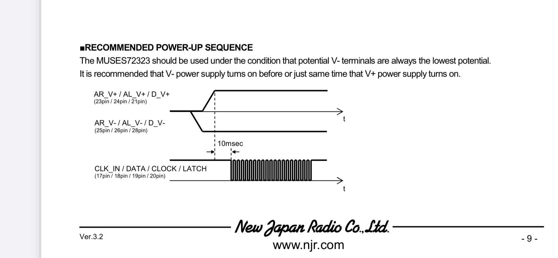

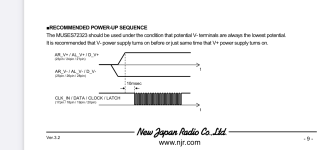

As you don’t use Meldano's volume control, but Academy Audio Inc. VCX Micro solution, only way to get useful answers would be to ask Academy Audio Inc.Has anyone using the muses remote volume control ran into a glitch where the volume shoots up to 99 without touching the remote control?
That glitch is not caused by some known Muses chip failure but by controller hardware or software implementation problem.
Thanks for pointing me in the right direction Tombo56. I’ll have to try to get Meldano’s volume control.As you don’t use Meldano's volume control, but Academy Audio Inc. VCX Micro solution, only way to get useful answers would be to ask Academy Audio Inc.
I ran into this issue and it was with using the VRDN PSU. I tried two different VRDN boards but had the same problem.Has anyone using the muses remote volume control ran into a glitch where the volume shoots up to 99 without touching the remote control?
I swapped in a completely different PSU and I’ve had no problems since.
I had the issue at first usage.Has anyone using the muses remote volume control ran into a glitch where the volume shoots up to 99 without touching the remote control?
I have made connection between the control board and the volume board tightly.
It was gone.
and then ...... I've not experience this issue again.
Very interesting and peculiar.ran into this issue and it was with using the VRDN PSU. I tried two different VRDN boards but had the same problem.
IR control has carrier frequency of 38 kHz. It may be that voltage regulators had some HF oscillation that was finding its way into the circuit and was interpreted as a volume up signal.
VRDN regulators, assembled with LM voltage regulators from Texas Instruments and with initially set 6.8 nF compensation capacitor, could oscillate, as was later discovered and explained along with the remedy.
That sounds rather incredible. 38kHz is the carrier frequency, it needs to be correctly modulated in order to be interpreted as a command.interpreted as a volume up signal
AFAIK it does not. VRDN is well designed but in principle basic denoiser circuit. So, it probably behaves just the same as determined here for a standard denoiser circuit:
https://www.diyaudio.com/community/...grade-any-317-based-v-reg.331491/post-7320689
However, I doubt that this is a reason for the problem with rising volume. It can be checked easily. Power on Muses volume control with negative supply disconnected, and then connect it. If volume starts to ramp up by itself, we have a confirmation.
